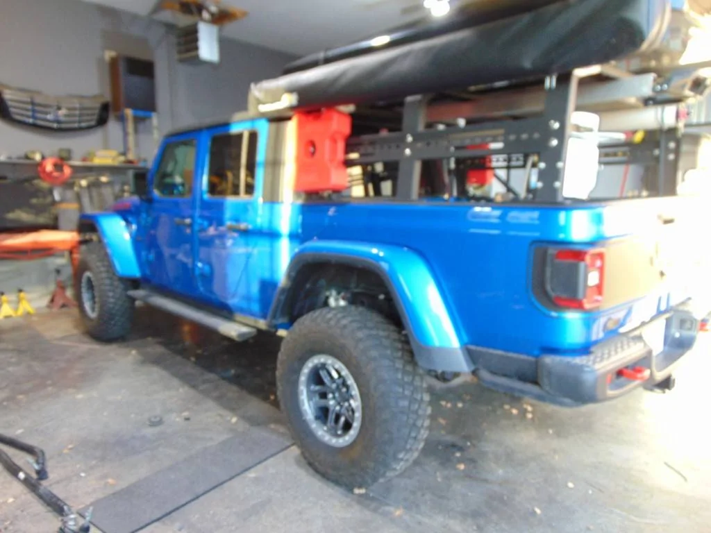

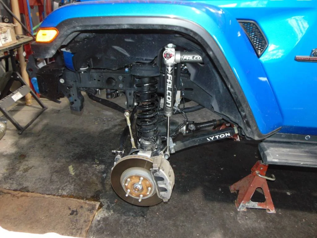

I use the Clayton 3.5" overland springs along with Falcon 3.3's. I have also used the standard rate 3.5" and even the AEV 2.5" springs that came on my JT370.
The 2.5" AEV springs were fine until I started getting more aggressive, which is why I swapped to the 3.5" tall standard springs and the Falcon shocks. I got a bunch more travel, and it worked great. Then I added an RTT and overland stuff. That forced me to swap in the Overland springs, which really work great with the added weight. My JTR has had 37" KM3's since birth.

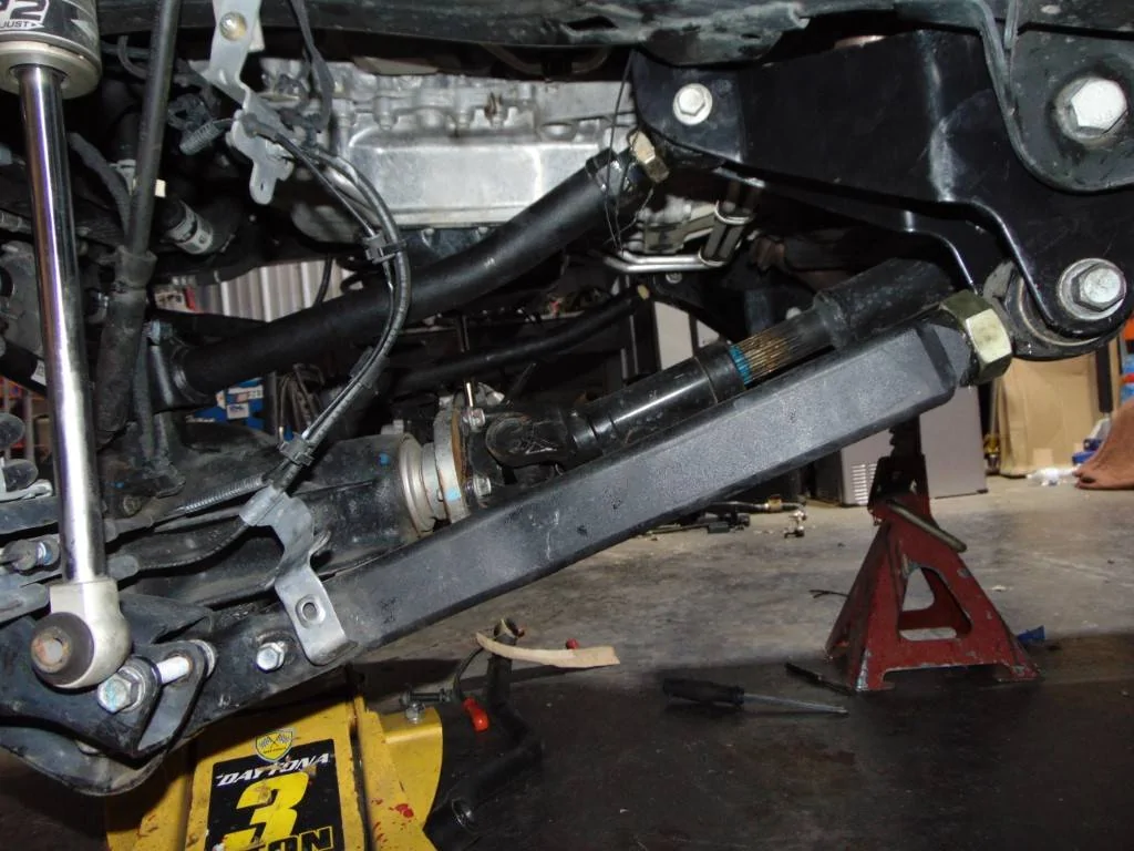

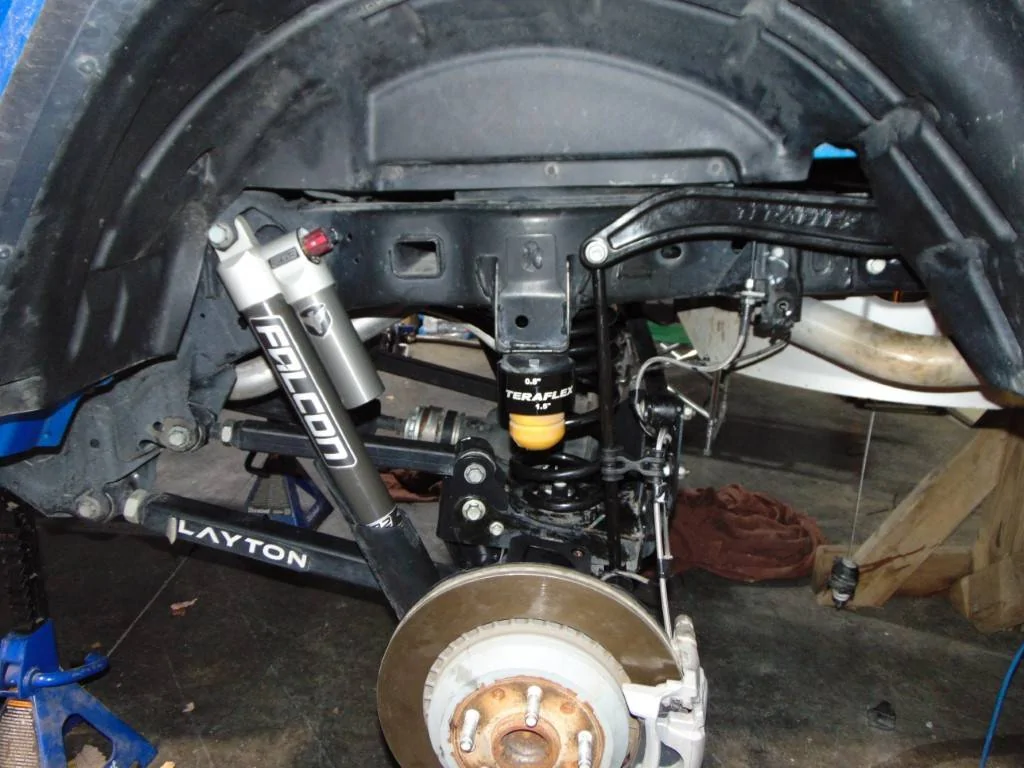

I wheeled that setup in Kentucky, New Mexico, and Colorado. It was in the San Juan Mountains where I noticed the rear axle/drive shaft angle getting pretty bad on big droop-outs. I installed some Terra Flex brackets, which fixed all that. I ran a double cardan front driveshaft from the first 3.5" spring until now.
I then swapped in the Terra Flex rear sway bar and put 5 degrees of caster in the front, and I have a killer setup that carries the weight, navigates the twisty Kentucky back roads, and can drive across the country in comfort.
