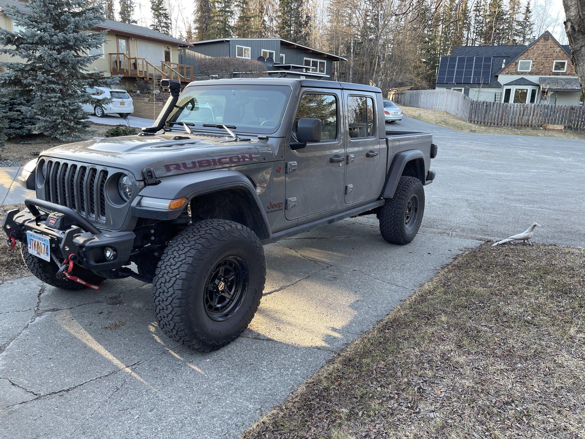

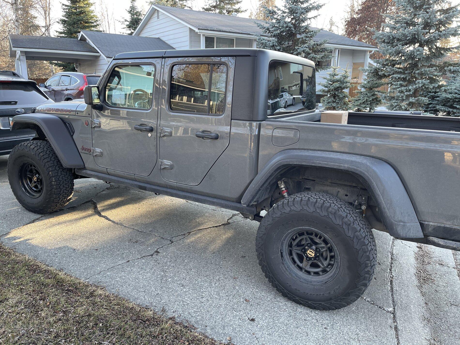

As requested :) here's some before and after pics. The Gladiator is driving at least as good as stock, and I'm loving everything so far including the Falcon SP2 3.3 shocks which - with the rest of the suspension - are yielding a very controlled and firm, yet very comfortable driving experience. Less body roll, less flopping back and forth and neck snapping than a stock Rubicon. I have not had the opportunity to get it off road yet, as I just got the Gladiator back yesterday, but I can report back after more offload experiences in the near furture.
The 2.5 Overland + kit netted me about 2-5/8 lift in the rear, and about 3" lift up front. With the 35" tire upgrade to Toyo Open Country AT3's in 35x11.50R17, that nets me an overall lift of 4-3/8 up front, and 4" in the rear. :) :). I did a before and after pic below.
Honestly, I was hoping for a little more lift up front to help with the rake, but I do have a steel Warn front bumper on, and a Warn winch, and I also added heavy Patriot Rock sliders at the same time, so there is that..... I think after things settle a bit, I'll probably end up putting a 3/4" spacer up front. But I am loving the Clayton package so far! Well done Clayton!!
Oh...I should note, that I ended up deciding to keep the stock rims to keep things tucked in with the thinner 11.5 tires. I will need to wait to see for sure when offload, but it looks like the tires will not rub on the lower control arms with the stock wheels, and 11.50's. It's RIGHT on the edge though. LOL
Jeep Gladiator Clayton 2.5 Overland plus installed today! Pre Lift
Jeep Gladiator Clayton 2.5 Overland plus installed today! Post Lift
