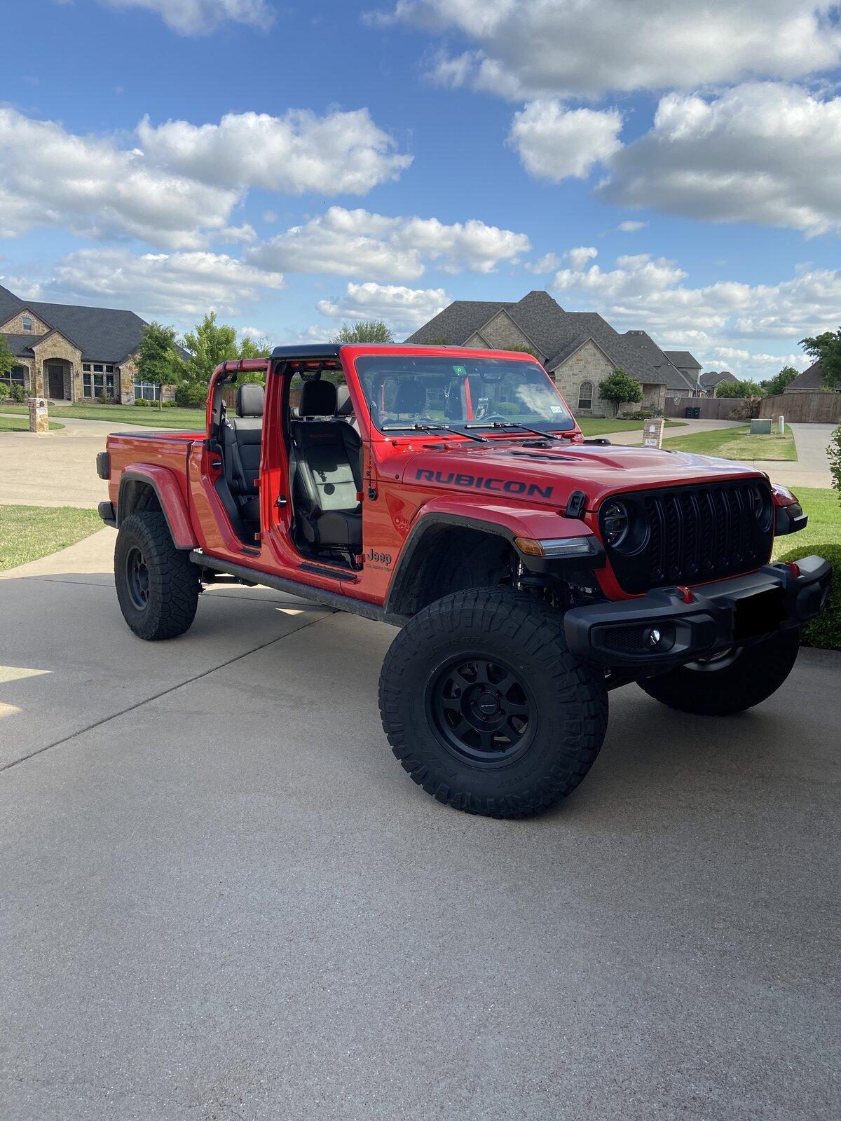

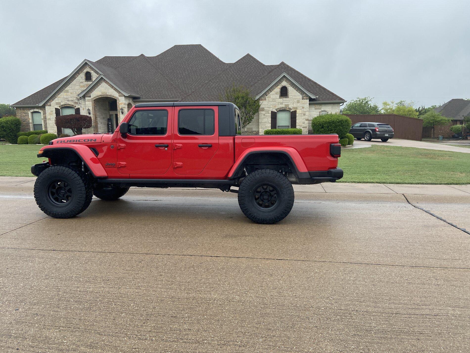

I did the Clayton 3.5" overland plus, steering stabilizer, axle disconnect skid. Love it. I'm stuck between 4.88 and 5.13 gears. The 4.10's now drive pretty well but I need to make my mind up on gears soon. Lots of hwy, not much towing. I'm leaning 4.88 as it's pretty flat around here. Gas is creeping up and I did lose some power with 37's. Added a high flow banks intake to help some. Front drive shaft is on the list at some point as well. Those guys at Clayton were very nice and helpful. Top notch quality, made in USA to boot.
