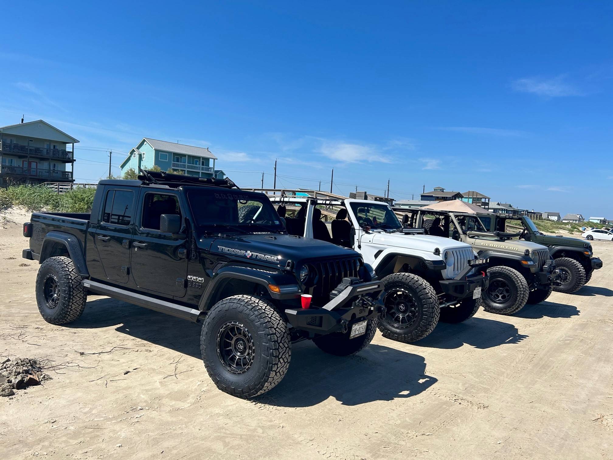

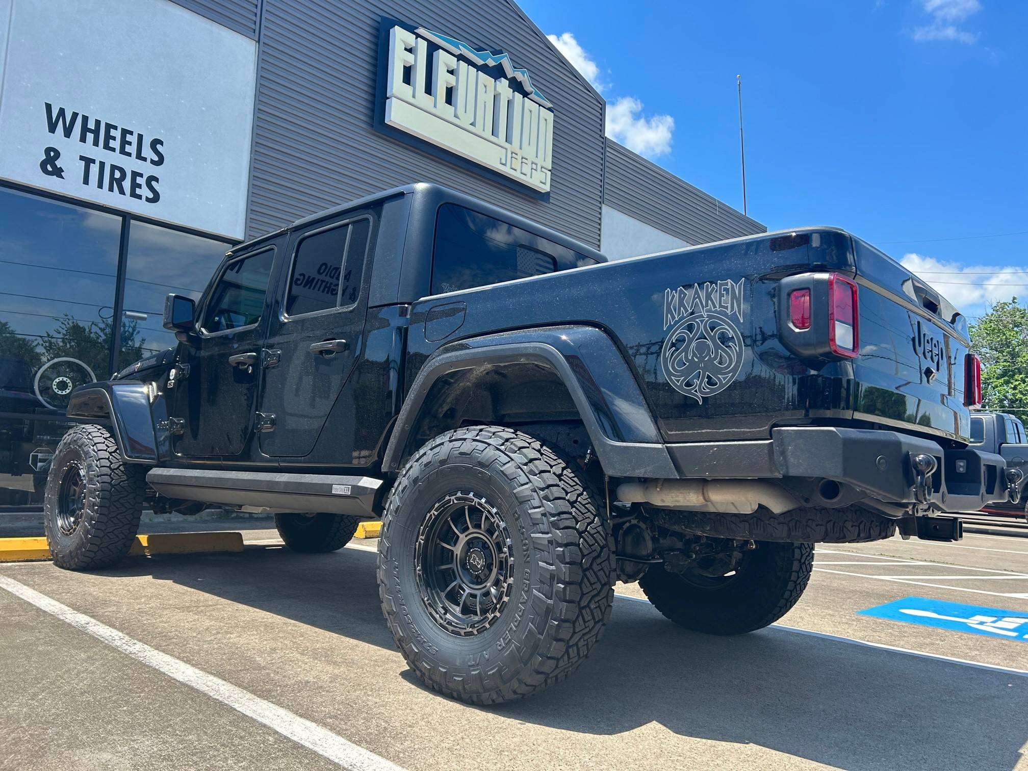

This is a short post with a quick impression. I installed the Clayton 3.5" Overland + lift kit with Fox 2.0s, 37" Nitto Recons and 5:13 gears last week. I came from stock with the 32" KM's, to 2.5" spacer level, and 35's, and now to this.
Lift - Rides slightly more firm than stock but much more plush and absorbs big hits really well, and it feels much more planted and sure footed. I picked up more than 3.5" for sure. I neglected to measure but am thinking more like 4.5"-5". I tow a travel trailer and had air bags with the stock springs to help, but the Clayton ones are a more heavy rate and I am only getting about an inch of squat, so I didn't even air them up last time. The truck does have some rake but once loaded, sits level. I can run 80mph with two fingers on the steering wheel, and I am still running the stock steering stabilizer. So far I am very impressed in every way, and I have owned half a dozen lifted Jeeps.
Tires - I had BFG KO2's in 35s and these are Nitto Recons. Overall I think I like the KO2s slightly more for drivability on the street, but the Recons feel more heavy duty and have been excellent. So far, I am happy with either tire.
Gears - 5.13s - do it, no question, don't even hesitate. It feels like the Jeep picked up 100 horsepower and gets up to speed with much less effort. It glides along in 8th gear on the highway and rarely downshifts. Stock 3.73s and 32s I would get about 17.5 mpg on the trip to see my folks (highway and hill country - 350 miles). 3.73's with 35s and a 2.5" level, I averaged about 14.5 mph on the same trip. On a 60 mile trip with the 5:13s, lift and 37's, I was about 16.5 mpg.

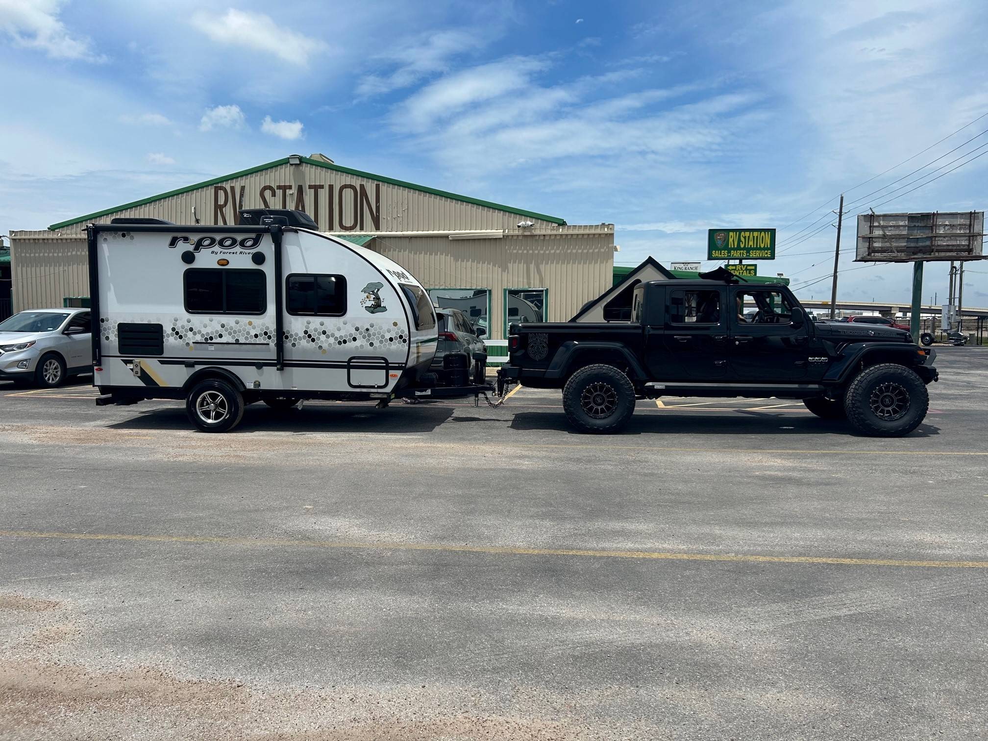

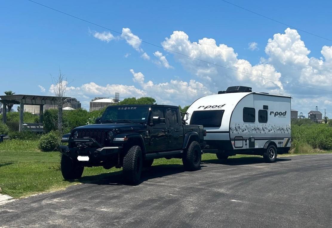

I got a chance to tow the "Pod" and I reiterate how much I like this setup. I easily got up to 70mph and it just flies down the interstate. The tongue weight should be about 400lbs and it squats maybe 1" with no weight distribution hitch. Those rear springs are serious. The Pod weighs about 3.5k lbs loaded.

This weekend will be a little test. I will be towing the pod loaded with at least 400lbs of gear in the bed (generator, fuel, firewood, tools, etc).

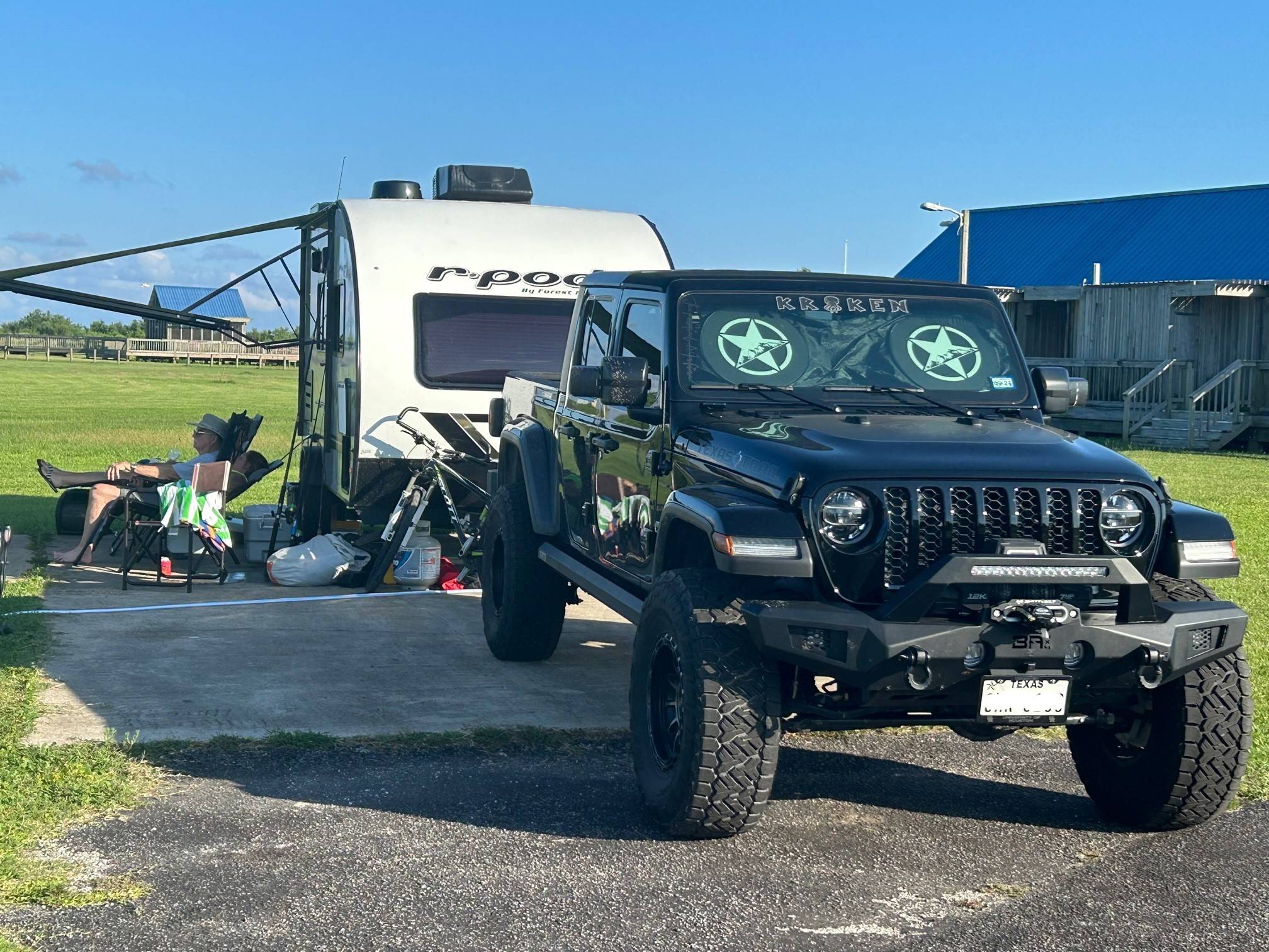

It occurred to me I had not done an update after two trips towing the Rpod and loaded down. These were not wheeling trips, more just camping. In installed 235 mud tires on the trailer as well.
With the bed loaded with 10 gallons of fuel, a 90lb generator, about 150lbs of fire wood, chairs, canopy and propane and whatever gear fit, the Gladiator sat pretty much level with the trailer attached and that is with no weight distribution hitch or anti-sway. Empty, the kit has rake for sure, loaded up it sat level and performed great, well the suspension did. I could set the cruse control at 65mph towing with ease and even some rough small roads were not an issue at all.
So far I am nothing but impressed with this kit.
