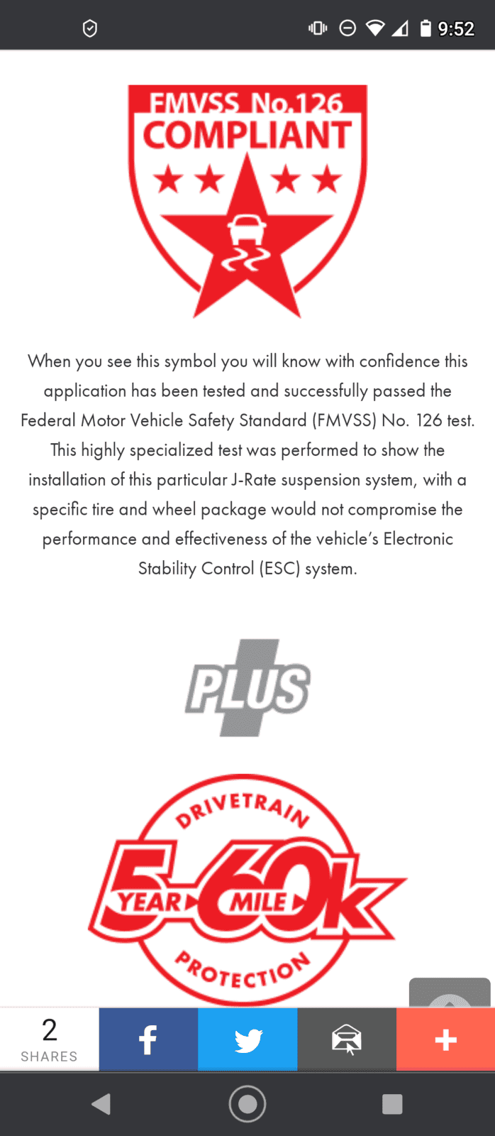

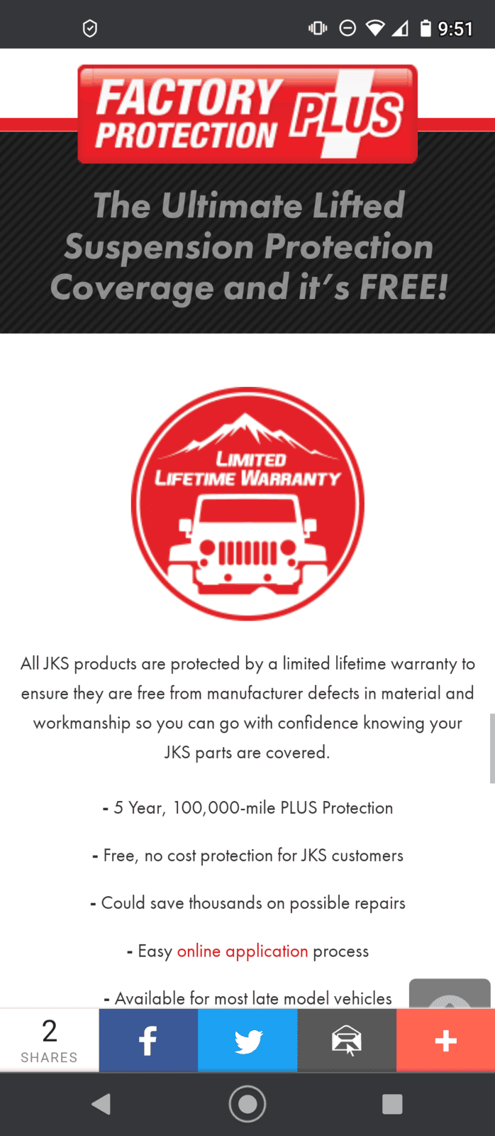

I've been debating on the same thing. But more so between Clayton and JKS love the JKS warranty and the certificate for Federal motor vehicle safety standards. I'm not sure if they have a diesel specific lift yet.

Ummm. Not affiliated with any manufacturer. Actually just put my order in the other day on my JT Sport S Ecodiesel. Not spamming just my two cents. Sorry if I offended you. I'm just learning all I can about what I'm able to do with my new JT when it comes in. Isn't that what a forum is about? Being able to bounce ideas and learn?

I had put screen shots from their website showing the warranty and FVMSS. This is the reason they may have looked like "ads" they were not. Just putting up what I thought was important. Precisely why I'm waffling on what lift to go with. I don't see anything like that on the Clayton website. Again my apologies.
