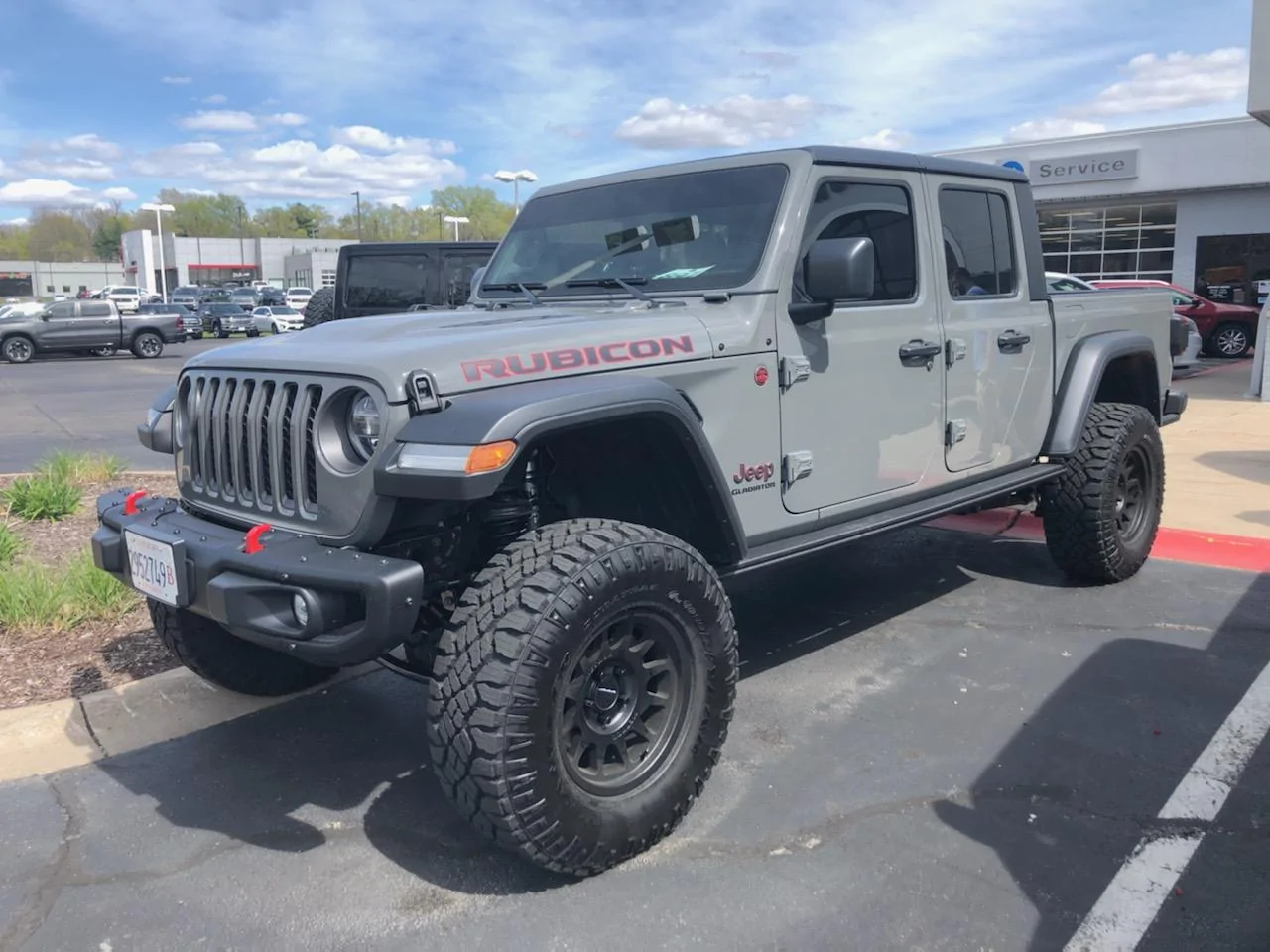

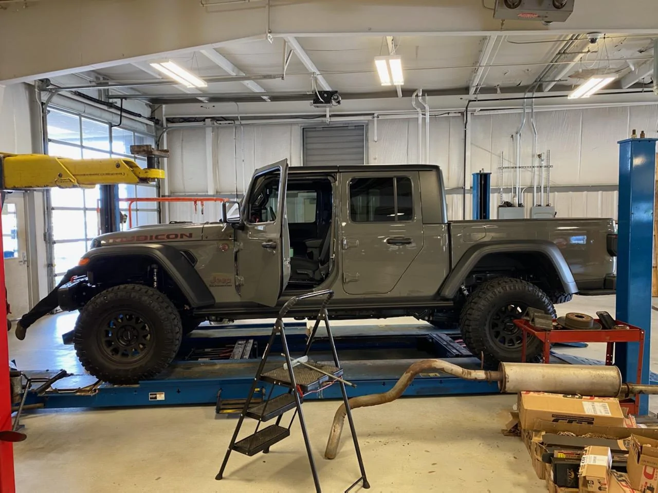

Got a Clayton 2.5" Overland PLUS kit AND new Fox shocks for a 2021 JTR DIESEL and having some front end on-road ride quality problems that we (Clayton Off-road/my installer) are having a hard time identifying. For starters-- here's what I've got, 3.5" springs up front, 2.5" in rear and all running on 2-3 inch Fox Shocks...
Working with Clayton and Adam-- I've taken a lot of measurements. Shock pistons on front are at 6.5" of stretch. Upper control arm measurements are solid. Not sure what else to do. Alignment caster/camber numbers are within range but every time either front tire hits pothole or medium to large bump the front end of the Jeep reacts in an unsettled, side-to-side not solid feeling... I don't know how to explain it any different than that.
Not my first Jeep or lift-- this is number 5...
PREFERENCE ON INFO SPECIFICALLY FROM DIESEL OWNERS WITH CLAYTON LIFTS...
