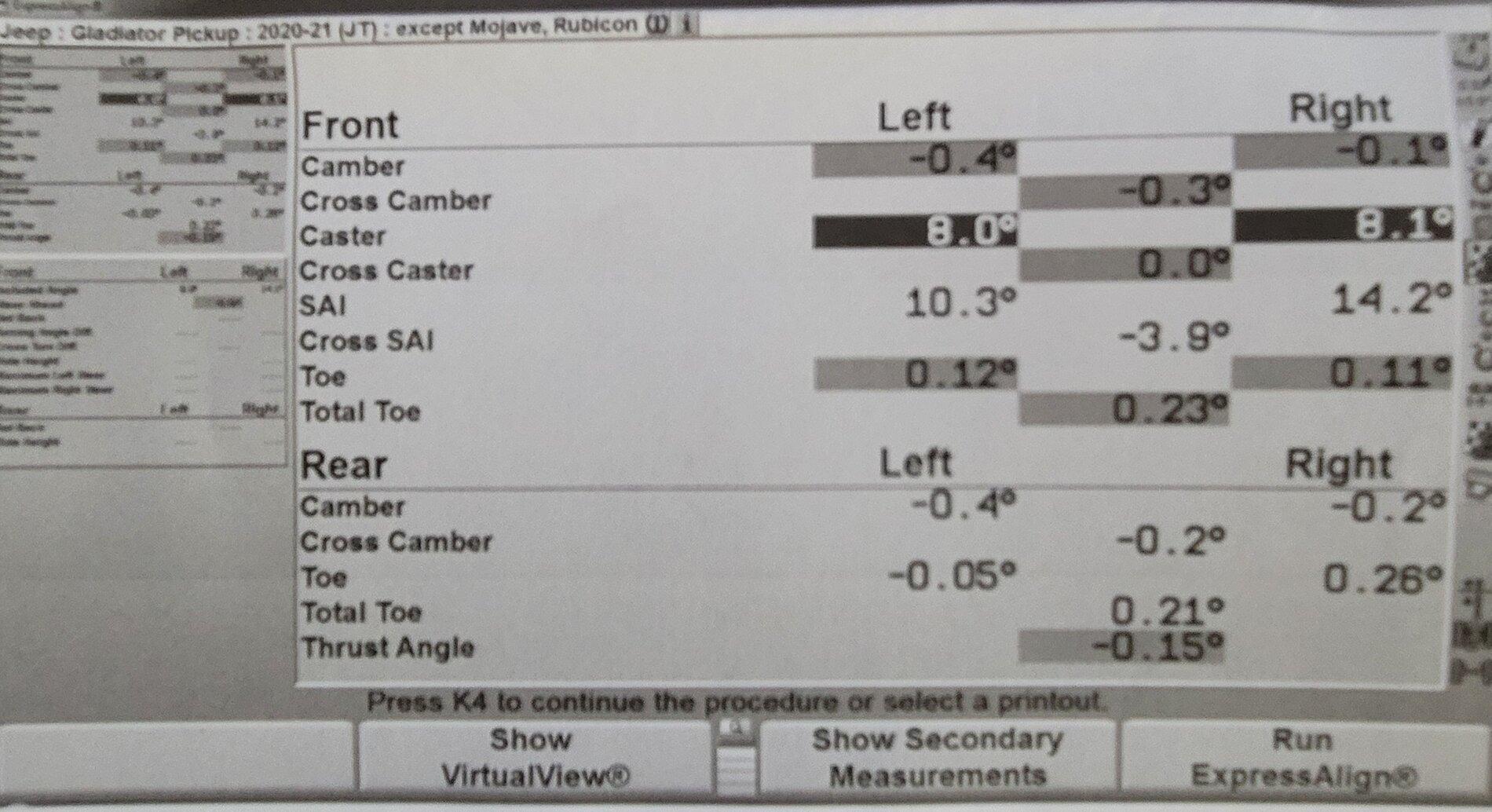

Agree with other posts here. Also, could you post your alignment numbers? Also control arm numbers? Would be helpful in diagnosis.

You said the alignment numbers are "within range", but what do you mean by that exactly? Could you post your numbers?

Alignment specs look ok - though I think I'd run higher caster. I had good luck with my other JLs with a caster closer to 6-6.5.

just got my alignment done today, here is my number.. My drives straight..
