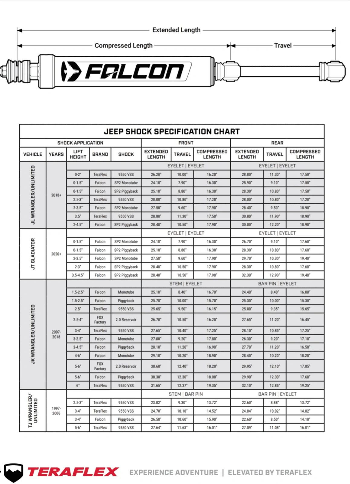

so I have an idea. I’m about to order the Clayton 2.5 inch lift for 1500$. I’m thinking about pairing that with the MC rocksport shocks. My reasoning is that they offer more droop than the fox 2.0 or any other shock in that price range. So more articulation. I don’t see an issue other than I will need to replace front driveshaft.
what are your thoughts on this? I would also need to add rear brake line extensions.

Just make sure to look at the spring specs or ask Clayton to make sure the droop isn't too much. Don't want springs to come unseated.

yeah, what he said... Also, for the rear, Teraflex makes coil clamps for the JT... but, I do not think they are available for the front. To help you out, here are the Falcon Shock specs so you can compare...
