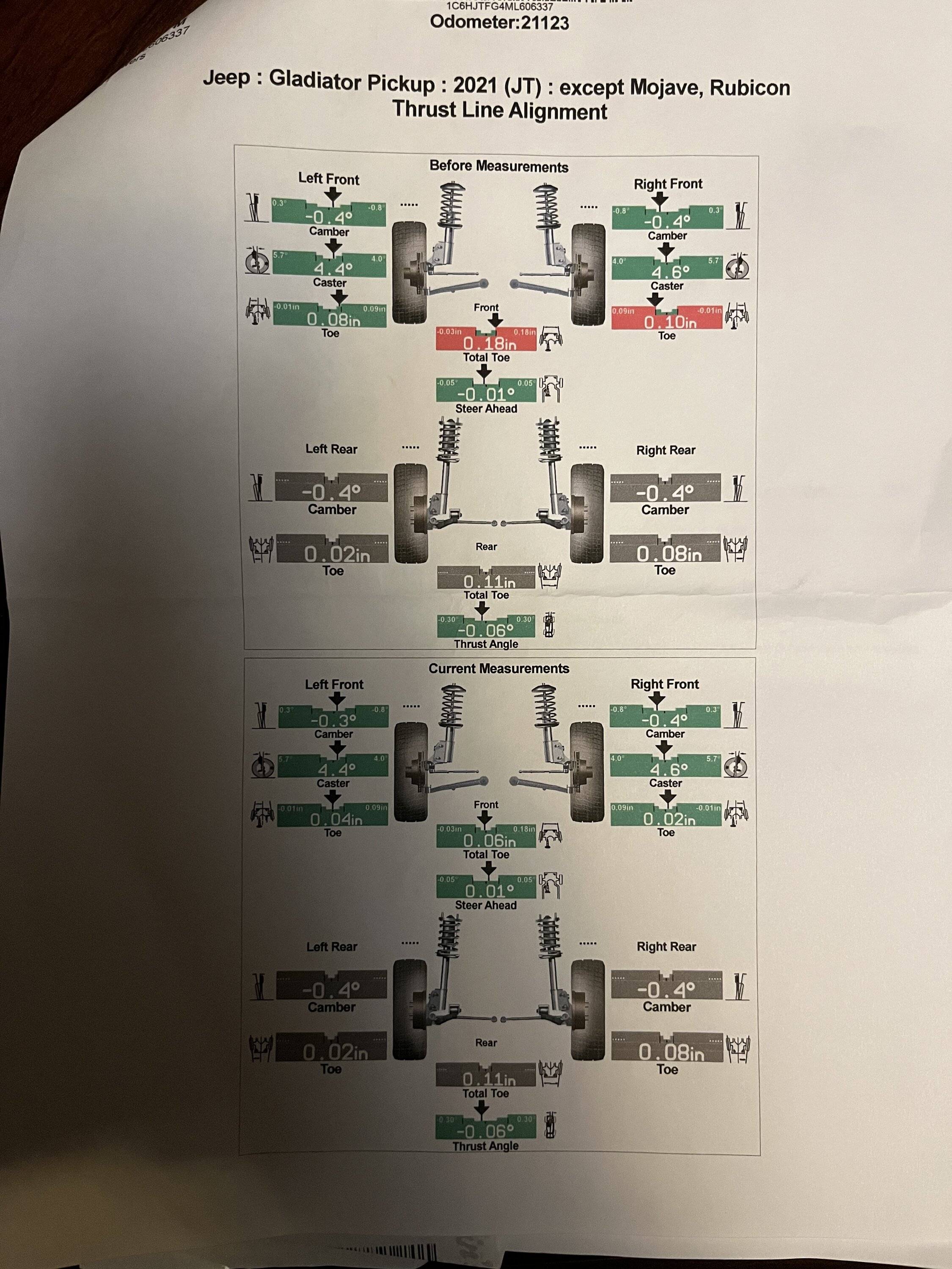

Today I had it aligned at Firestone (got the lifetime unlimited package). They said numbers weren’t too far out, and the tech apparently owns lots of Jeeps. Within 10 miles at highway speed and around a long corner with a bump I experienced the death wobble. It happened a couple more times at lower speeds as I limped it back to Firestone where they told me my front driver spring was installed incorrectly.
Just seems weird that it drove fine and as soon as I got the alignment this issue popped up?
I had literally the same exact thing. 20k miles, zero issues. The following day and maybe 20 miles after the alignment hit a bump and “holy sh..balls wobble” I’ve had a RC 2.5 level kit on mine the entire time. Pulled a little right and figured I’d get it adjusted. Only the toe adjusted. Attached my before and after too. Changed stabilizer to Fox through shaft, still happening. Makes me wonder if it could have simply been that??
