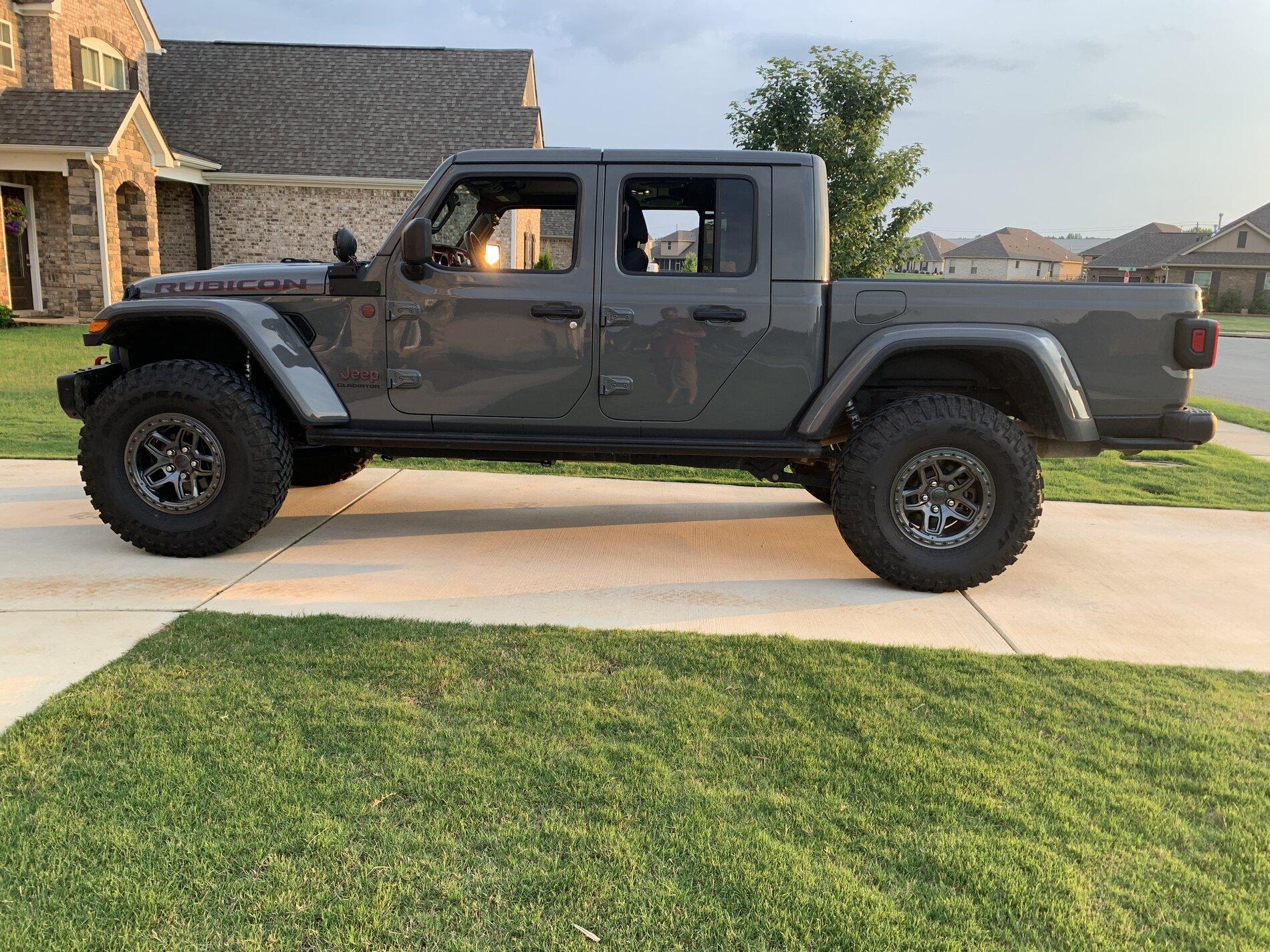

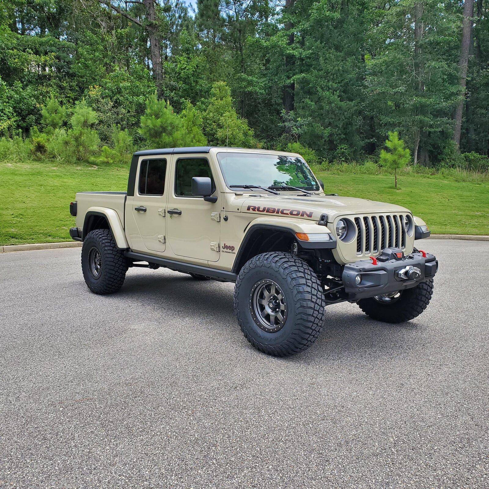

No issues at all. I decided on the 3/4 to offset the weight of the winch and winch support plates in the bumper. I think it offsets it nicely without needing more. Hence it put the lift back where it should be after adding the winch stuff. I did also buy the 1.5" and decided not to use for exactly what you are asking.
Also to the OP, remember that Usethis83 has a Rubi and most people that have them only use a 3/4" in the front to level while the rest of us use a 1.5" mainly due to the higher fenders on the front of the Rubi.
Even though you didn't ask me but I am using what you opened the thread asking, I haven't had any alignment issues with mine after I took it to a specialty shop to unscrew what the dealer did.
I did use the daystar shock extensions mainly because they were already on the jeep for I was running a daystar 1.5" on the front and a .75 in the back "leveling kit" prior to adding the Mopar lift. When I added the Mopar lift I added a daystar adjustable trackball, the rancho geometry brackets, and I removed the .75 rear pucks.
At the time of adding the lift supply and demand was horrible and you couldn't hardly find adjustable trackbars and geometry brackets so I went with what I could and so far no regrets. Other than using the Dealer to install, but at the end they were fair and the compensated for me having to go to a specialty shop to readjust practically the whole suspension.
@Usethis83, very nice set up indeed and great color!!!!

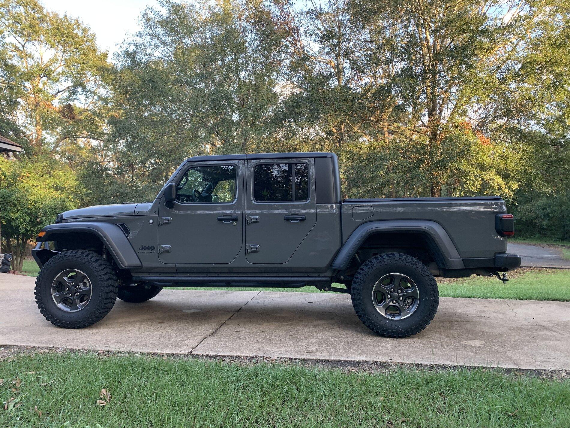

I did a mopar and 3/4" daystar
Hey bud, fellow Alabamian here (also @jhataway ) ! Are you a gasser or diesel ? I think the diesel mopar lift is a little different than the gasser. I have the diesel and HAVE NOT installed my winch/winch plate yet and already have a rake. I need to install them to see if or how much sag I get. Most of the big boys that sale the leveling kits are telling me they are not compatible with the mopar lift, due to the design, Theystate it causes extreme bowing of the springs and make the JTRD ride really rough. Have you heard this ? or have you had any issues or any suggestions

Hey man, sorry for the delayed reply, I don't get on here too much anymore. I had a 3.6 in that gobi gladiator. So, I cant really say on the diesel. The mopar lift did come with spring correction pads and with my 3/4 spacer (which was negligible due to winch) the springs sat correctly.
