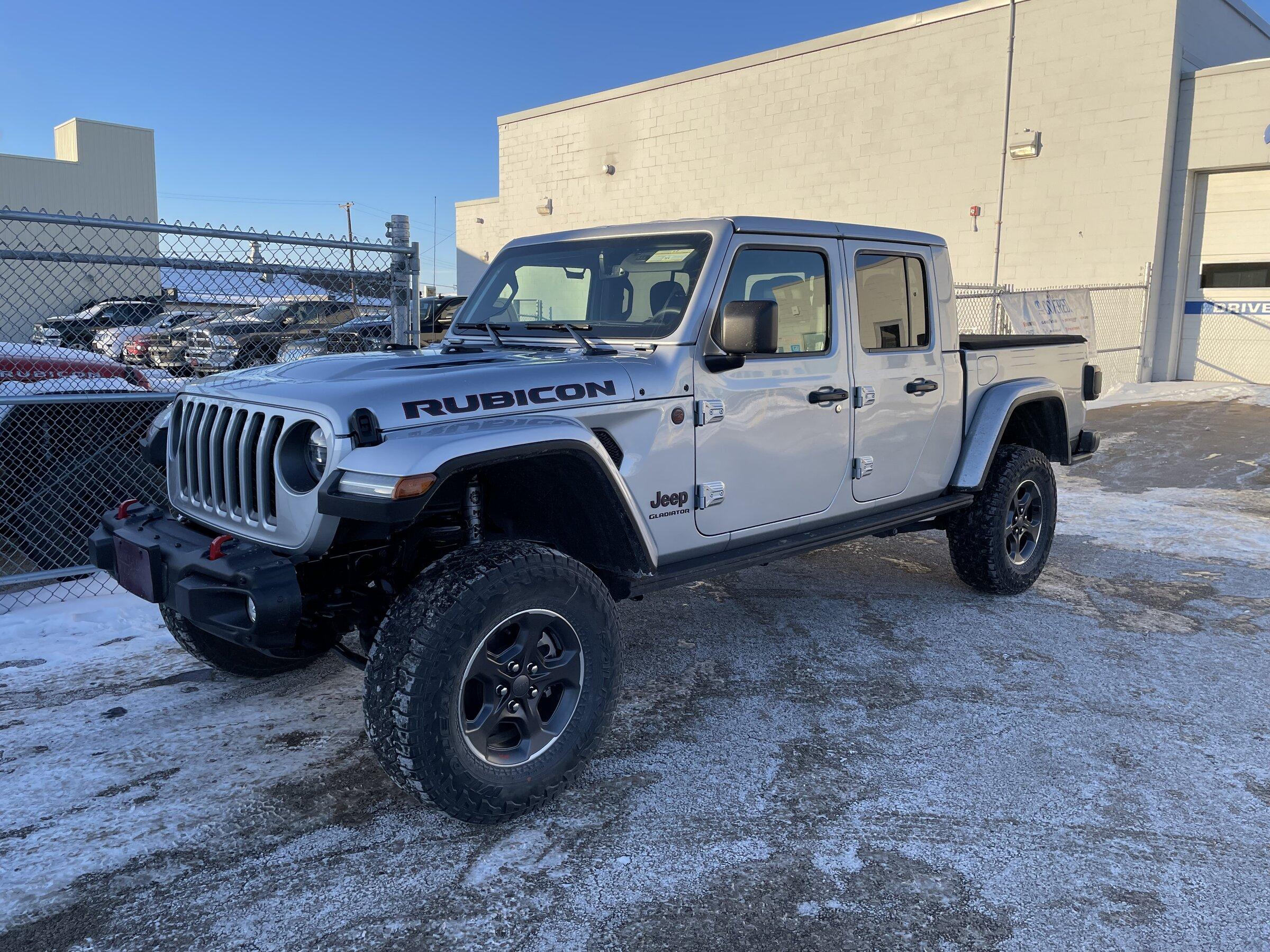

Just picked up the JTRD with the Mopar Lift & front 1.5" Teraflex spacer installed, the alignment specs show 4.12 degrees caster and I'm amazed on how well it drives with no steering issues on city or highway roads and still has the stock steering stabilizer. I was going to put the Fox racing series stabilizer on tomorrow, but I'm going to wait and see how it performs on a windy day then install it, on windy days my JL wondered with the Fox stabilizer so much that you had to strong arm it and I was waiting to be pulled over for a suspected DUI. The JT definitely sits higher than my JL did and I haven't put my 35's on yet, but I heard that the tpms sensors are not compatible with the JL setup I have on my beadlocks.
I had JTR take-off wheels (same as in this pic) with TPMS on my 2018 JLU Sahara and they worked fine. Are you moving your headlocks with TPMS that were on your JL to your JTR? Should work. Did I read that correctly?
EDIT: no telling on a 22MY.
Someone on youtube took his wheels off his JL and put on his JT and no readings showed up so I checked to see what sensors were used on the JL & JT and found online sensors that were specific for builds after 6/5/21 so I assumed my JL beadlocks wouldn't work. I wanted to run them on my JT until I made up my mind what tires I wanted to go with, I'm tired of KO2's as I can start my own gravel pit with the rocks I pick out of them daily and also looking at 37's, I didn't want a lift on this JT as I wanted to tow and my Wife did, so if she wants a LIFT she's going to get one.
