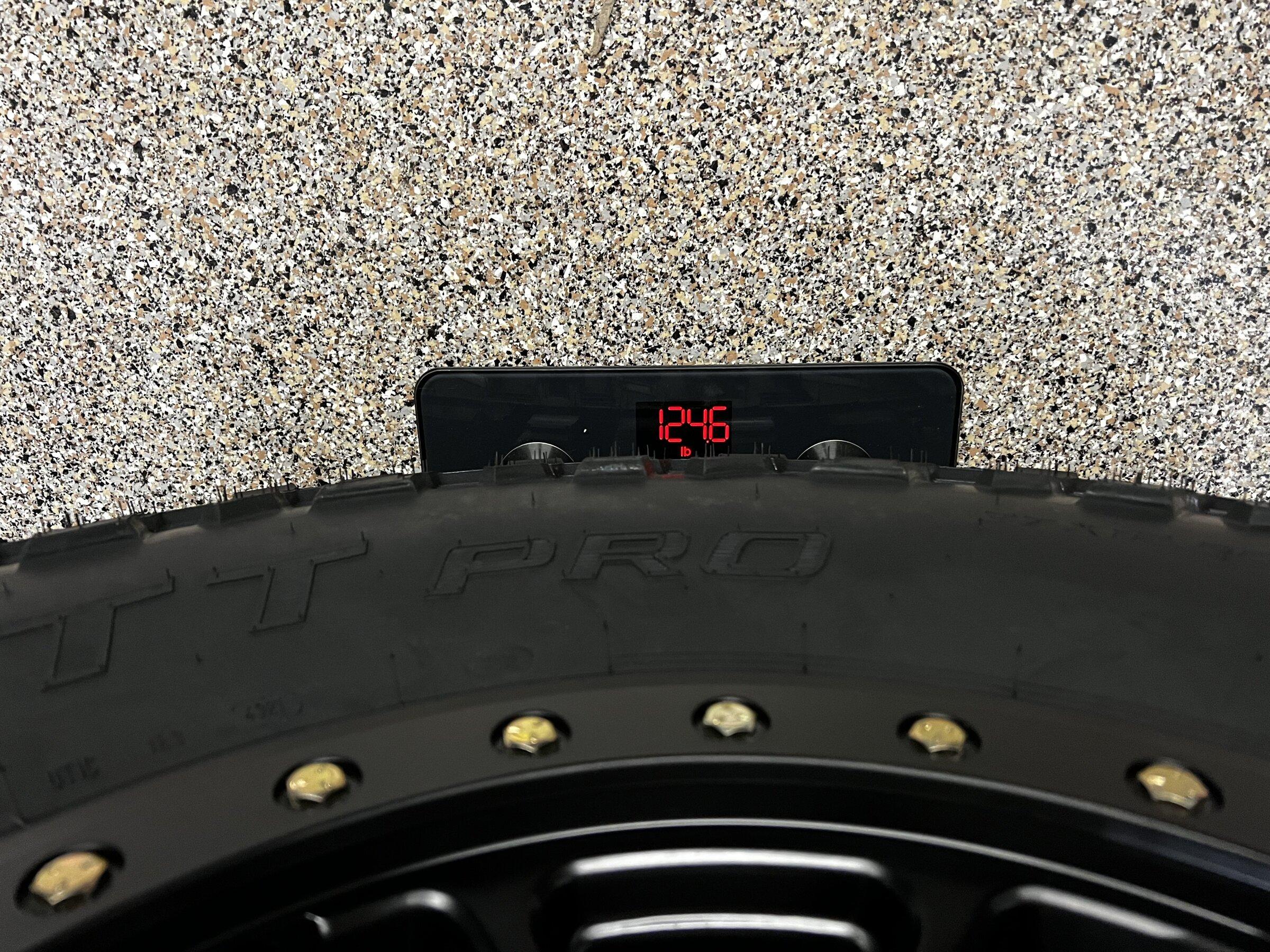

This is me right now. 124 lbs of tire and wheel at each corner and the stocker doesn’t really cut it. Just waiting for it to come in from back order.
Wow 124lb. What tires and rims?
Yeah it's kinda caught me off guard hitting a dip while turning ahaha
37" (12.5" wide) Cooper SST Pro with Dirty Life DT-1 wheels. The tire is about 83-84 pounds by itself.
Jeep Gladiator mopar 2in lift IMG_6669

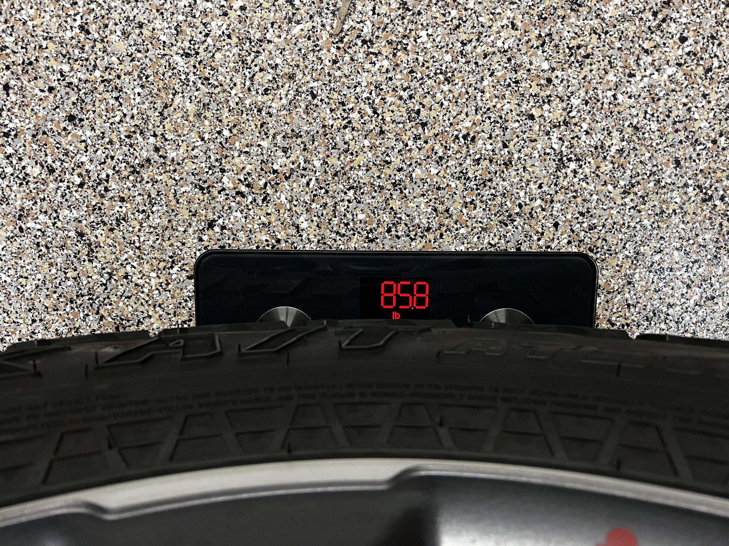

Stock Rubicon Wheel and Falken AT tires were 86 lbs:
Jeep Gladiator mopar 2in lift IMG_6668
