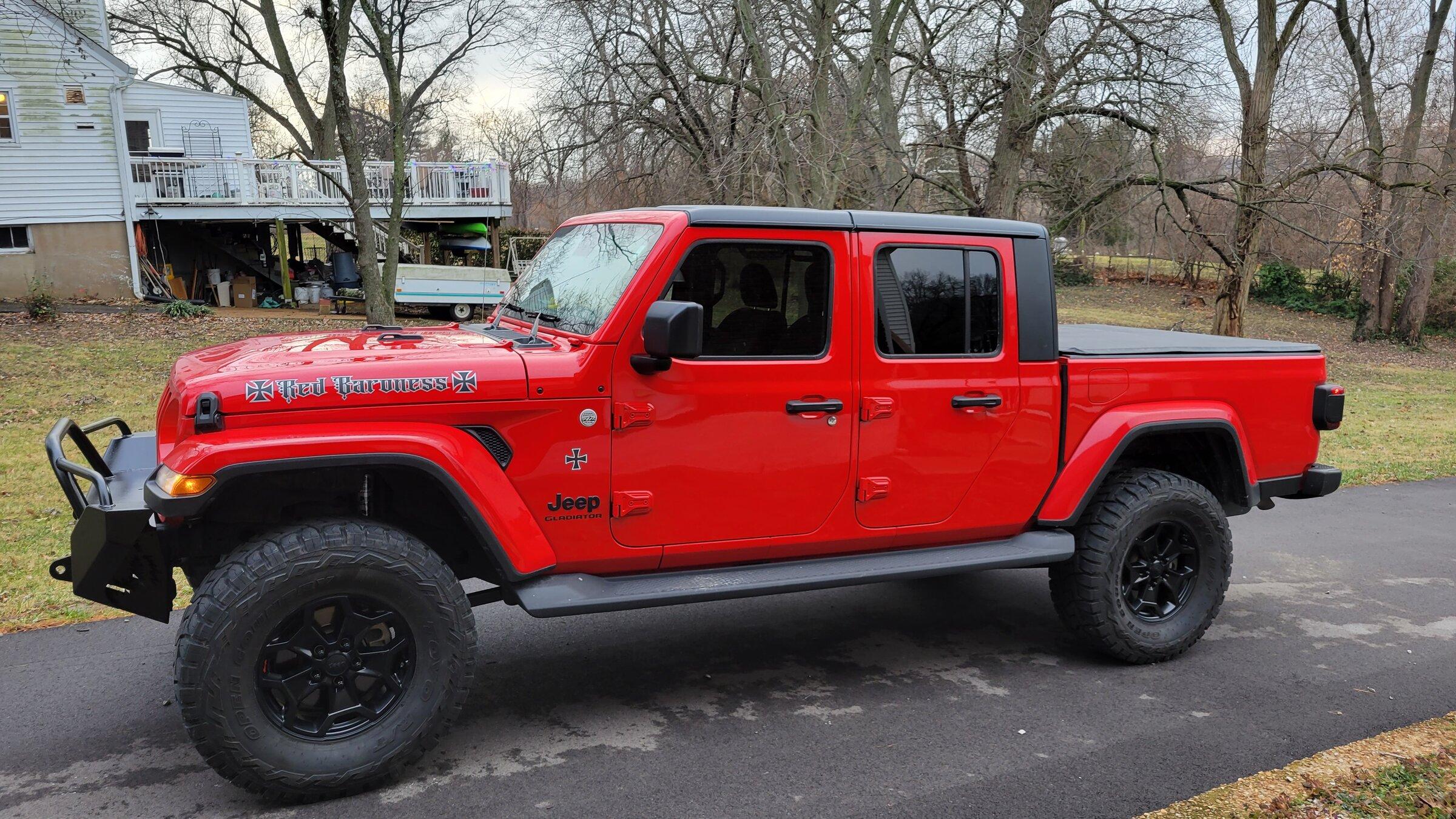

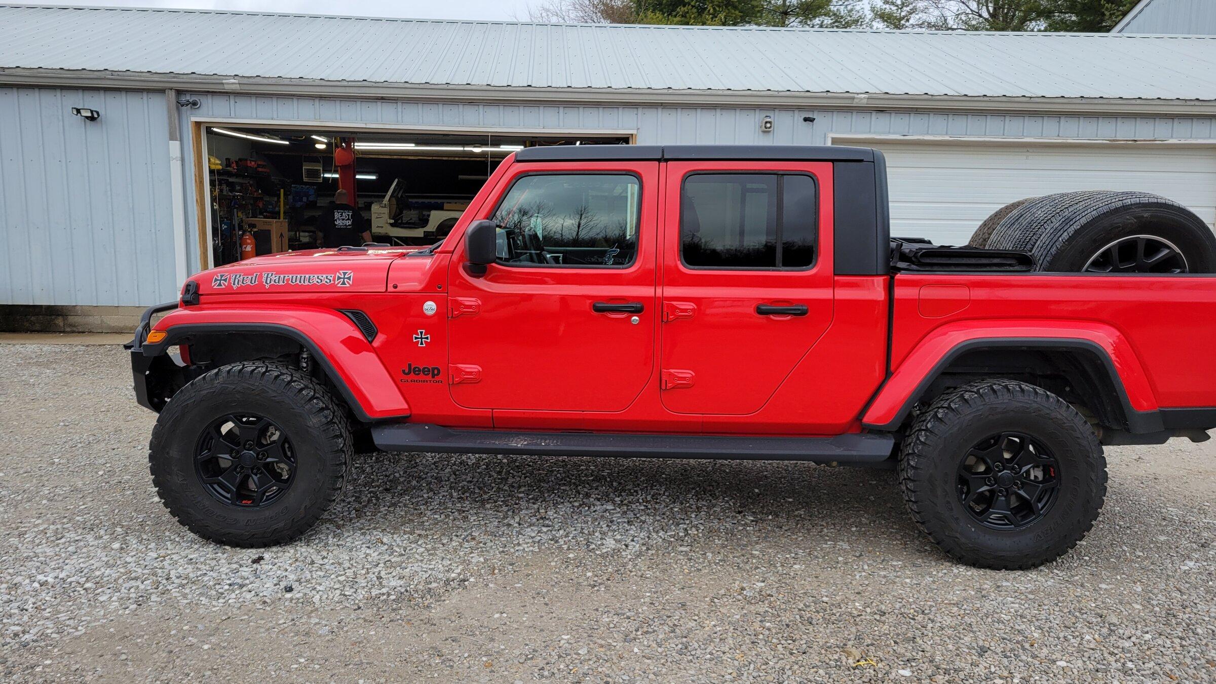

Not disputing anyone's claims on either side of this debate. Just wanted to add that after installing my MOPAR kit + Teraflex levelers in front I have zero issues with wobble (It's the AC part number, not AB). I also installed a Yeti XD adjustable track bar after a couple weeks and no issues there, either.
On the other hand, my 2008 JK has death wobble with a non-MOPAR kit. I took it back to the factory front springs and it went away. Added 2.5" spacers to the front, and it came back. I think it's the angle of the factory track bar after adding the height and it's not able to "push back" enough against the side-to-side motion of the axle. I've seen some track-bar relocation kits that are not necessarily designed to correct the side-to-side measurement, but restore the track bar angle for this exact reason...
