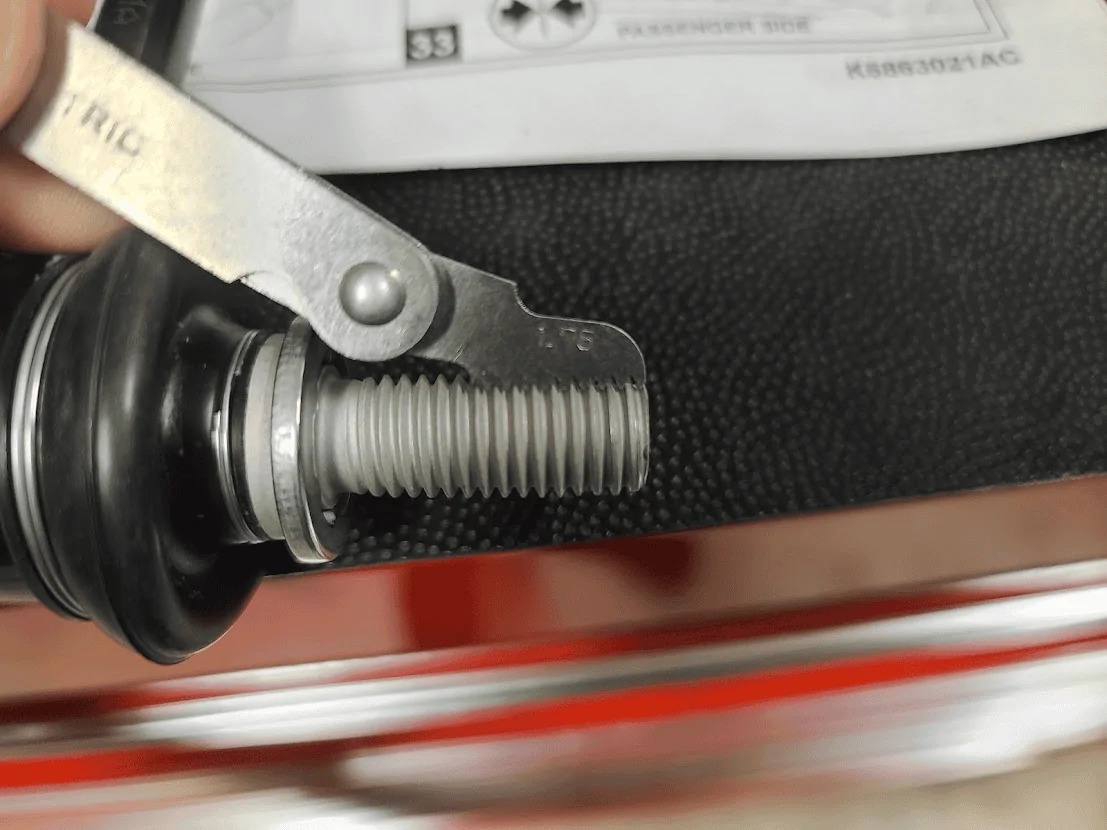

For anyone that recently installed the MOPAR 2" lift: did you have issues with the front sway bar links in the kit? When installing them, I was having a difficult time getting the nut to tighten, so before I stripped anything I checked the nut with the rear sway bar links and it fit perfectly. I compared the 2 (front vs rear) and it looked like the thread pitch was different, so I got out my pitch gauge.
First pic is the factory front link, which is M12x1.5 (which is also the same on almost every nut/bolt on this vehicle):

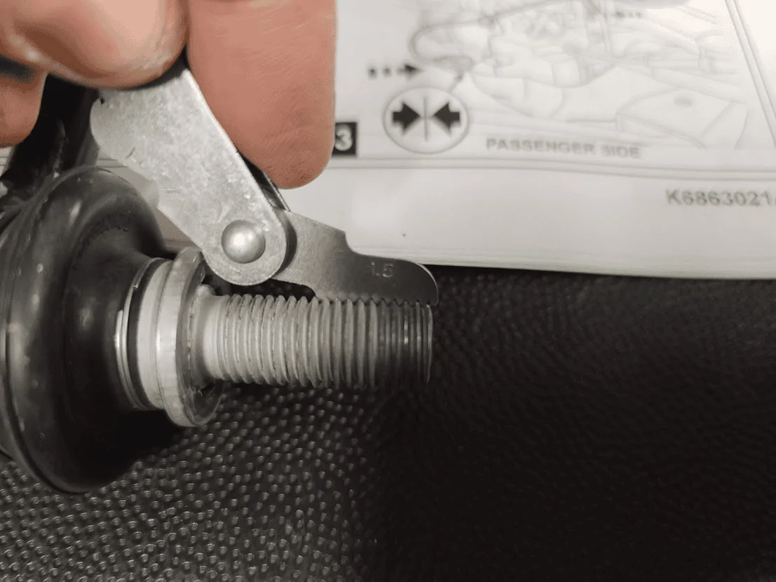

Second pic is the new front links from the MOPAR kit:
Jeep Gladiator mopar 2in lift 1640619711342
I was able to find M12x1.75 nuts at the hardware store, but this has me scratching my head. Did MOPAR put the wrong bolts on these (maybe supply chain issues, quality control issues... both)?
Anyone else experience this?

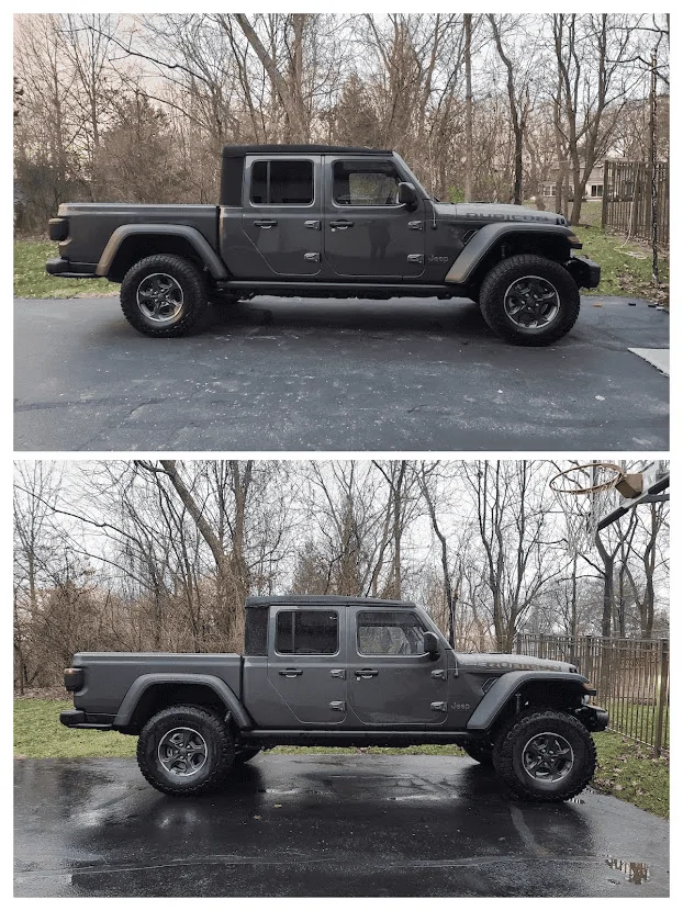

Oh, and here's a before/after of mine. The "before" is the stock suspension (Rubi) and 33" Falken tires. The "After" is 37" BFG KO2's and the MOPAR kit + Teraflex 1.5" front spacer kit. All in, I got 4" of lift in the rear and 5" up front. My rock rails measure about 22 1/2" from the ground now:

What's the kit part number?
Installed mine 3 weeks ago and it has the correct thread.
Kit was 77072468AC
Front sway bar links included were 68306981AA
I had the same problem a couple of weeks ago with the Mopar lift kit p/n 77072468AC. I used Mopar p/n 6512602AA, 12mm x 1.75 nuts on the front sway bar link.
Ok, so it's not an isolated incident... Where did you buy yours? Mine was on Amazon, from a seller called "Wholesale Direct Parts"
I purchased the lift from our local Jeep dealer with a 15% off (max $200) coupon. I picked up the replacement 12mm x 1.75 nuts from them also.

Wish I would have paid attention to you guys on getting the correct threaded nuts ahead of time. Once I installed the end links it was apparent right away. At the end of the install had to run to the hardware store and picked up the correct nuts. Put some red loctite when fastening the new ones down. Only other not fun part of the install was using a ratchet strap to pull the LCA's to the frame to line up the bolt holes.
