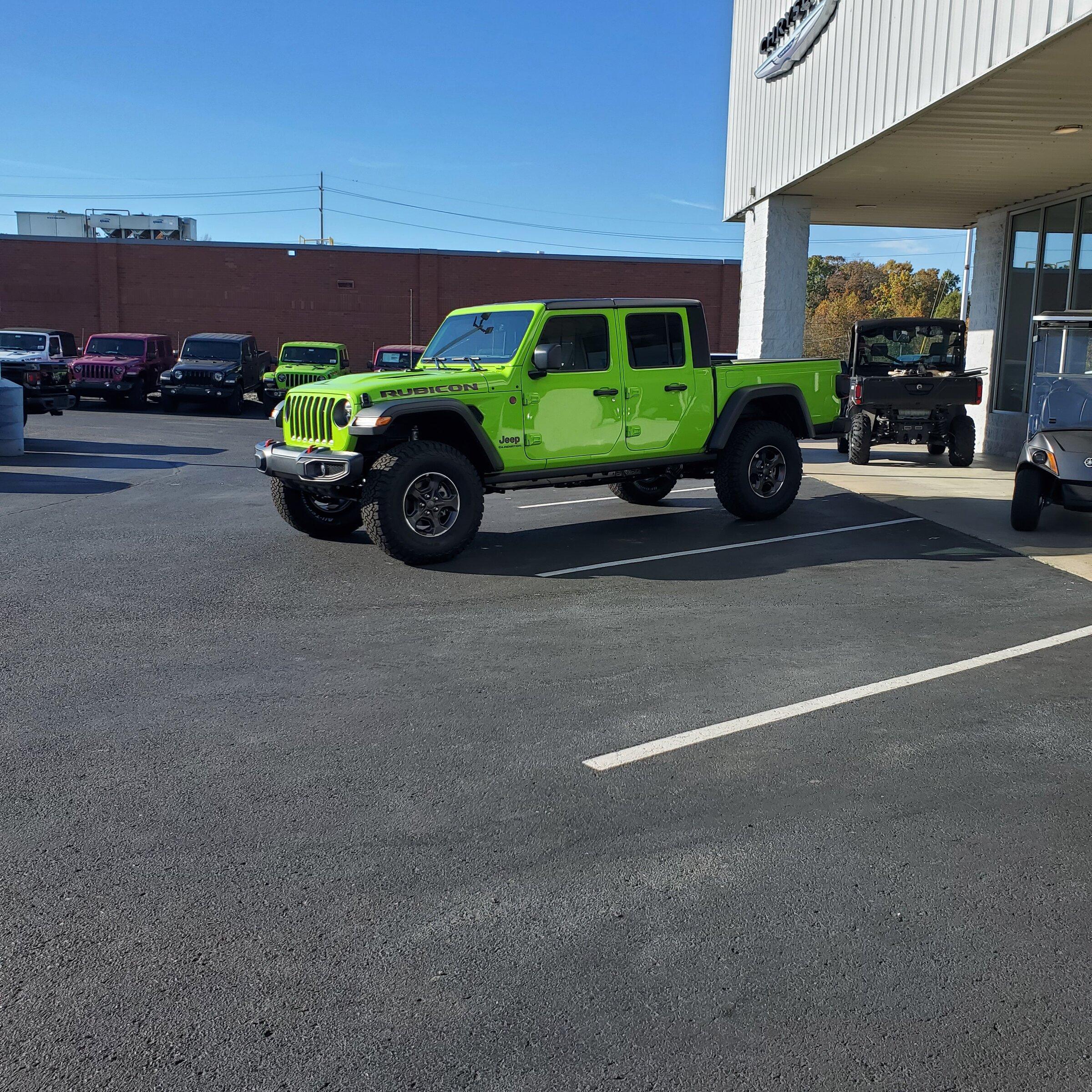

So far Im getting a price of $1495 for the kit (directly from Gupton) waiting on the installation quote. I will report back when I get it.
it was about 600 for install when i had them do mine
Jeep Gladiator mopar 2in lift 20211119_153746
Jeep Gladiator mopar 2in lift 20211109_084919

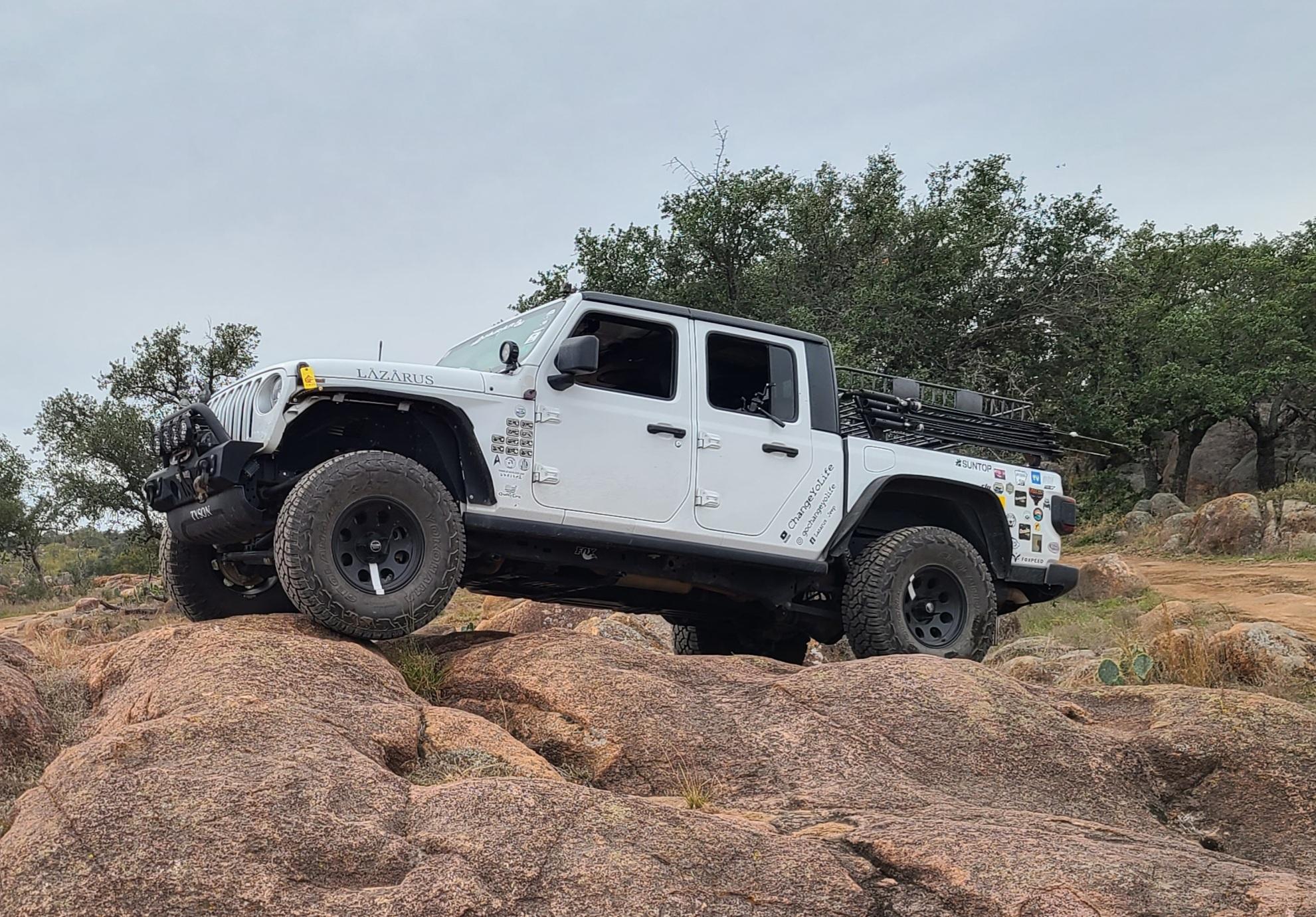

I have the Mopar 2" with 3/4" Daystar spacer up front. Been on this lift for 100,000 miles. The only thing that I've added is a falcon thru shaft adjustable stabilizer because I damaged mine on a trail. I tow, haul, and offroad. Very pleased with it.
If you want to see everything that I've done on this lift over the past 2.5 years and 100,000 miles, check out my youtube. It's taken some abuse. Lol
https://youtube.com/c/ChangeYoLife
newbie question: what is the significance of the white tape on your wheels ?

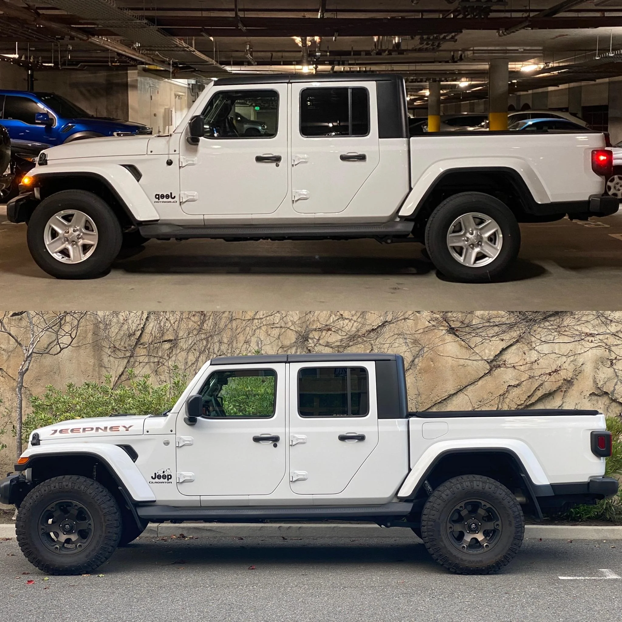

I installed it on my Rubi Diesel. Would highly recommend it. Be sure to get the steering stabilizer also. It’s not part of the kit. Smoothed out the ride overall. With the diesel I did not get the truck to fully level out so to speak. And yes I did get the kit specifically for diesels.
Did you add spacers to level it out ? Got any pics of how it was with just the lift ?

Purchased from Quadratec ($1600) and installed by a local Mom & Pops tire shop ($900)
I'm very satisfied with mine.
How do we see the same profile of your jeep, but your emblem is backwards in the "stock" photo? You're magic!! lol
