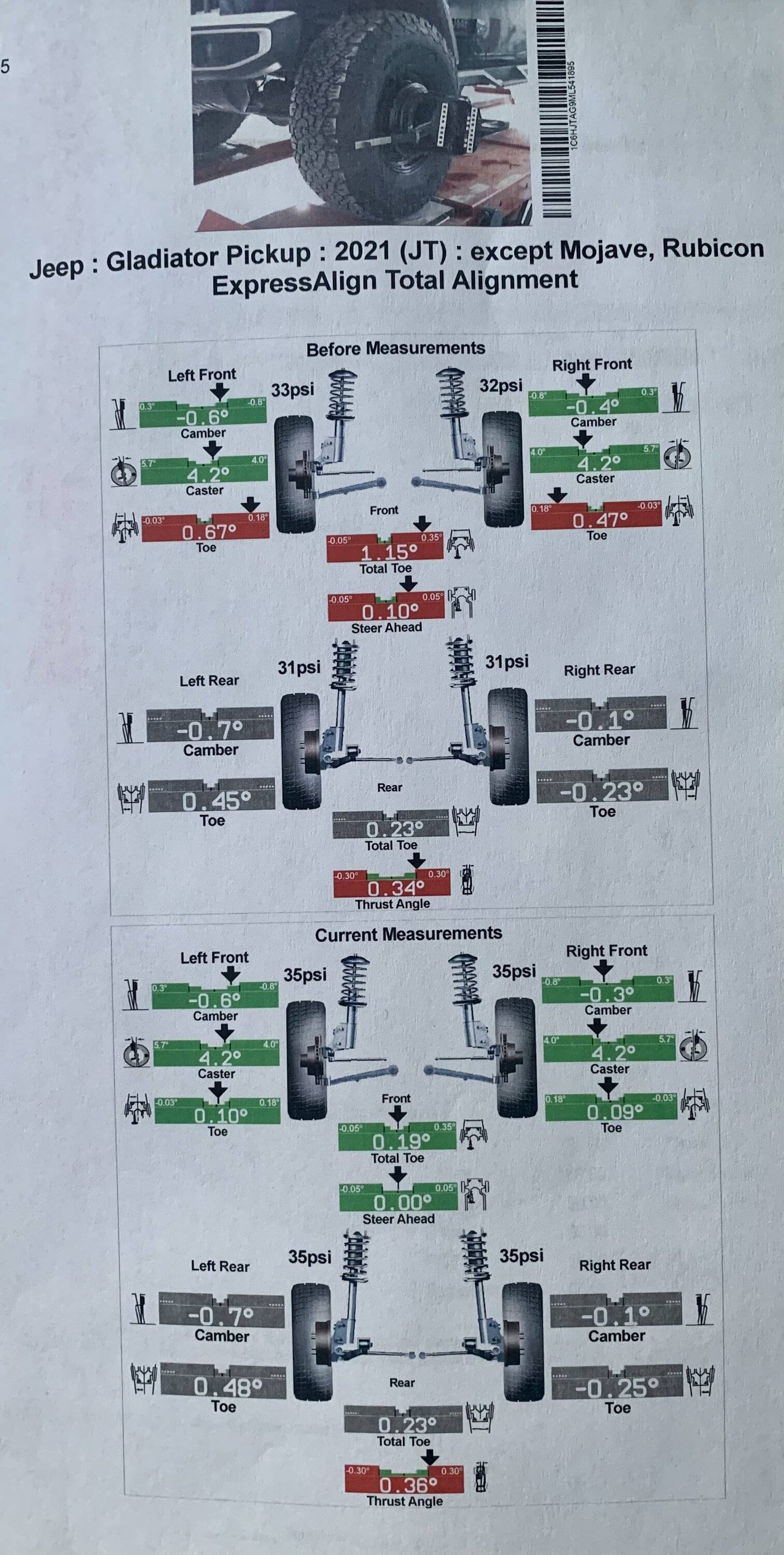

Had tires rebalanced and toe adjusted. I’ll put some miles on it tonight and see if DW is still an issue.
You need that caster closer to 6. Adjustable control arms if you have them or geometry correction brackets, which will also improve the impact angles and get them back into the suspension vertically and out of the frame.

From what I’ve read from Lift manufactures, and other people having it done your caster angle seems low. If I’m not mistaken, I think the targets around 6°.
Additionally, your pre-alignment measurement of 1 inch is way out of spec. It should’ve been somewhere around an eighth of an inch. Also, take into consideration and less you bought it outside of the Mopar kit. You’re missing the front and rear track bar. Most important would be the front.
