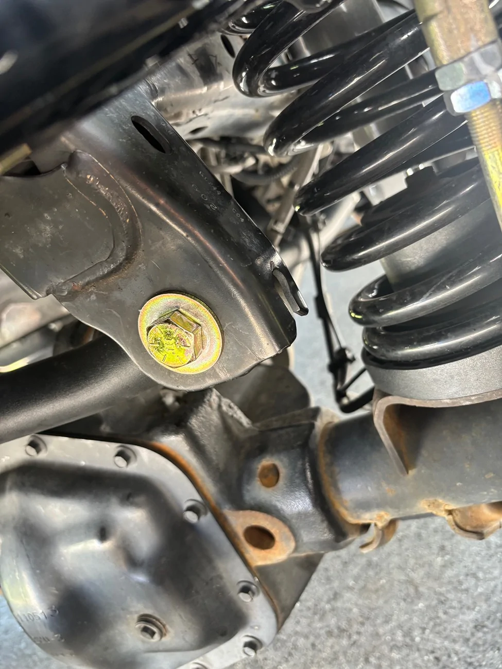

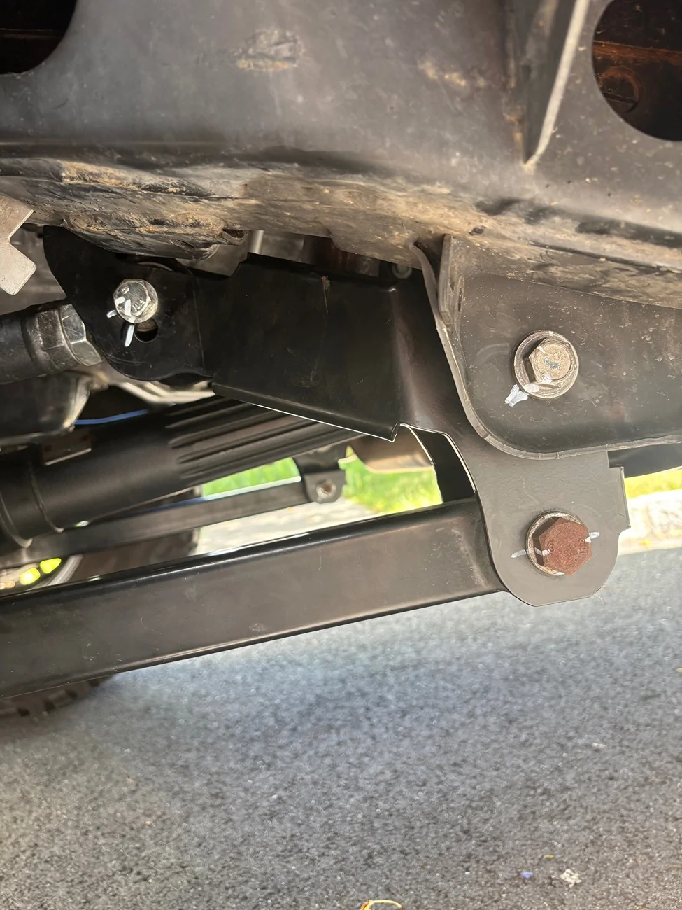

MAJOR UPDATE
*Did not install mopar extended control arms*
Installed front geometry brackets that I had laying around and shortened the Clayton uppers. My caster may be too much. Phone app level put it around 7.5-8. May have to extend the uppers alittle and get a proper caster reading.
I checked nearly every nut and bolt at this point and everything seems good.
At this time the brackets made all the difference in the world. Steering is much tighter, nearly no bump steer. Could not reciprocate DW on the highway, (couldn’t find a big enough bump so far). But wow huge win today and gave me some hope.
Current mods:
Clayton Off-road 2.5 ride right+ lift kit
Teraflex front lower spring isolators (prevent spring bow)
Falcon shocks and stabilizer
Whiteline swaybars f/r
Fifteen52 17x9 0 offset
Bfg k02 37x12.5 36 psi
Here’s been my added mods and fixes to get to this point:
Standard grade 8 track bar bolts, washers, locknuts, loctite - 9/16 x 3.5 18 thread.
Numerous alignment adjustments resulting in Clayton off-road upper control arms measuring about 19 3/4”.
Front geometry correction brackets. HUGE difference.
I do believe I still need a proper road force balance. The tires seem a bit bumpy, I don’t see uneven wear. No shaking in the steering wheel though.
