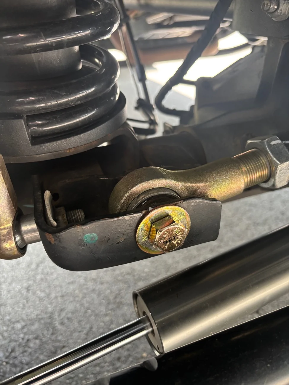

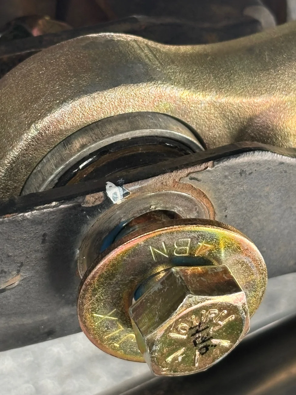

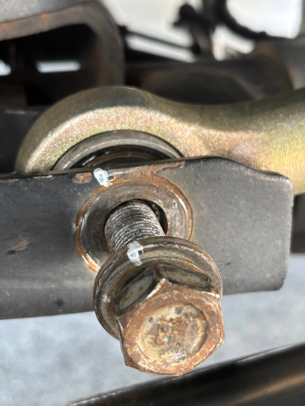

Todya I found the front lower control arm rear bolt not torqued to spec. Lower drag link bolt also not torqued to spec. Took care of those and then replace the trackbar lower bolt with a standard size bolt to fill the hole more. Nothing has changed driving wise. Will try highway shortly and I plan on adjusting my upper
Control arms for appropriate caster

Another update. Highway drive was successful. The catch is this was at Clayton’s recommended 20 1/4inch length on the upper control arms. After the successful drive I figured I’d adjust the arms to 19 3/4inch as the shop set it for proper caster and BAM, low speed wobble (haven’t gone fast for DW) is back in full effect.
Very lost for thoughts. Gonna try to call Clayton tomorrow and see if anyone can give a good explanation. Saturday I’ll put the arms back to 20 1/4inch.

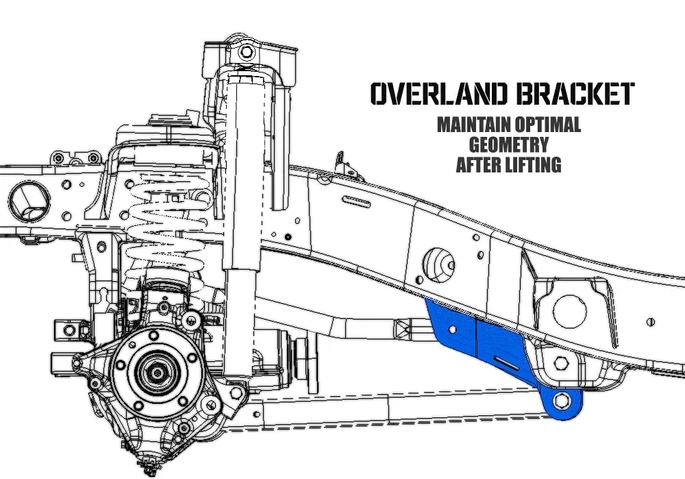

Strange. A shorter upper arm is more caster. More caster doesn't normally make it less stable, it makes it more stable.
Wouldnt a shorter upper be less caster?
JT1
Nov 13, 2020
745
722
Oklahoma
2021 Gladiator Willys
No, a shorter upper arm rotates the pinion (facing the transfer case) toward the ground. This increased positive caster.
No, a shorter upper arm rotates the axle back, adding caster. A shorter lower arm would reduce caster.
If you have a longer lower arm it adds caster, but the same basic effect can be had by a shorter upper arm. The upper and lower arms work opposite when it comes to adding or reducing caster. A shorter upper arm adds caster, same as a longer lower arm.
Ignore the labeling, but the drawing is perfect to visualize
Thanks. I was trying to visualize this in my head earlier, but now that this photo was posted I can't even visualize what I was incorrectly visualizing earlier.
It's friday, it's morning...
