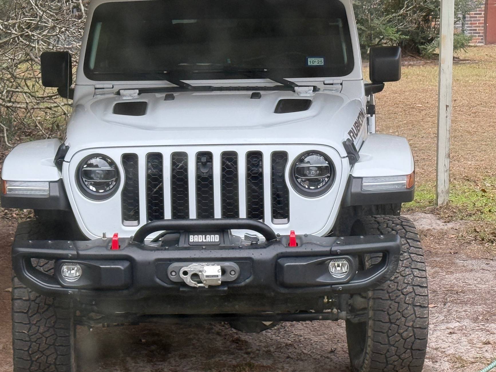

(2021 diesel)OK before making my own post figured id just jump in here got the wonderful DW after installing 2.5 clayton ride right diesel specific lift +.75 front spacer to level out for winch and bumper. This lift only has upper control arms i have them shortened all the way and am getting i believe 5 positive caster caster checked on flat spots front of diff with digital angle finder reading 91-90.9 i cannot adjust the arms shorter to get to 90 which i understand to be 6 degrees positive caster. (thinking about buying adjustable lower arms or the Mopar lift arms)
things i have checked: broke all control arms/track bar bolts loose and retorqued lowers to 190ft lbs uppers 80ft lbs track bar upgraded to grade 8 9/16 bolts and torqued to 130ft lbs.
Falcon 2.1 shocks set to firm 37 bfg all terrains that where on the jeep before lift and no problems.
Things I'm going to check steering box bolts and pitman arm nut.
Any tips from here to get this under control jeep has 14k miles on it btw

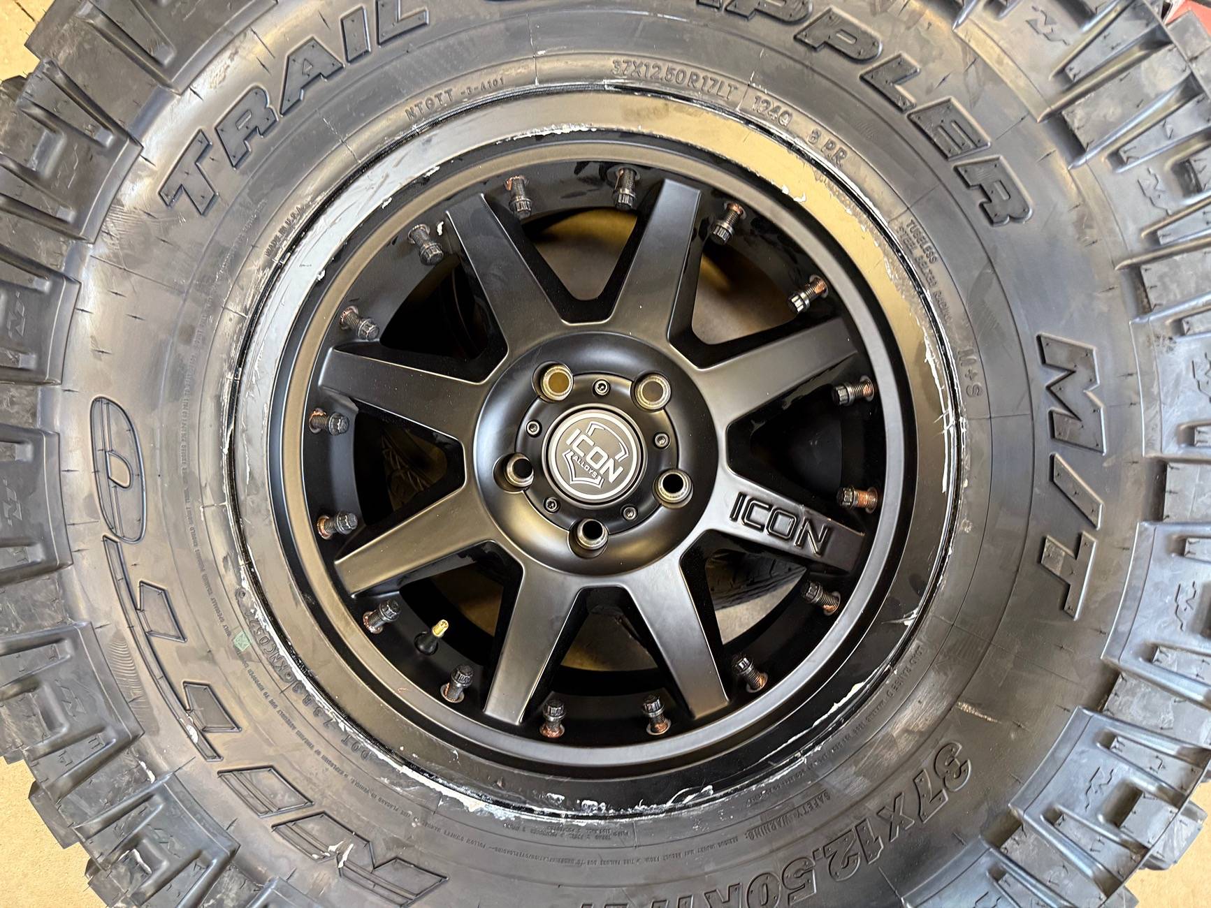

I have the Diesel overland 2.5 kit. No wheel spacers on -6mm offset wheels. Rides like it’s on rails & solid. Fox shocks…not harsh or too bouncy.
By any chance are they the Icon Rebound Pros? Stock steering? I have the same exact lift.

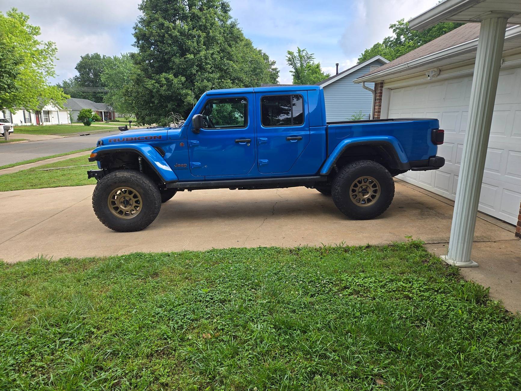

I've got same exact setup except I run the Rubicon take off tires.
You on stock steering still?

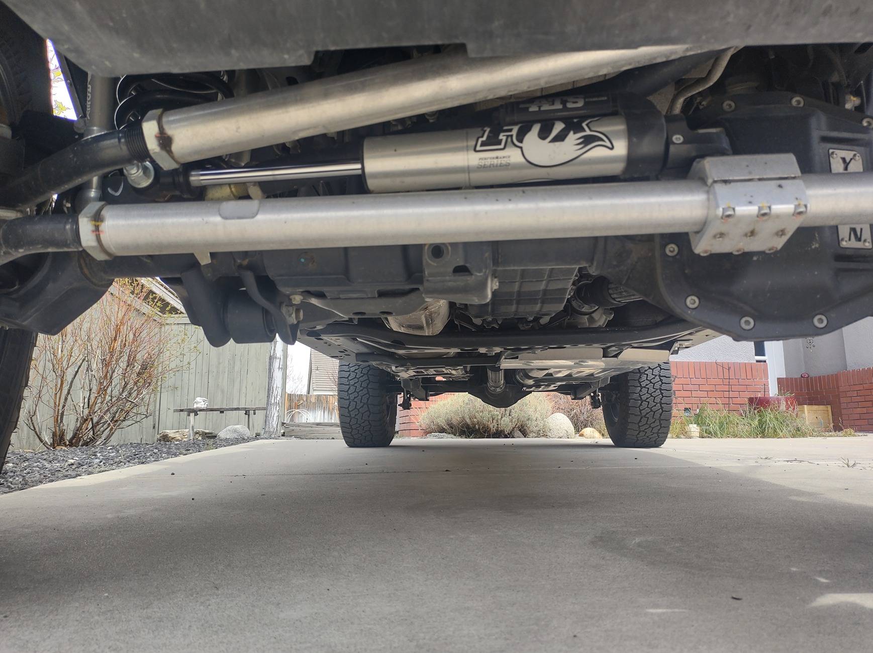

Yes to the stock steering except for the Clayton adjustable track bar that came with a kit. When I go to change the steering, I’m gonna take a look at Clayton‘s stirring stabilizer bracket so I can get it above the axle tub or above the bottom of the axle tape however high it goes.
A buddy of mine just got the steer smarts steering components for his JL, but they’ve been sitting in a shop for about a month because there’s just too much other stuff to do right now, but I’m anxious to see them. I haven’t decided on which direction I’m gonna go with that yet.

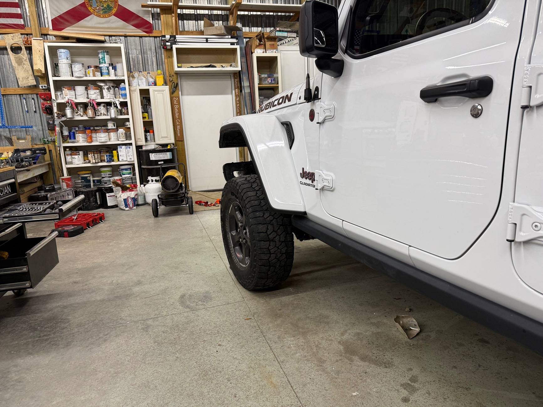

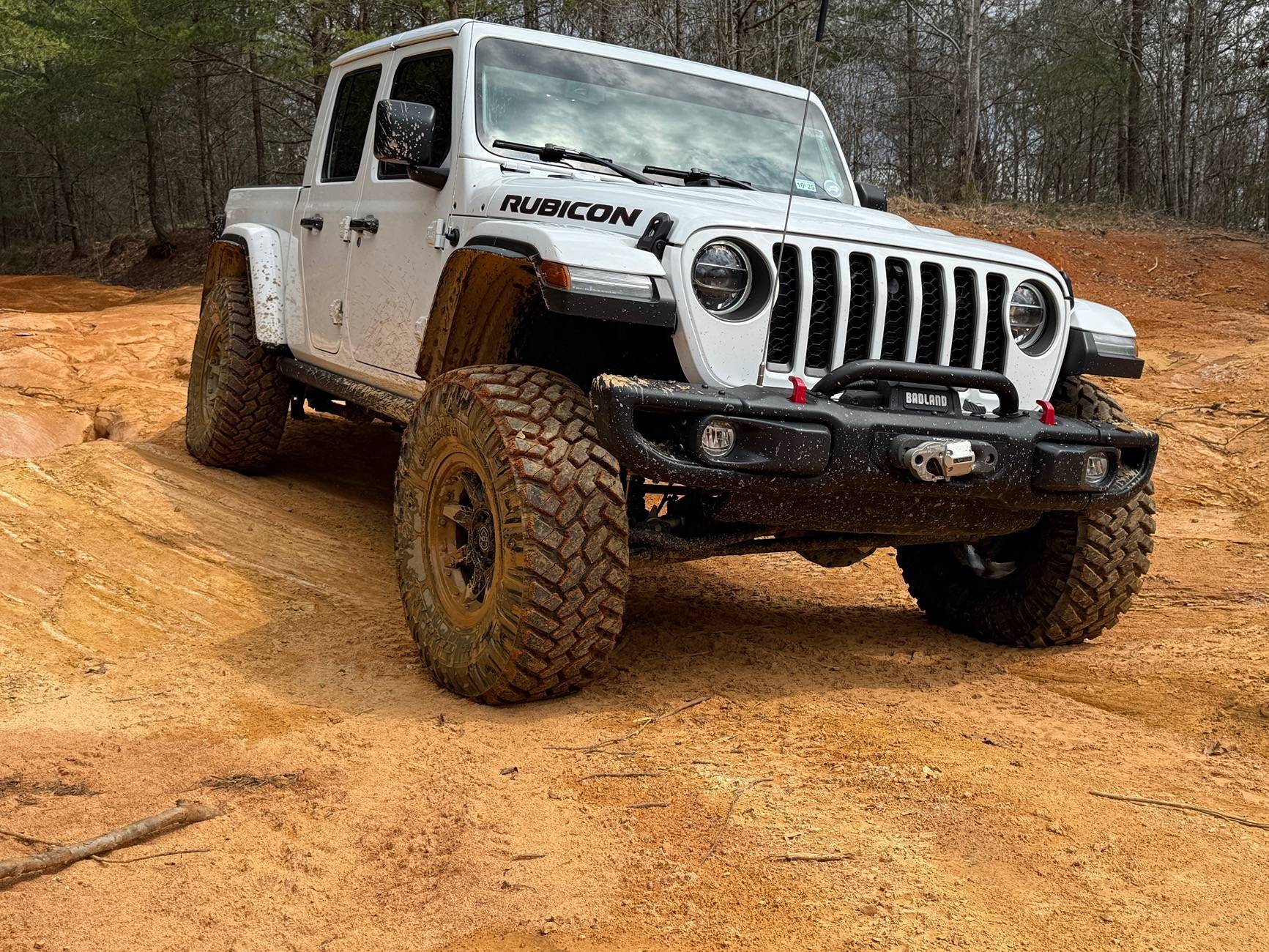

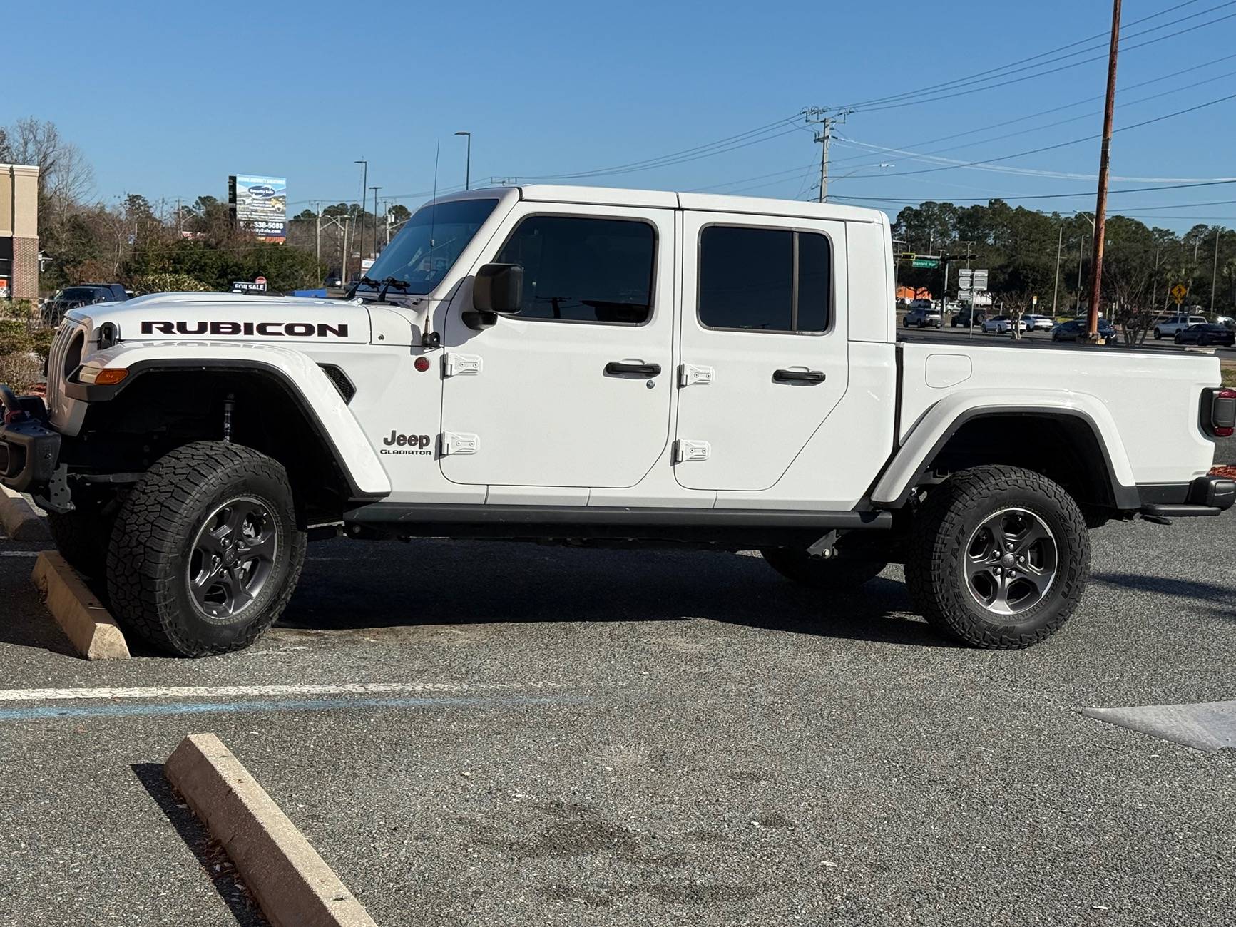

below our photos, post left with stock Rubi wheels and tires. It took something just over a month to get the wheels and tires in.

Yeah the Rubicon fenders make those tires look small. Not so bad on a Sport S. I ended going Fusion 4x4 steering upgrade which has been rock solid. Next upgrade may be the Metalcloak baller joints.

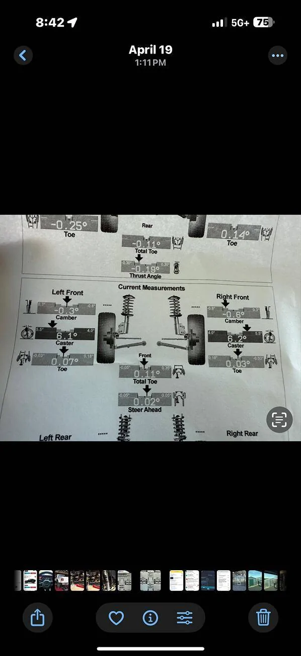

ok so today i finally got somewhere after check and rechecking every part and retorquing everything it was still there i got one of those laser measurement tools and checked my toe and it was dam near 0 +/- .01 so i added positive toe. I marked the tie rod adjuster with paint marker and went 1.5 turns in i know this is drastic took if for test drive down road that always give me death wobble and nothing, but did have tire screeching when turning, so i backed off toe 1/4 at time till death wobble came back then went back 1/4 and its set
That's a good bandaid, but it's not a root cause fix. Something is still awry in the steering or suspension. Nice logic and work though.
