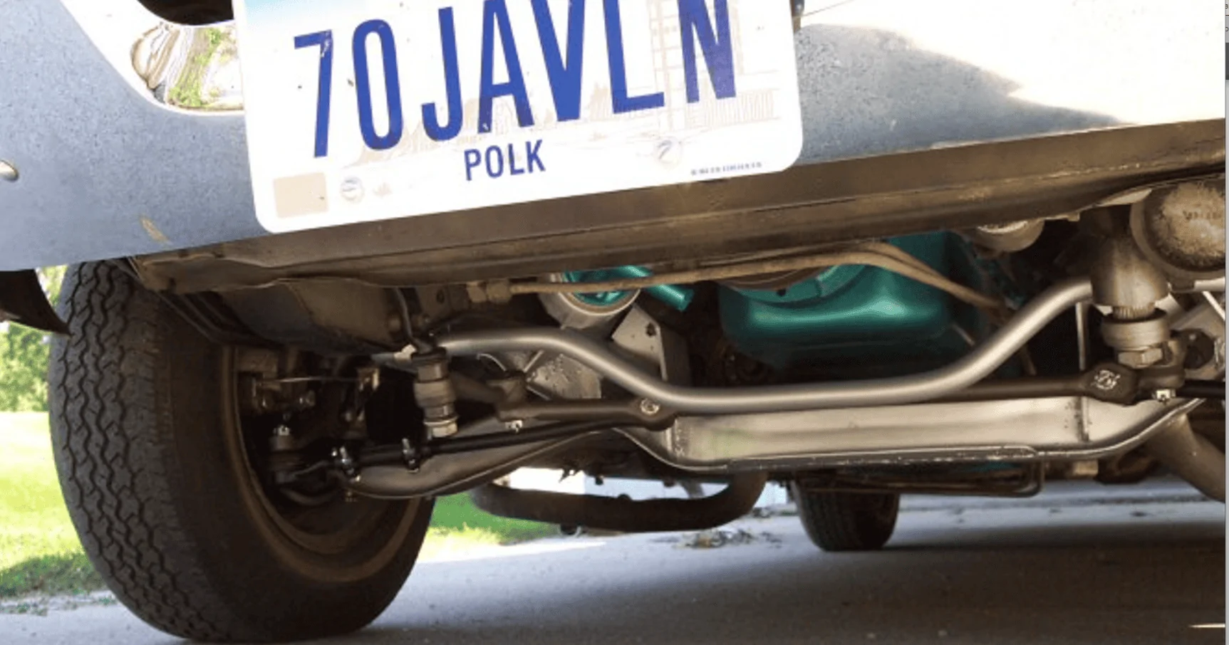

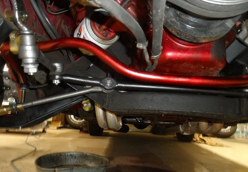

You clearly didn’t look at the pic. ?
It’s a TJ with stock inverted Y steering. The tie rod connects to the drag link.
Either way, the tie rod does not connect to the pitman arm. The drag link connects to the pitman.

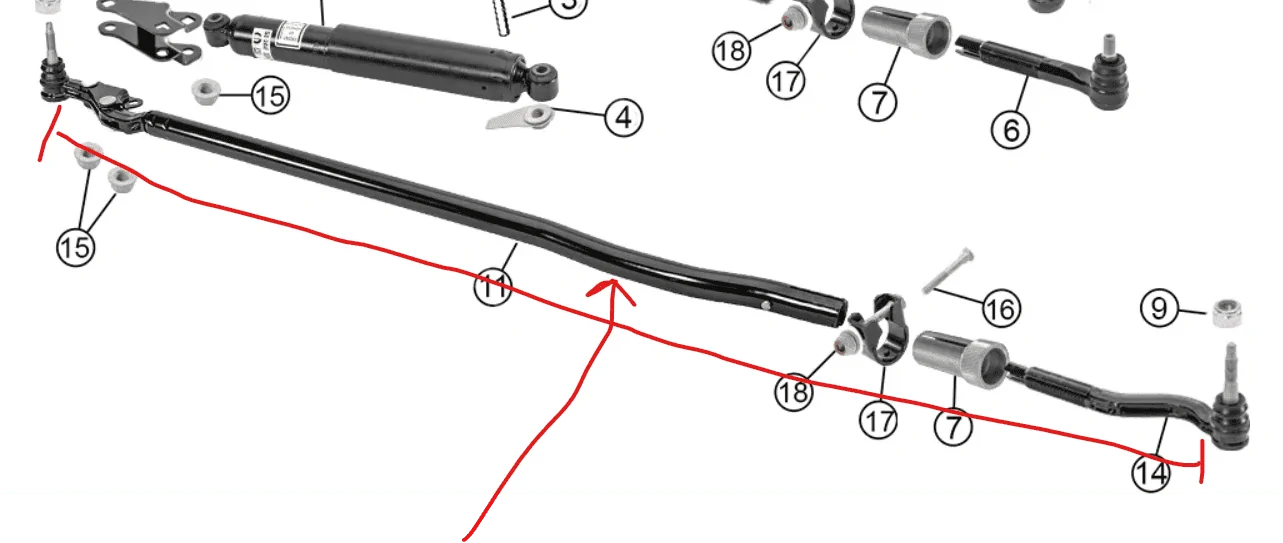

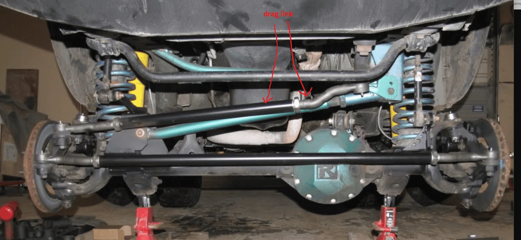

The drag link is here-
Jeep Gladiator death wobble / shimmy/ blah blah blah fixed ! 1670546935601
(6) in the picture above is the outer socket, part of the drag link and NOT the tie rod. And, it is GLADIATOR.

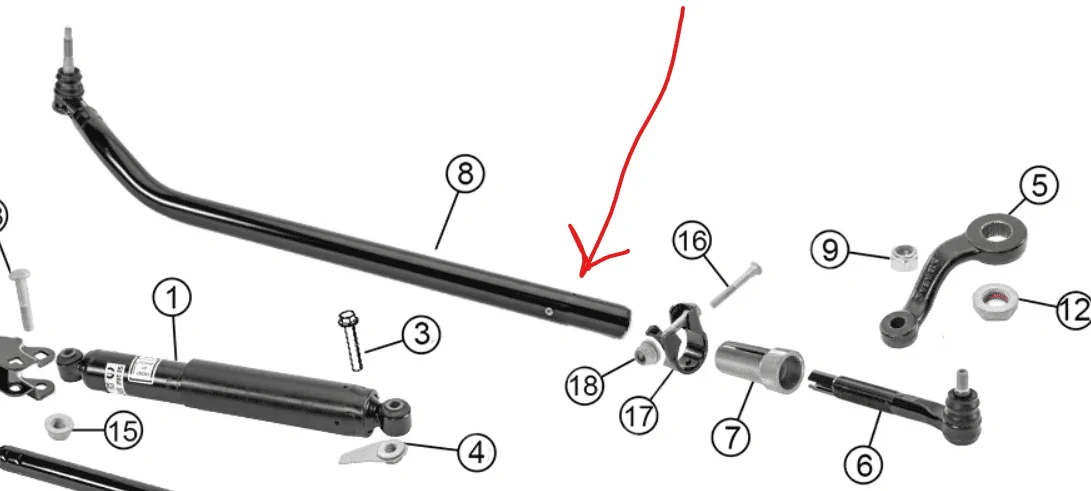

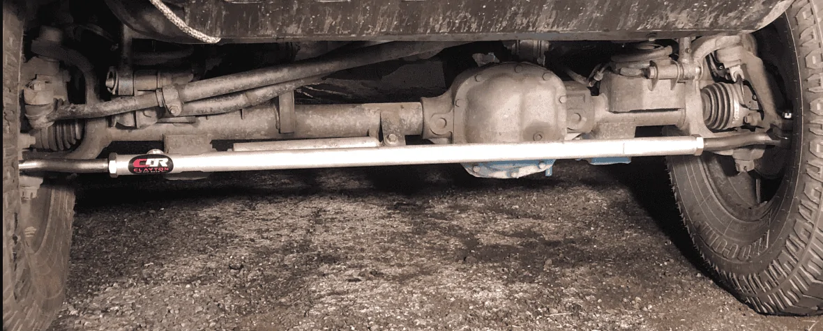

DRAG LINK -
Jeep Gladiator death wobble / shimmy/ blah blah blah fixed ! 1670547037614
The tie rod is shown here and clearly does go knuckle to knuckle. It never connects to the pitman arm.
Jeep Gladiator death wobble / shimmy/ blah blah blah fixed ! 1670547006910
Even the pic originally referred to shows and proves the DRAG LINK connects to the pitman, not the tie rod.
Tie rods have never connected to the pitman.

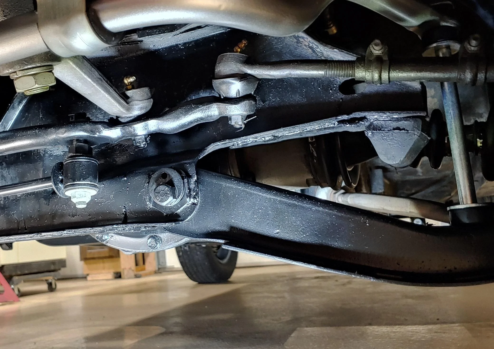

and theres a replaceable tierod attached to it . Have a look on your own truck its there
Sorry, that's NOT a tie rod and if you go to MOPAR and order TIE ROD, you will not get THAT part.
You would be correct. Can't say how long it's been since I've seen that setup, but I shouldve actually looked. Sorry all.
At least one of the points I made was correct LOL: Tie rod does not connect to the pitman arm and OP refuses to learn.

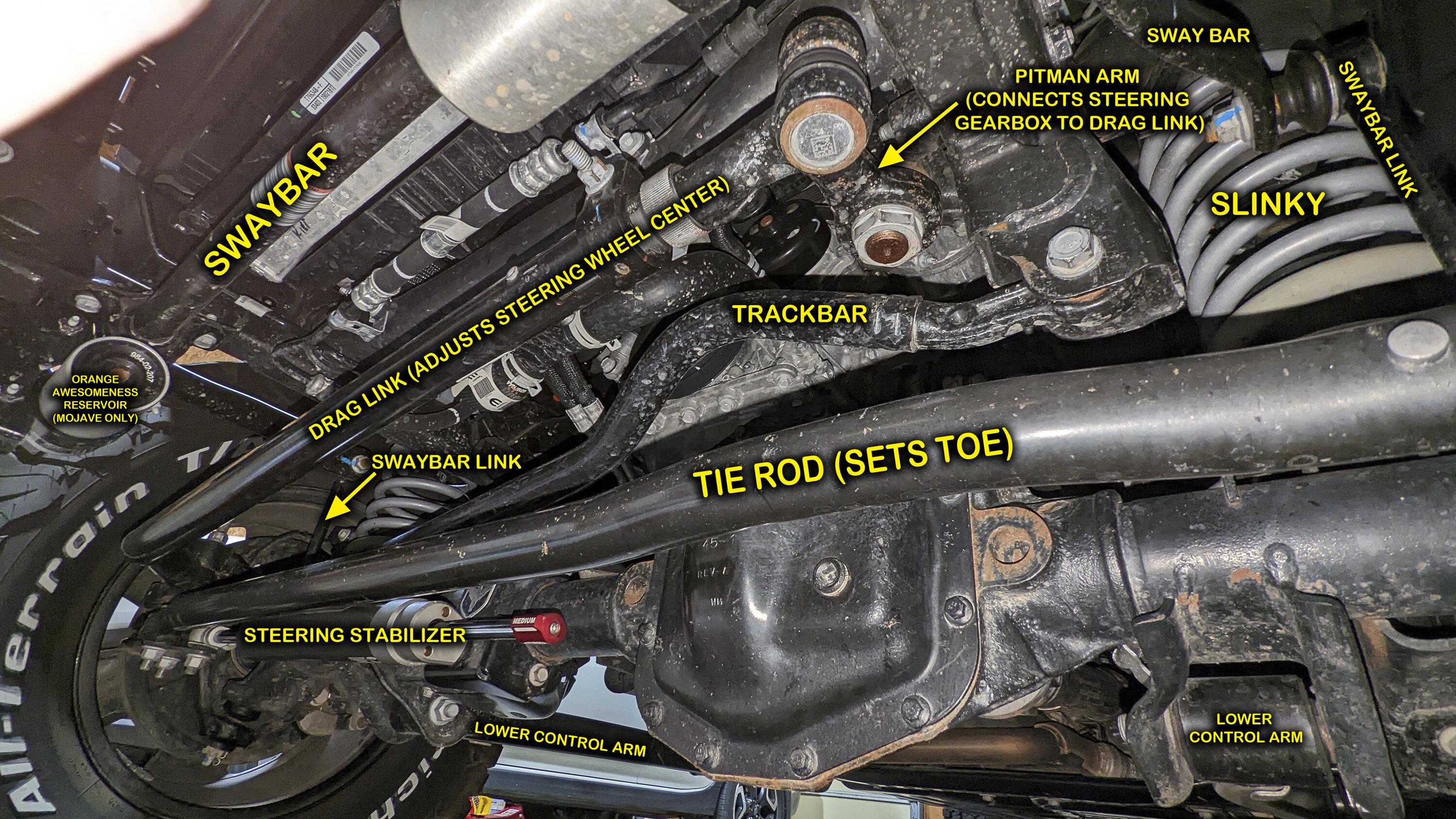

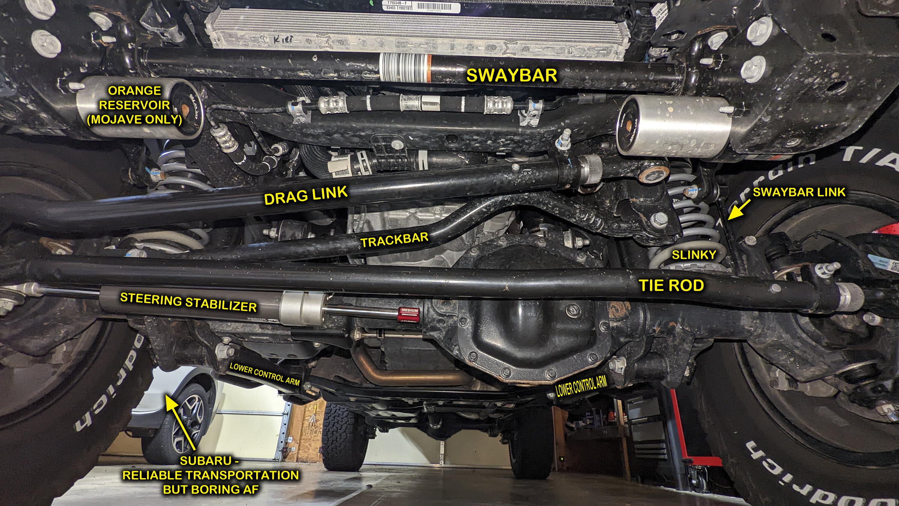

So, where's the drag link and where's the tie rod?
Jeep Gladiator death wobble / shimmy/ blah blah blah fixed ! 73-Jav-suspension-4
Jeep Gladiator death wobble / shimmy/ blah blah blah fixed ! sway-bar-link
Jeep Gladiator death wobble / shimmy/ blah blah blah fixed ! 1670550222059
Jeep Gladiator death wobble / shimmy/ blah blah blah fixed ! 1670550368349
Jeep Gladiator death wobble / shimmy/ blah blah blah fixed ! Screenshot 2022-12-08 194812
The term actually predates automobiles - it was used in farm equipment, etc. - cultivators, for example.
