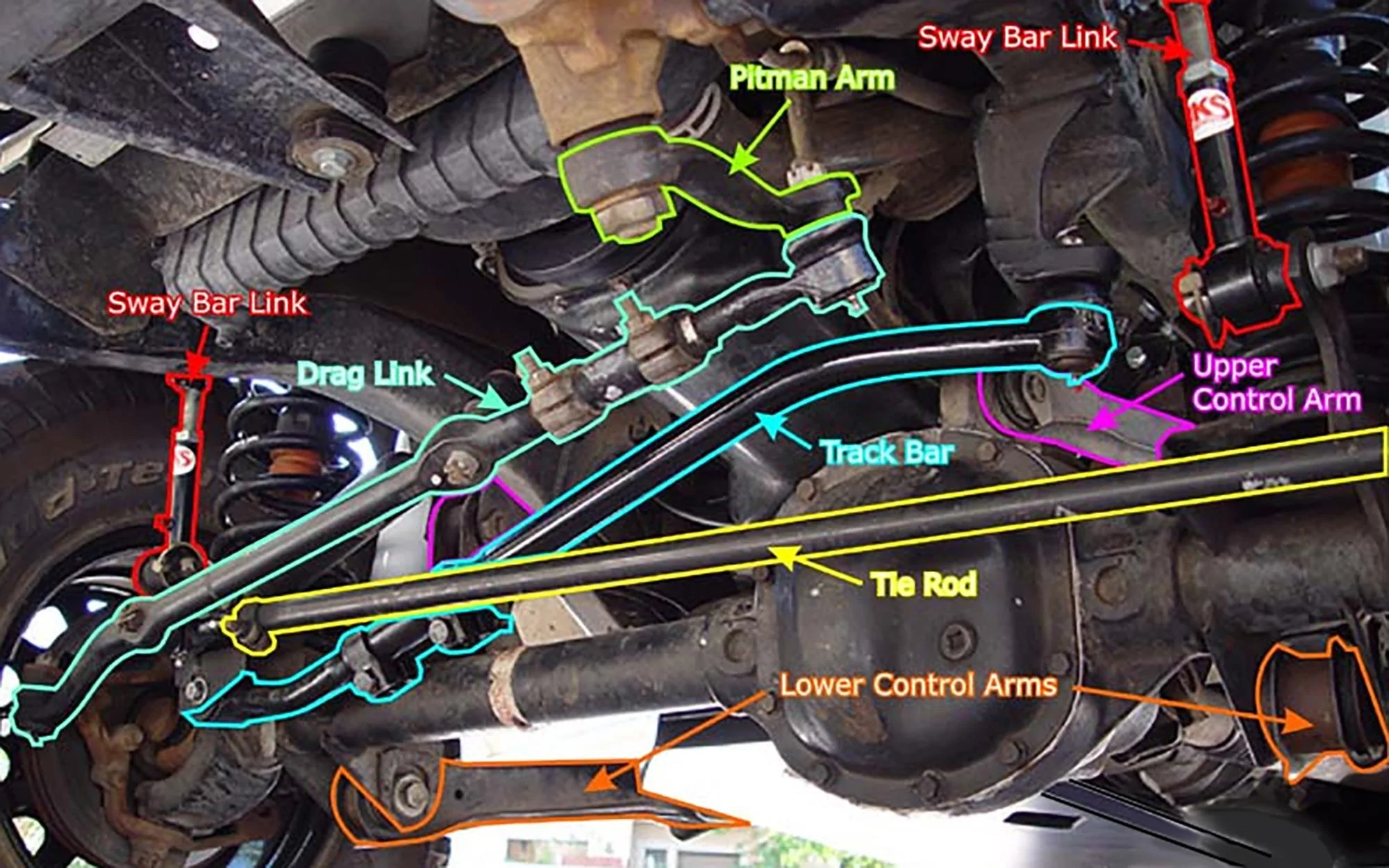

Please note that for clarity, and for people understanding what was replaced, what was loose, and what wasn't -
The tie rod does not connect to the steering gear's pitman arm.
The drag link goes from pitman arm to the right knuckle.
The tie rod goes from right knuckle to left knuckle, never touching the pitman arm at the steering gear.
So if the part you had replaced at at the pitman arm on the steering gear - it was the drag link socket on the left end of the drag link. It's the piece that goes into the drag link and connects to the pitman arm, through a hole in the outer end of the pitman arm and is secured with a nut.
You can check things for "tightness" - but there's two "tightness" to check -
A. The fasteners themselves like the nuts and bolts - if those are loose, you re-torque them properly with a torque wrench.
-There are also "ball joints" at the top and bottom of each knuckle - the ball joints allow the knuckle to pivot on the axle tubes.
Those have been known to actually be loose from the factory IN CERTAIN MONTHS OF PRODUCTION.
and
B. the tightness of the sockets - the joints themselves. And if those are loose - you replace parts.
There is a socket joint at each end of the tie rod which runs from knuckle to knuckle, there is a socket joint at each end of the drag link that runs from pitman to right knuckle.
To check those, have someone in the truck quickly move the steering wheel back and forth and watch for, even feel for, looseness in the joints - the socket joints.

yes and there is a tie rod connected to the draglink that also connects to the pitman arm. This picture is not even a gladiator suspension. Most likely an older jeep suspension
Umm...no there isn't. Clearly you don't know what a tie rod is.
Tie rod is ONLY from knuckle to knuckle.
Drag link ONLY goes from passenger tire knuckle to pitman arm.
The above two points are correct on a YJ as well as a JT. Maybe you're mixing up phrasing and you're thinking bushing? Idk but what you said above is very very wrong.
It’s a TJ.
It’s still good for illustrative purposes even though it’s inverted Y steering.
You clearly didn’t look at the pic. ?
It’s a TJ with stock inverted Y steering. The tie rod connects to the drag link.
and theres a replaceable tierod attached to it . Have a look on your own truck its there
