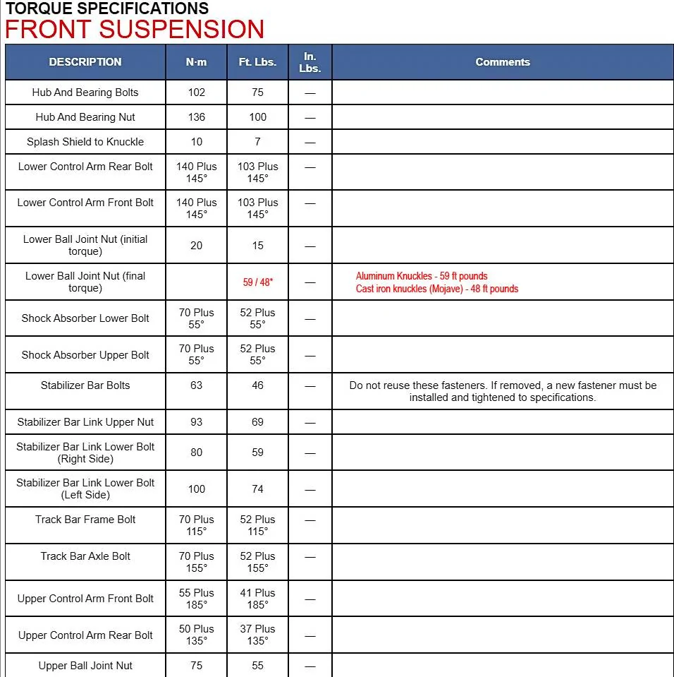

When folks say in this thread that they “make sure everything’s torqued correctly”, how exactly are you doing this on already-installed, single-use fasteners with torque+degrees listed under the specs? I can understand how to achieve the prescribed torque+degrees when installing a new part, but if a shimmy or DW develops X miles after the install, how would you confirm that nothing loosened? Doesn’t seem like you could throw a tq wrench on one of those fasteners, and you certainly can’t re-do the tq+deg.
You can usually find specs for both, initial plus degrees and full torque. The primary thing is to make sure that they're at least not so loose that they can be moved before reaching the initial torque value.
Most aftermarket parts suppliers will specify in traditional lb/ft only, so if you can't find a Jeep value for it, then find an aftermarket one that uses the same size fasteners and follow their guide.

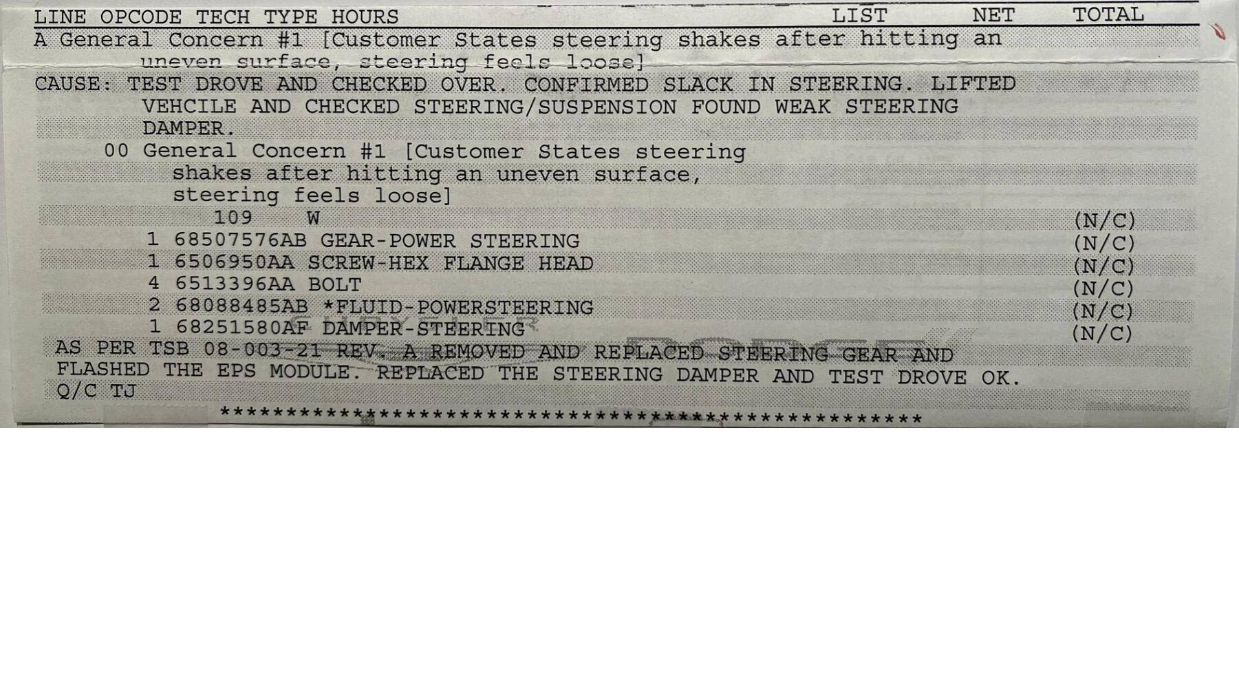

Before reading this reply, read the very first post in this thread. It's a great place to start on this topic, and you might be able to stop there after you've read it.
Here is a brief summary of my case and a summary of recent posts on death wobble and steering gear adjustment. The following solution for death wobble (TSB 08-003-21, plus replacing steering damper) worked in my case, but it will not work in every case.
Preparation:
- This solution is for a stock Gladiator with OEM-size tires and no mods
- Tell the service advisor that the steering "shakes" and "feels loose"
- Schedule an appointment (play by their rules, because this should be like an outpatient visit with no recovery period)
- Getting the dealer to do this specific fix can require some convincing
- Keep DIY fixes and other alternate solutions in reserve until a dealer has tried this fix
- I call this solution "TSB method + new steering damper"
Solution for Stock Gladiator with OEM-Size Tires and No Mods
TSB Method + New Steering Damper
  • Also see attached invoice (below) with reference to TSB 08-003-21
  • This solution does not address all causes of death wobble, but the work completed in this invoice completely resolved death wobble in my vehicle in a single visit to my selling dealer
    • My vehicle is a 2020 Gladiator Sport with OEM-size tires and no mods
    • Vehicle purchased new in September 2019, death wobble started at 14K mi in October 2021, repair completed at 16K mi in January 2022, and currently at 47K mi in January 2025
  • Tell the service advisor that the steering "shakes" and "feels loose"
  • In addition to replacing steering gear (68507576AB) and updating EHPS software, steering damper (68251580AF) will need to be replaced
  • Make sure that the dealer also inspects 1) other steering components (not just the damper) and 2) the suspension; the rest of the vehicle (beyond the worn out steering damper) can be affected by the incredibly violent shaking, or death wobble
    • Example: As mentioned in post #15 of this thread, also check the stabilizer

Everything was good except lower front drivers side control arm needed about 3/4 of a turn to get to 190 ft/pounds.
That 190 number is low and not factory specs. The true torque is a torque plus degrees and I've calculated it out by testing to be over 200. The 190 keeps floating around from old documents and lift kits and so on. But I noted that when I did the real spec - torque plus degrees, I easily exceeded 190.
I've posted many times from true suspension engineers - even shocks, tires and other things - loose or worn parts, can lead to DW.
I will have to do some research on achieving the degrees with my current tools. It’s a little confounding to think a manufacturer would expect the average owner to keep up with some of these things. I would assume that even a complete stock vehicle would eventually have hardware loose over time with road vibration. Not to mention the stories about units coming from the factory without proper torque.
It's vastly easier on tools and humanity to run up initial torque to something within the bounds of human capabilities (without herniation), and then finish with a longer breaker bar or an impact wrench.
Degrees are easy if you own an analog clock or watch.
