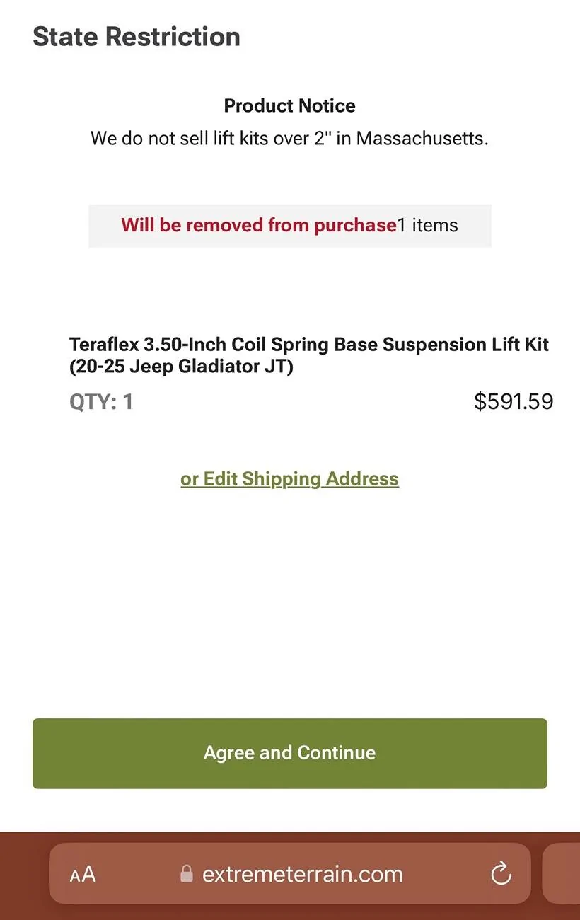

Or maybe they’re limited to the 2” lift…lmao.
I knew there were some weird laws in MA but my goodness. I’ll have to go through the shop I found or pick it up in PA when I visit the in-laws lol.
Edit: It actually just might be ExtremeTerrain abiding to this. Don’t think those springs will work for me anyway. I like the price point for that kit though.

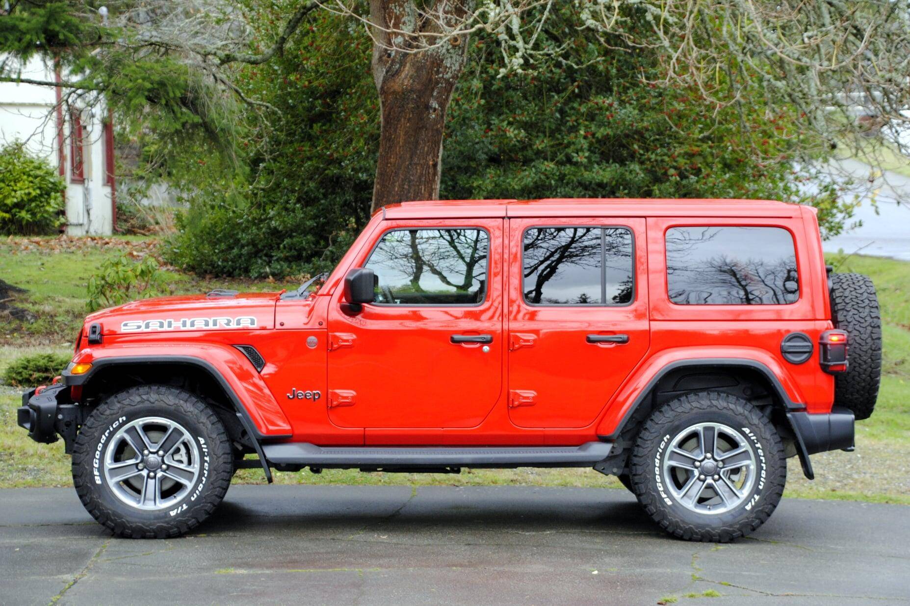

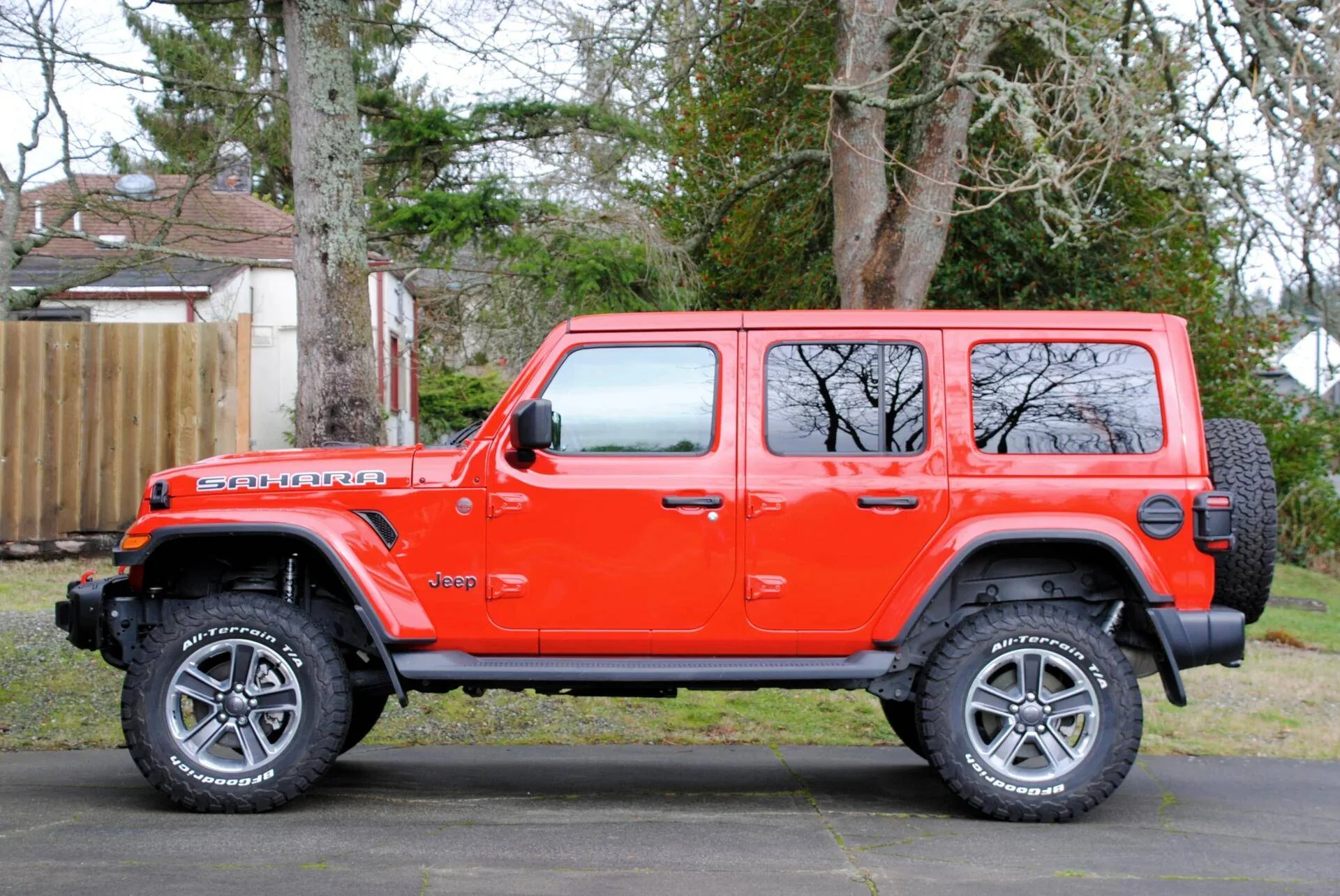

In 2020 I got the dealer to install a Mopar lift on my 2018 JL Sahara. Mopar was offering a special on parts and labor for $2,000, so I took the plunge.
The "2-inch" Mopar kit gave my non-Rubicon Jeep a lift of 3.5 inches, which is a LOT --see below. The kit includes longer control arms but no adjustable track bars, so my axles came back 1-inch off center. The lift kit also reuses the OE (i.e., weak) stabilizer.
Right away, the steering started wandering all over the road, and developed a strong pull to the right.
Brought the Jeep back to the dealer, who said they could "...not do anything because the vehicle has been modified." Then added that I needed to "bring the Jeep back to factory spec" if they were to look at it. I gave them a piece of my mind and stormed out.
My Jeep before and after the Mopar lift install
Jeep Gladiator The "Mopar lift" - an honest curiosity... 1614283035262-pn
Jeep Gladiator The "Mopar lift" - an honest curiosity... 1614282980420-png
I got a YETI adjustable track bar installed by an independent shop, and a wheel alignment, for an additional $1,100. It didn't help.
Ordered a beefier Fox 2.0 stabilizer from Amazon ($175) and installed it myself. It helped a little.
Next thing was to get the steering box TSB done. The dealer came back with the same response: "we cannot do anything until the Jeep is back to factory spec." Again, I shared what I thought of them.
Got another dealer, 30 miles away, to do the TSB: it helped a LOT. The stiffer steering box and its recalibration restored much of the steering feel, and eliminated most of the pull.
Then one day I experienced a sudden, unexpected and severe case of Death Wobble crossing a set of diagonal train tracks. The steering wheel started pulling violently side to side. Thankfully I was doing only 40 MPH, so I was able to bring the vehicle to a complete stop without incident.
Never again did I experience DW in the following two years I kept the Jeep. But the trust was gone.
In summary: the Mopar lift is a complete waste of time and money in my experience. The longer control arms included in the kit are insufficient to correct for the lift's dramatic change in geometry. For the $3,300 I ended spending, I could have gotten a much higher quality lift, like, say Metalcloak, which is much better engineered, made of better grade materials, and includes everything you need.
With regards to getting a Mopar lift for the OE warranty: Mopar warranty has become a complete joke. Because Stellantis makes dealers' life so miserable, Jeep dealers do not want to do any warranty work. Period. Mopar or no Mopar; it doesn't matter.
Something to think about if you are considering a Mopar lift.
