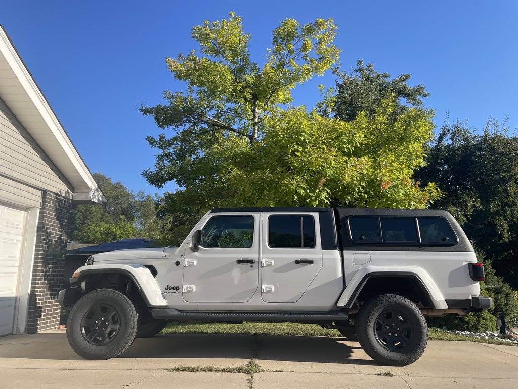

I had both the Clayton 2.5" and Mopar lift parts sitting on the garage floor, trying to decide which one to go with. Ended up going with the Mopar for several reasons:
- Warranty was not a factor as I installed the lift myself.
- Wanted to keep the truck as a daily driver and tow friendly.
- Wanted similar stock drive characteristics with a little more lift.
- Wanted a set of springs with a slightly higher spring rate than max tow stock.
- Did not want to mess with adjustable arms, brackets, high driveshaft angles, brake lines.
The Mopar lift met all the criteria and was the easiest path to get a comfortable ~3" lift.
The Mopar ride is very comparable to the AEV lift on my JKU. Smooth and planted on the road.
Having said that, the Clayton springs were hefty and they weigh almost twice as much as the Mopar springs.

Your Mopar lift looks good on the 33s. Do you have a spacer with that lift? I always thought Mopar lift kept the rake in the JT.
Did you also add any additional parts to the suspension? LCAs? Adjustable track bars?
Do you notice any axle shift from the lift?
Thanks.

Thank you. The lift goes well with 33s indeed. No spacers and there is a slight rake of about 1" vs. my original stock rake of 1 5/8".
I added the Mopar front LCAs and kept the stock track bars. I'm also running airbags when towing my camper.
The front axle shifted 1/4" to the driver side. Rear axle shift was minimal at 1/16".
