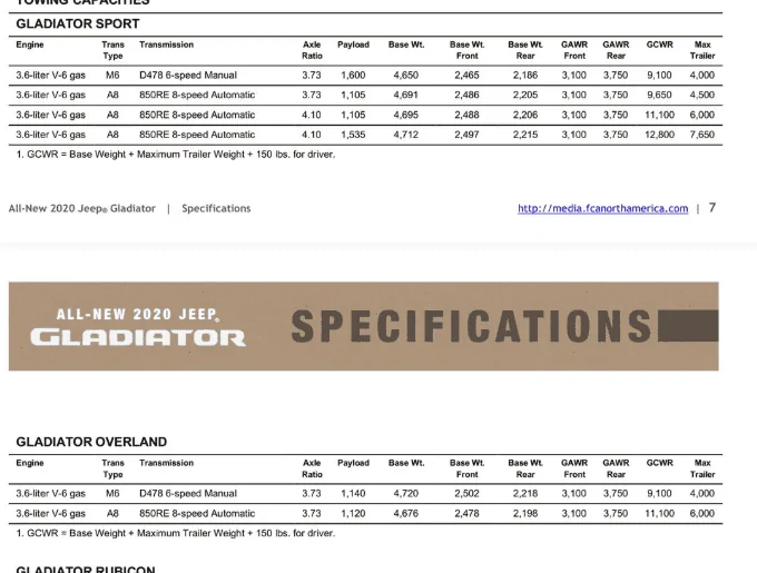

According to this, should be able to do 1500 in the bed.
Jeep Gladiator Tested out the payload capability with Mopar Lift upload_2019-2-4_12-41-53

I assume you mean all sprung weight additions, unsprung weight would not make sense. So the lift kit does not add payload, even though it affects payload capability, obviously. My payload assumption was due to the specification page from FCA listed above directly calling out payload. Ford and chevy dont do that. They give you VW and max VW and let you figure it out.

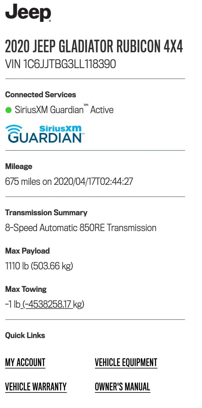

So this is interesting. It's what shows up in my Mopar account. My payload shows as 1110, and apparently my ability to tow has been suspended!
Jeep Gladiator Tested out the payload capability with Mopar Lift Jeep_Dashboard_for_Jeep_Vehicle_Owners___Powered_by_Mopar
