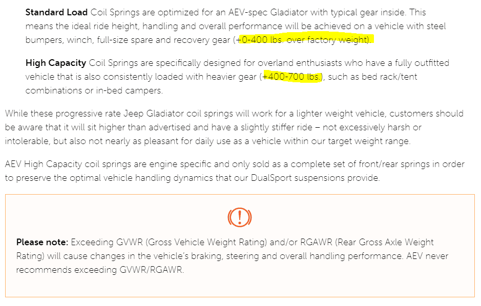

standard duty - +400 pounds over GVW
HD - +700 over GVW, which is about the axle rating
Not to derail this thread but I'm not sure this is correct... (I will delete if I'm wrong)
I think AEV is referring to Curb Weight + Extra Payload capacity... I don't believe they are quoting you additional weight OVER gross vehicle as they have a huge warning not to exceed GVWR.

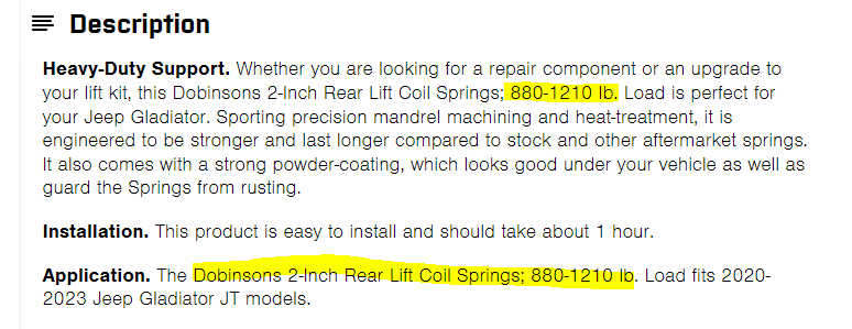

Dobinsons makes I believe the stiffest rear springs available that basically take you all the way up to GVWR
negative. Information on website is purposefully unclear. It is not weight over stock curb weight.
+700 pounds over curb weight is GVW. Therefore if this were true, which it is not, then they would have the same performance as factory springs, for which their performance well supersedes stock
Wow... well good to know. thanks. I mean I'm 1000lb+ over GVWR so the HD springs would definitely work for me :)
this is exactly one of 2 primary reasons I went with them
it also explains why Brad was so harsh with his review of their lift on the wrangler when that test vehicle was stock and completely unloaded. As that is not the intended use case
