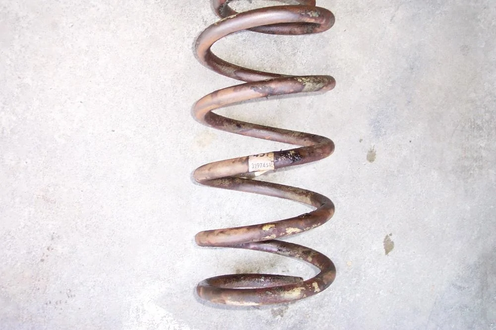

I thought it was previously said that rhe last 3 #’s was the spring rate but that doesnt seem to be the case.

There have been different left and right springs since at least the late 1960s.
I've posted before about the page after page of spring part numbers AMC had for 1970-73 Javelins alone.
There were at least 3 suspension options on the AMX, 4 for the Javelin depending on engine, AC or not Go Pak or not, etc., with left and right springs.
For Eagle there were also different left and right springs - although REPLACEMENTS offered by other parties always fit "either side", the originals had different part numbers.
Note here, an original 1970 spring with original part number tag how even then, the last 3 digits were the ones picked out and enlarged. So what Jeep is doing today dates back to at least 1970 AMC days.

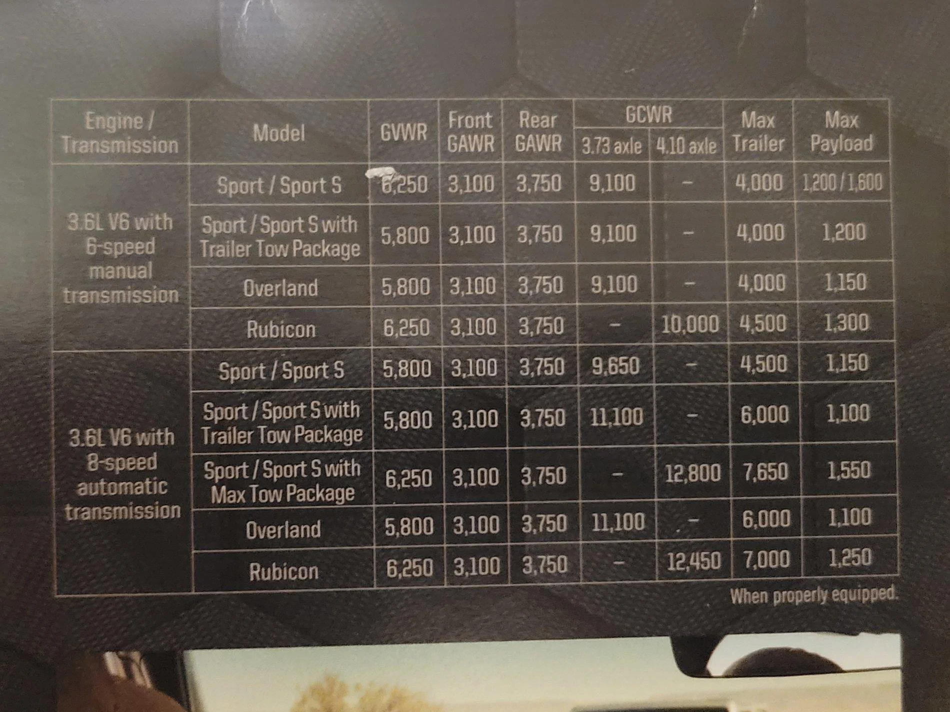

Thank you for all the info. I know Duallys (dualies?) exist because of payload so it makes sense tires have more to do with payload than springs.
Jeep advertises 1700lbs as the Gladiator's max payload on their website but also you're correct they're not marketing a max payload config or spec. I only call mine max payload because
Jeep Gladiator Coil spring part numbers 20201028_111501
Of the 2020 brochure (top right box) where the Sport S manual no tow package is listed as 1600lbs. My door sticker says 747kgs (1646lbs).
The only thing I'm not sure you're saying is correct (I'm open to being wrong, that's why I'm here - learning) is that max tow has max payload. I've never seen a max tow with as much legal payload listed on the door sticker as me. I think max tow has engine cooling I don't (bigger fan).
Ultimately what I'm trying to get to the bottom of: am I better using my max payload springs or the Rubicon take off springs I have? There are not a lot of sport s manuals with no tow package out there
So who is correct? @ShadowsPapa or @KurtP? Springs have no effect or they do effect payload?
I'm not talking door sticker number. I know printed ink cannot magically change.

im not trying to be a dick, but after having gone through the builds of literally dozens of armored vehicles used in half a dozen countries on 3 continents to include the US, I know what im talking about.
papa isnt wrong in the sense that no, changing a spring does not mean your truck suddenly has a higher legal gvwr. But spring rate relative to load carrying capacity IS a *PART* of gvwr.
dont get wrapped up on what the brochures say.
-look at your gvwr on YOUR door sticker
-look at your axle ratings front and rear
-look at your factory tire load ratings.
those are your legal maxes, and i dont suggest going over them. Changing parts does not change what your truck is legally rated for.
if you want to carry more weight on your own impetus knowing the possible ramifications, the way many people do it is increase the load rating of the tires they use and increase to stiffer springs, larger brakes, and better cooling.
gvwr takes into account various options, as mentioned. All things being equal, two of the same trucks with all else the same, the stiffer sprung one will haul more.

Springs are part of the equation. So is the axle rating, the width, the tires, the cooling, axle ratio, etc.
If your truck is rated 1600- I'd keep it as it is. Rubicon isn't rated for the tow or payload of a sport S
Why would you replace springs under a truck with the highest rating with springs from a truck with a lower rating?
Your truck is made to haul 1600 pounds (total) why mess with that?
Yes - it's for sure part of it. It's a system, an equation. Not a single part. And you were correct in TIRES - that's a big deal that people overlook.
In this case, if your truck is rated with a door sticker (and in the book) to a payload of 1600 pounds, why would you put springs from a vehicle with a lower payload rating under it?
I put max tow Sport S springs under mine - not to increase payload, but because they are progressive and handle the weight better than the more mushy Overland springs made for a nice ride on the highway.
All I wanted was less sag and a good ride with the 1,000 pound payload.
