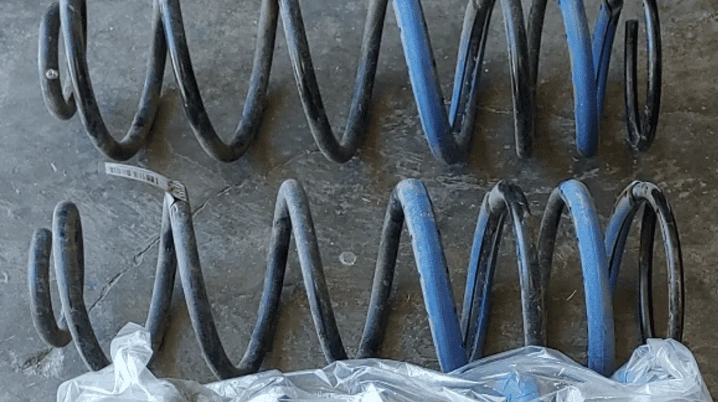

And has been mentioned, the difference in length can be minimal - standing them up it can be hard to tell. I have a pair like that.
Generally speaking, there is a length difference, but they've come out with other variations as well.
Hopefully he's got a pair of fronts and a pair of rears where there is a definite length difference.
I was just trying to stress that you can't always go by length, either. It can be the RATE that's different. If he's lucky, he's got length differences. you were missing my points on comparing the different springs.
I have a pair of springs the same length - so, how would HE know which is left and right and yes, they are Rubicon.

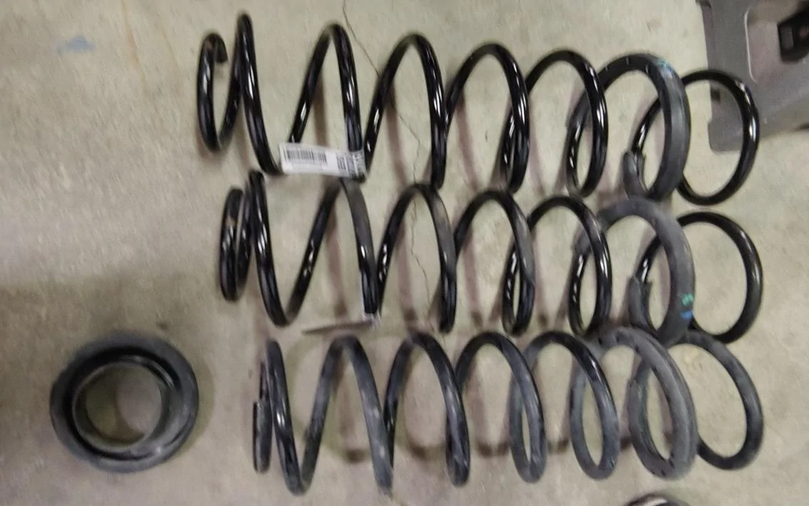

Just picked up a Rubicon suspension takeoff from someone that had a 2022.
Spring part numbers don't exactly match what I've seen on the forum. Some are common but I haven't seen anyone reference the complete set of numbers I have. I need to know which is left side and which is right side. I've seen conflicting information when I search Mopar and also contradictions to the bigger number on the passenger side rule of thumb. Here's what I have:
68506363AA
68506364AA
68506212AA
68506211AA
These springs came off a Rubicon with tow package, steel bumpers, front/rear lockers, and a hardtop.
My Gladiator is a plane-jane Sport with hardtop.
Can any one say for sure which are right side and which are left side?
Another question; this guy did a full mac-daddy lift and pretty much the whole suspension came off and he gave me all the parts. From what I've researched, the only thing different suspension-wise between the Rubicon and the Sport are the shocks and springs. Trailing arms, spring perches, sway bar, linkage, etc. are the same, (or so I've read). Just looking for confirmation this is correct and that springs and shocks are all I need to change.
Thanks!

Only differences are shocks and springs.
GAS engine, higher number/stiffer spring/typically taller spring is on the right.
At least that's been the rule in the past.

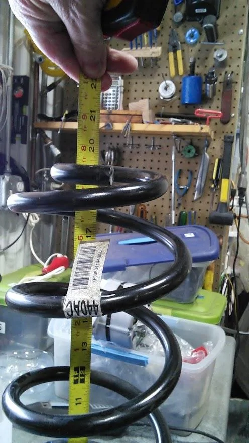

Those are the newer part numbers, earlier model years used different numbering.
As far as "best" - there is no best. Best for your specific goals, maybe, but there is no best or worst spring. They are the same except for the spring rate as far as which numbers you get.
Higher numbers typically mean higher spring rates - typically.

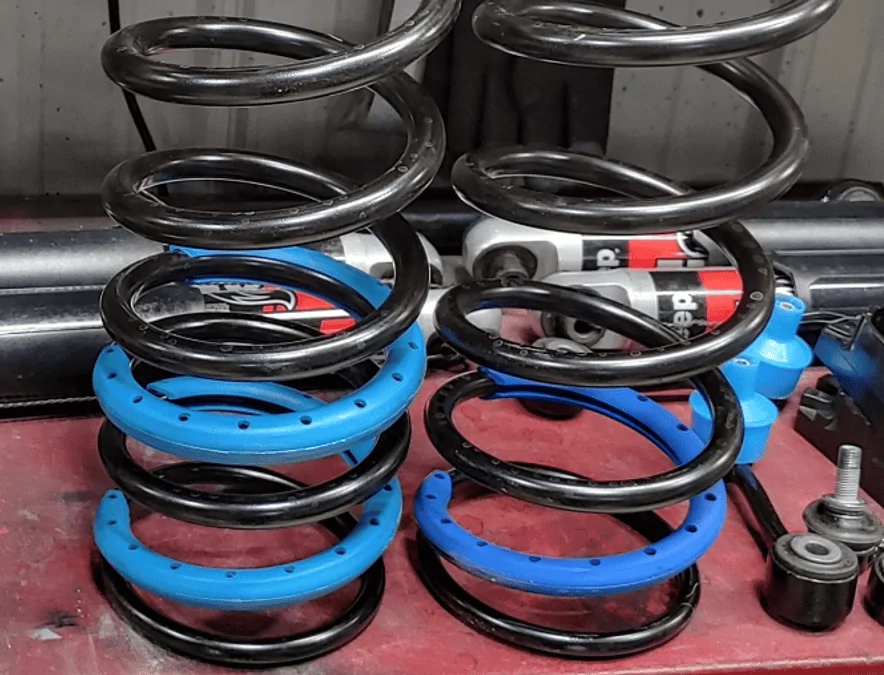

The Rubicon take-off springs I have in storage are:
Left front - 339
Right front - 340
Left rear - 449
Right rear - 450
They are from a 2020 model year, showing just how different the numbering is now. So, you can't necessarily compare except within a given model year.
Even my 2022 Overland springs have totally different numbers than my 2020 Overland had but they are basically identically equipped. They changed the numbering system somewhere along the way.
I consider the numbers I have (the above list) which I used under my 2020 Overland to be the best - why? Because I didn't want a STIFF ride, and wanted about 1" lift and that's pretty much what I got with those numbers. Higher numbers may have lifted it more but at the expense of ride.
For GAS engines, higher number on the right.
For DIESEL engines, higher number on the left.
