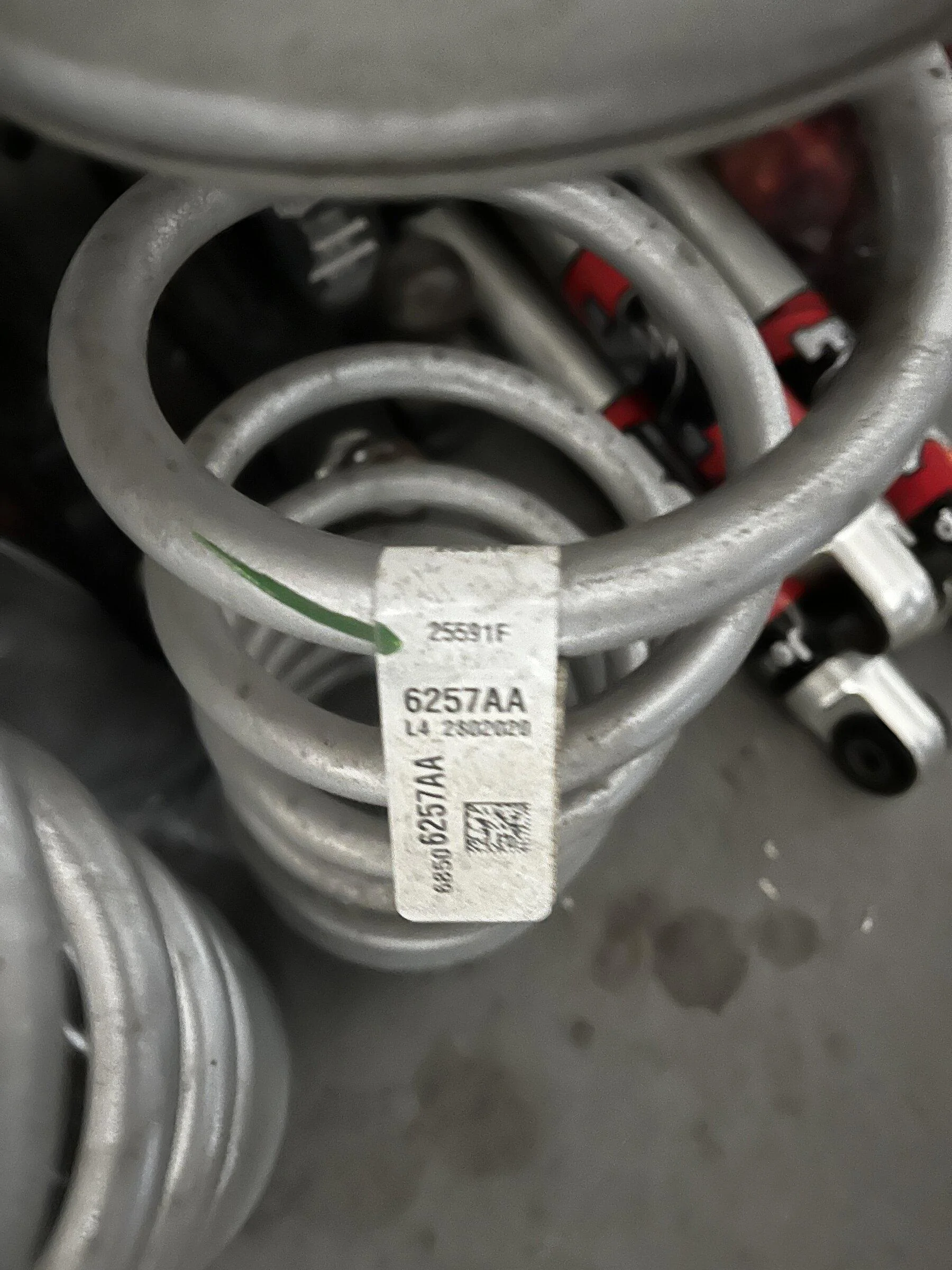

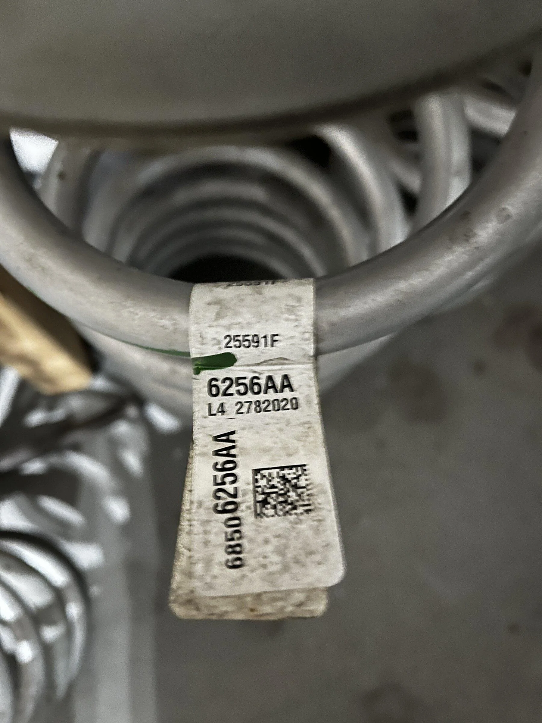

Im wondering if anyone can help identify these spring numbers? I’ve been told that they are from the rear of a Mojave but when I search I can’t find information on them. I’d like to know which is left and right and if they are actually from the Mojave. 6256AA and 6257AA.
Jeep Gladiator Coil Spring Part Numbers E299E12E-17E4-4266-9289-7083BE013935
Jeep Gladiator Coil Spring Part Numbers 5817F724-8BFC-49D2-ACB1-A128CF67BF48
