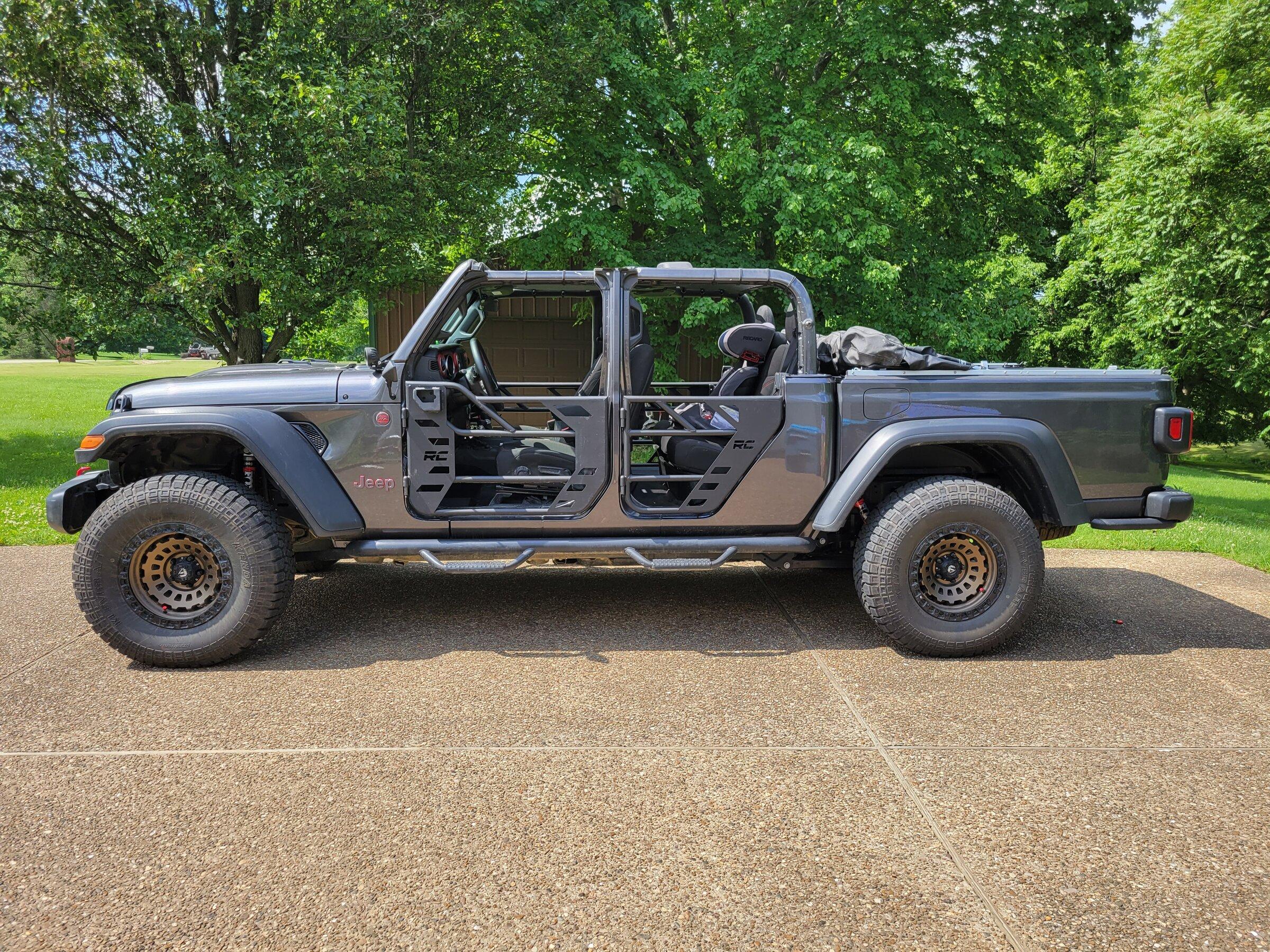

Well... I guess he heard in my voice that I was disappointed in the answer! They called and said it was ready to be picked up and they went ahead and dropped the Clayton's in "no charge" ...pretty cool I guess after wanting to charge me over $300
It was only a 3 mile drive home, so I'll have to give an update latter on how it rides
troymi
Christian
Oct 15, 2021
92
113
Michigan
21 Jeep Gladiator Rubi Ecodiesel
Interested in the pics of how it leveled out the front.
Clayton Off Road
Summit Sponsor (Level 3)
James
Jan 27, 2020
882
1,217
Hamden, Ct
2018 JLUR
I don't know if I have any good comparison shots, but this is what it looks like now
Awesome, love the stance! Definitely reach out with some feedback once you've had a chance to test it out some! :like:
