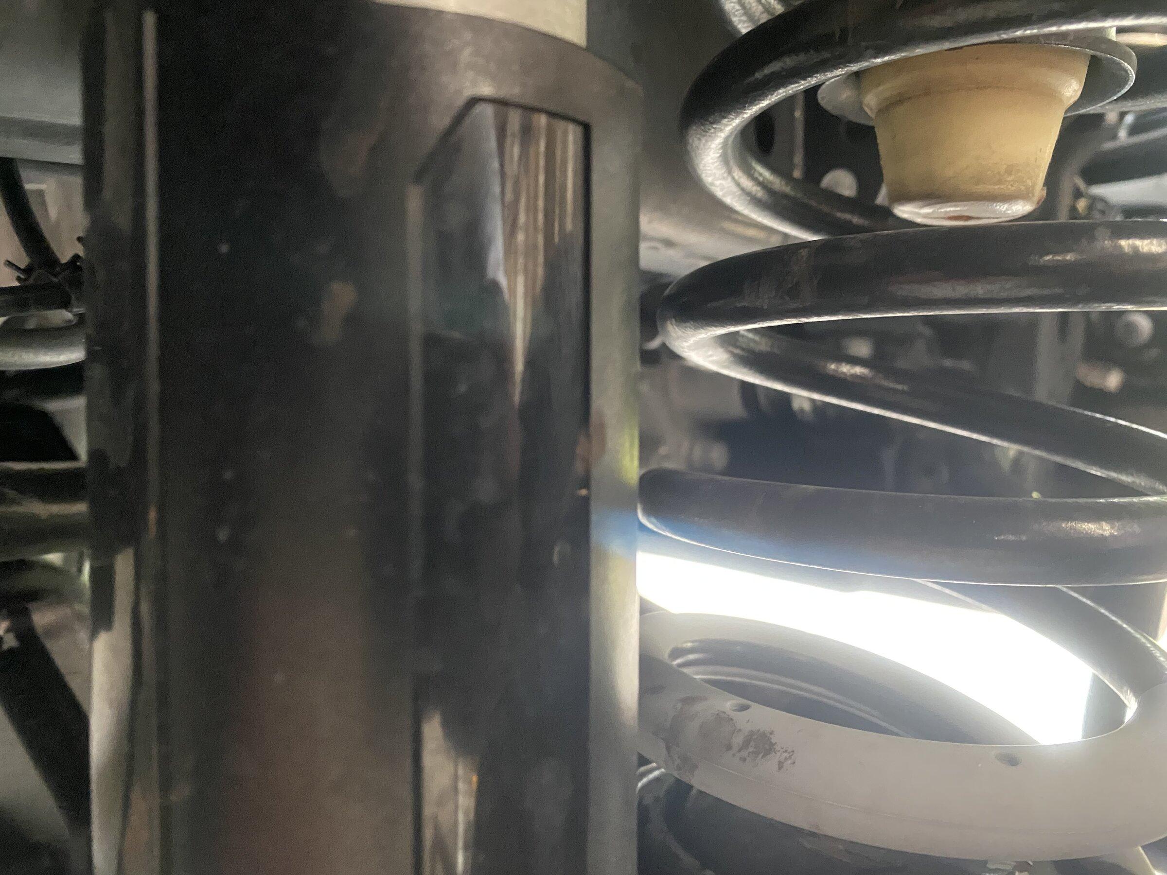

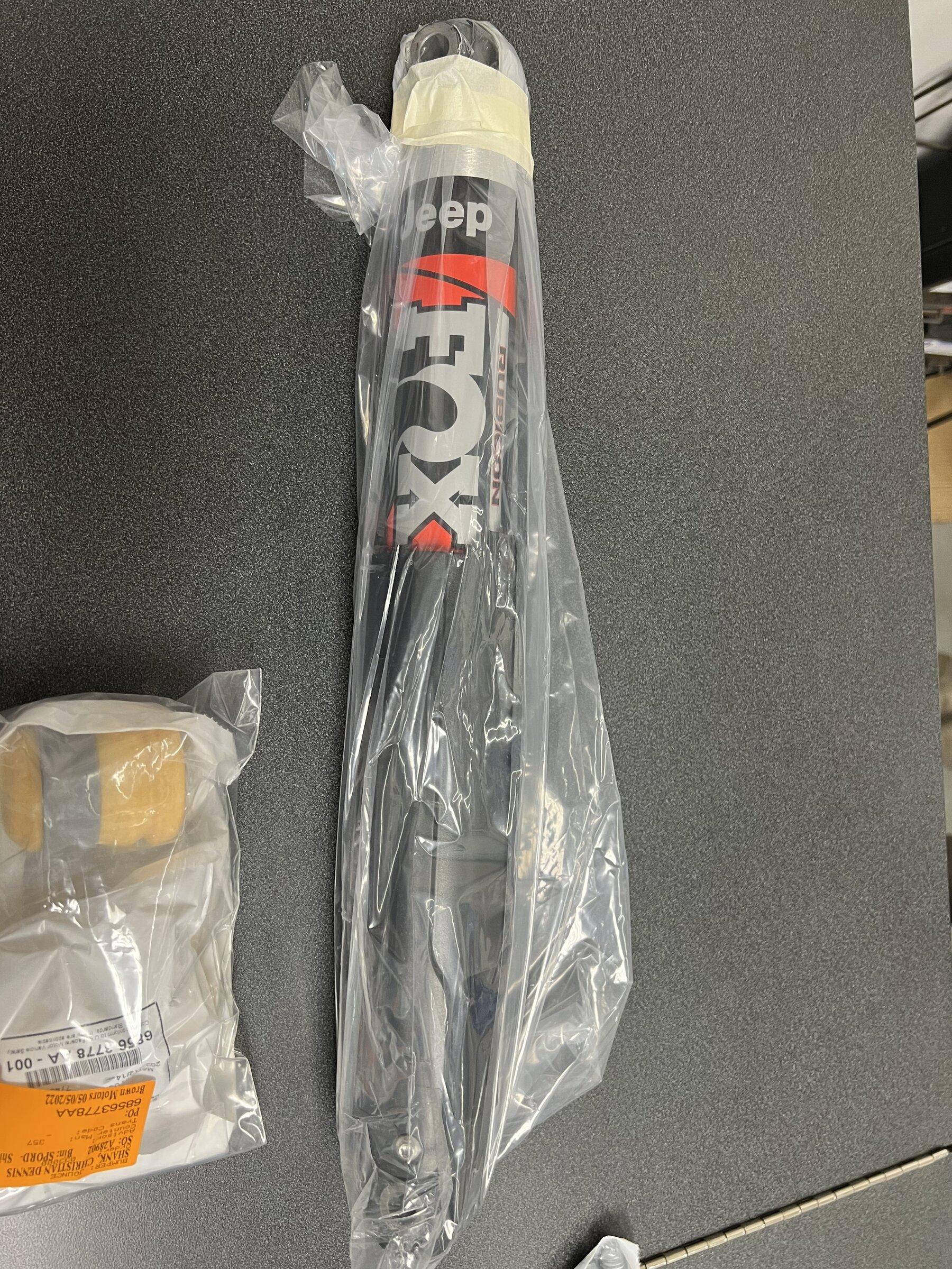

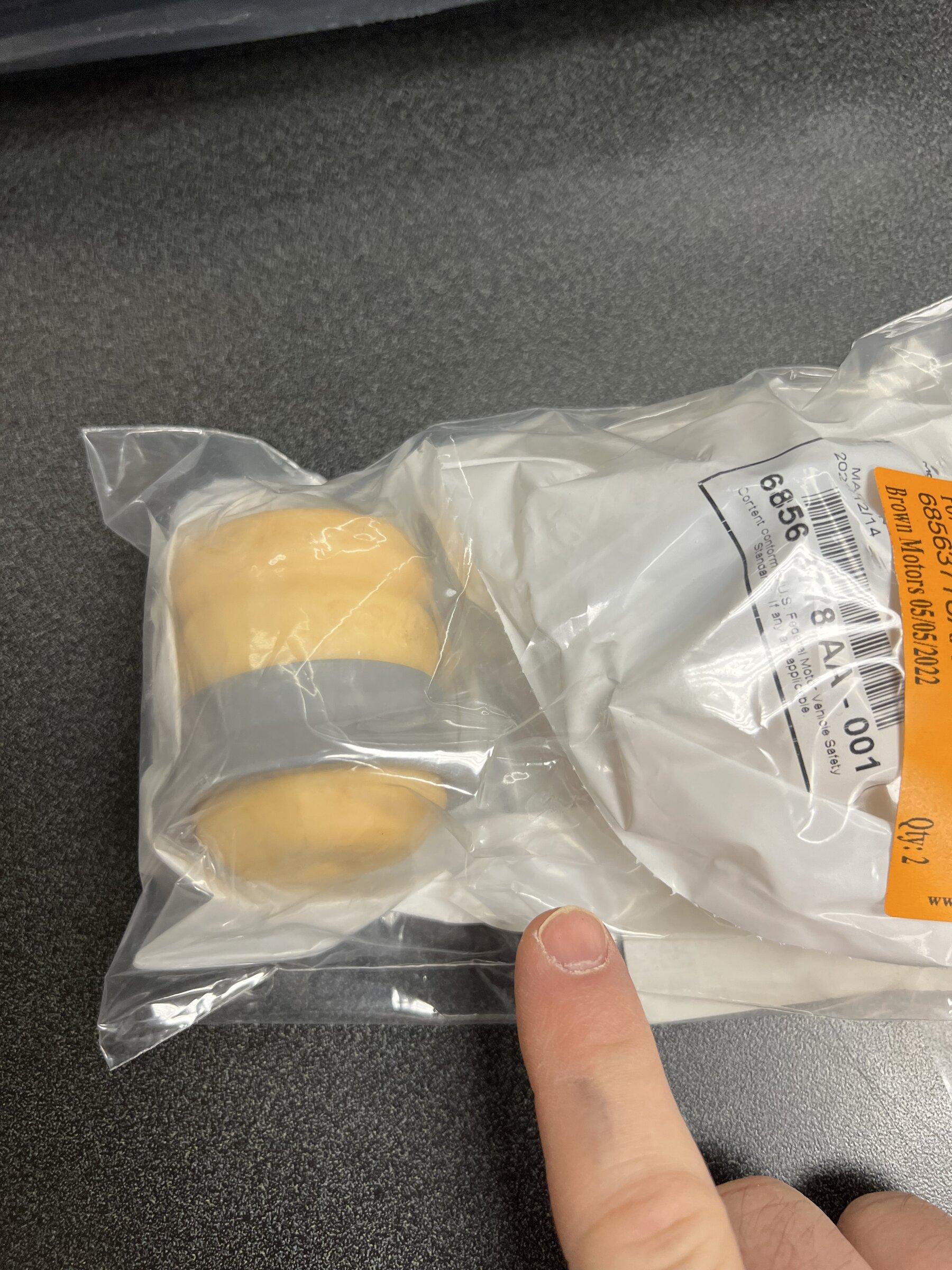

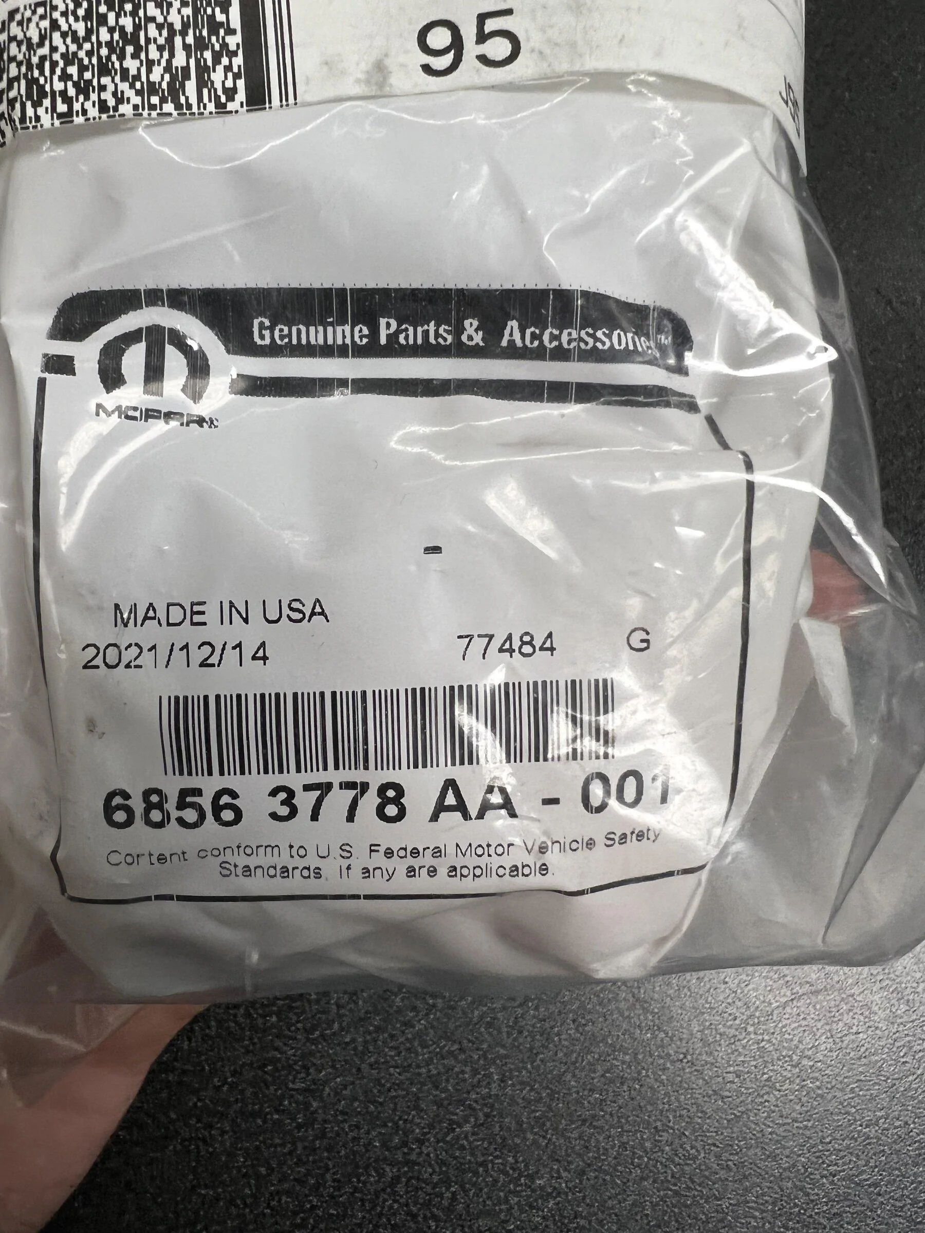

Interesting. The size of the protruding bump stop (the end you’re pointing at) is less than what we have now, but it’s got more surface area. The steal sleeve goes up in the tube. I wonder how much of the sleeve will protrude out the bottom. Please keep us posted.
You did get 4
At the dealer today. The parts exist! Part numbers line up. We’ll see how much difference.

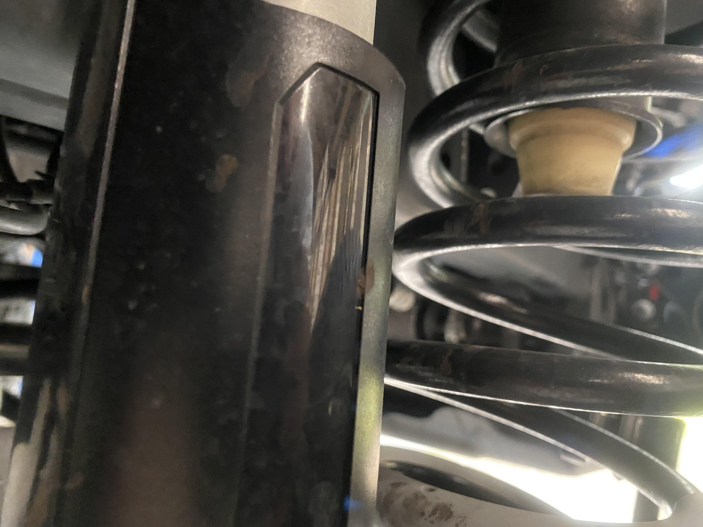

This past weekend I did a tire rotation and snapped the photos below. Interestingly enough I didn’t see the metal collar. I’m wondering if I bottomed out hard enough where it’s now stuck up in the tube…
