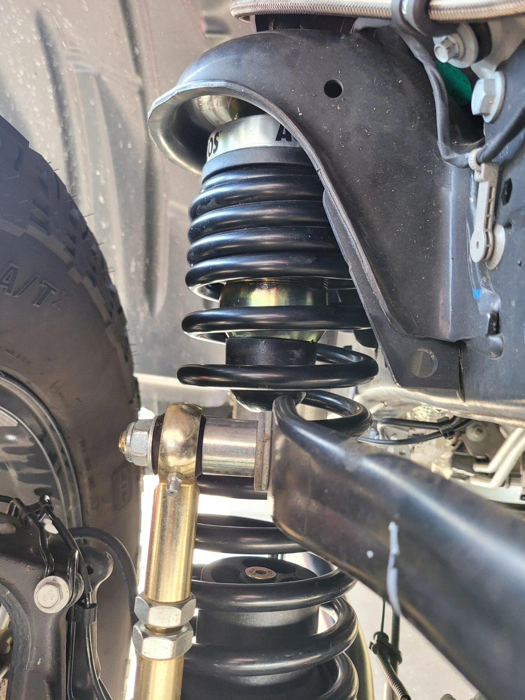

Have you tried to compress it? Looks like it would compress into the tube.
I did not, don't really have anything to pry it with atm. I did scratch it, it seems to be a denser poly/rubber than the yellow material. It did not push up by hand.
