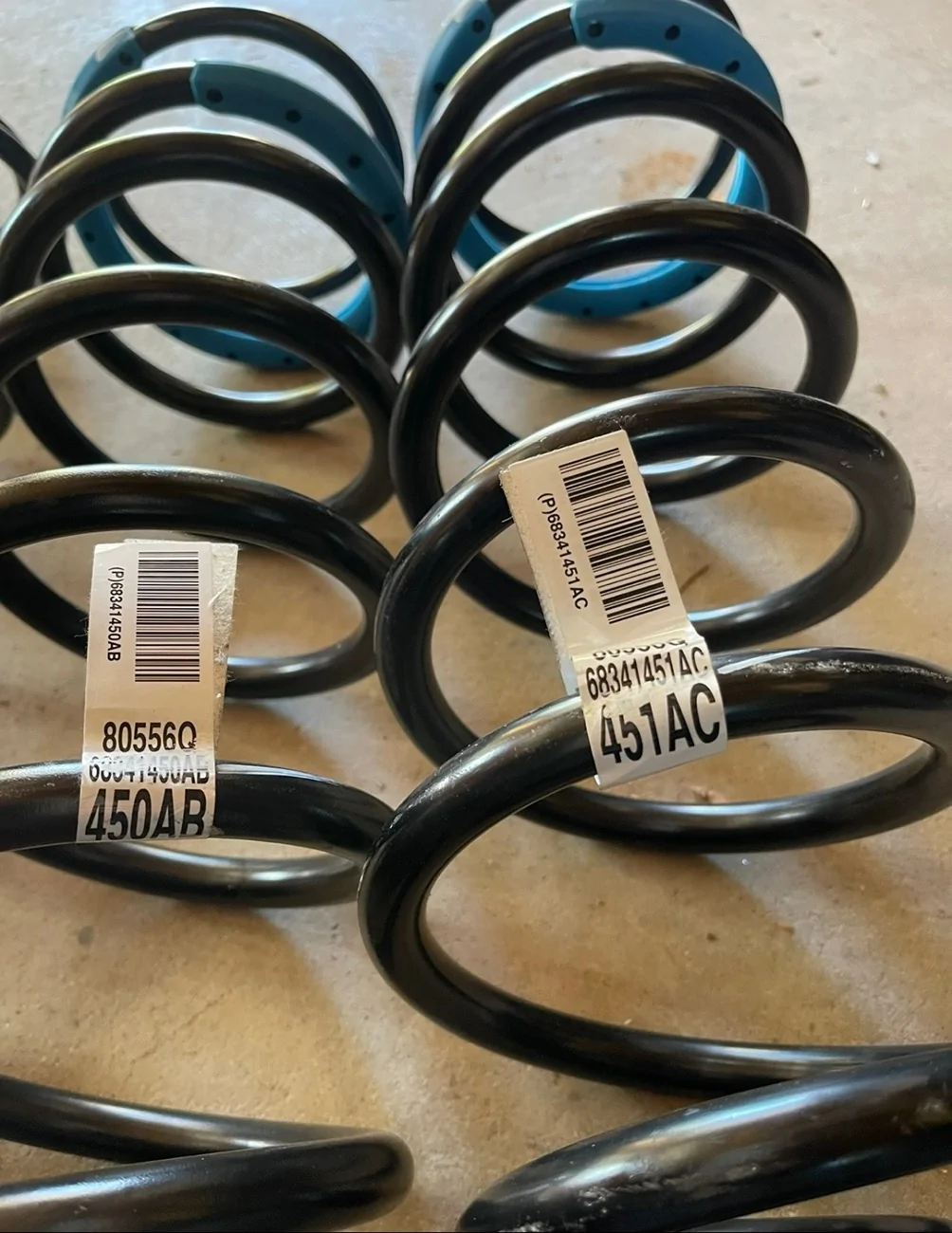

I’ve never seen this thread before, but I’ve posted pics of the spring numbers of my Overland with every available option’s springs and the take off Rubicon LE springs I basically immediately replaced them with. My overland springs were terrible which is why I replaced them immediately. I hated the floaty ride and sloppy handling and the towing and hauling were sad. The rubicon LE springs are night and day better. I’m still running them six years later. They’re ideal. They don’t ride rough, but the payload, towing, and handling are surprisingly great. I’ll have to search again for the pics. I can’t find them right now.

I have no idea, but if you know how the vehicle was optioned, it helps tremendously. The spring rate is based on the options and weight of the vehicle. The reason why I love my Rubicon LE springs is because the LEs had every available option including the steel bumpers and were super heavy.

As far as I know the spring numbers I posted are the highest for the gas rubicons, 340/343 so that would mean it had the steel bumpers.

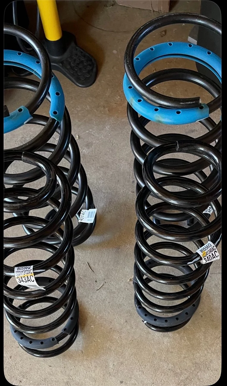

Found the pics of my spring part numbers. 2020 Rubicon LE spring part numbers.
Jeep Gladiator Coil Spring Part Numbers IMG_2047
Jeep Gladiator Coil Spring Part Numbers IMG_2049
Jeep Gladiator Coil Spring Part Numbers IMG_2048

My overland springs are in my garage attic. I can get those numbers. I saw that the rear spring numbers were missing.

I think you are still missing the point of my question. Are pre 24 rubicon springs any different than 24+ willys springs? Until sombody post 24+ rubicon spring numbers we dont know if they are the same as my willys ones

I just wanted to provide verified part numbers for rubicon LE springs since they’re amazing imo. It tows and hauls great. I towed and hauled regularly for five years with it before I recently retired it to fun/vacation duty. I pulled those Uhaul 6x12s all over the SE loaded down with heavy antique furniture. People often ask if I have airbags. I don’t.
Jeep Gladiator Coil Spring Part Numbers IMG_2979
Jeep Gladiator Coil Spring Part Numbers IMG_2573
Jeep Gladiator Coil Spring Part Numbers IMG_2634
Jeep Gladiator Coil Spring Part Numbers IMG_1950
Jeep Gladiator Coil Spring Part Numbers IMG_9467

I got to thinking about this some more today. If the truth is that 24+ willys and rubicons come with the same springs that would likely be both of them with plastic bumpers, no winch... etc. So I bet you a 24+ willys with a plastic bumper (mine originally) and then a 24+ rubicon with a steel bumper would not be the same and the rubicon with steel bumper will still have a higher rated spring than the plastic bumper one. So in theory me getting the pre 24 rubicon steel bumper springs SHOULD net me a change in some way. Just like they always have. I report back with results when I get them and we will all see what the deal is.
