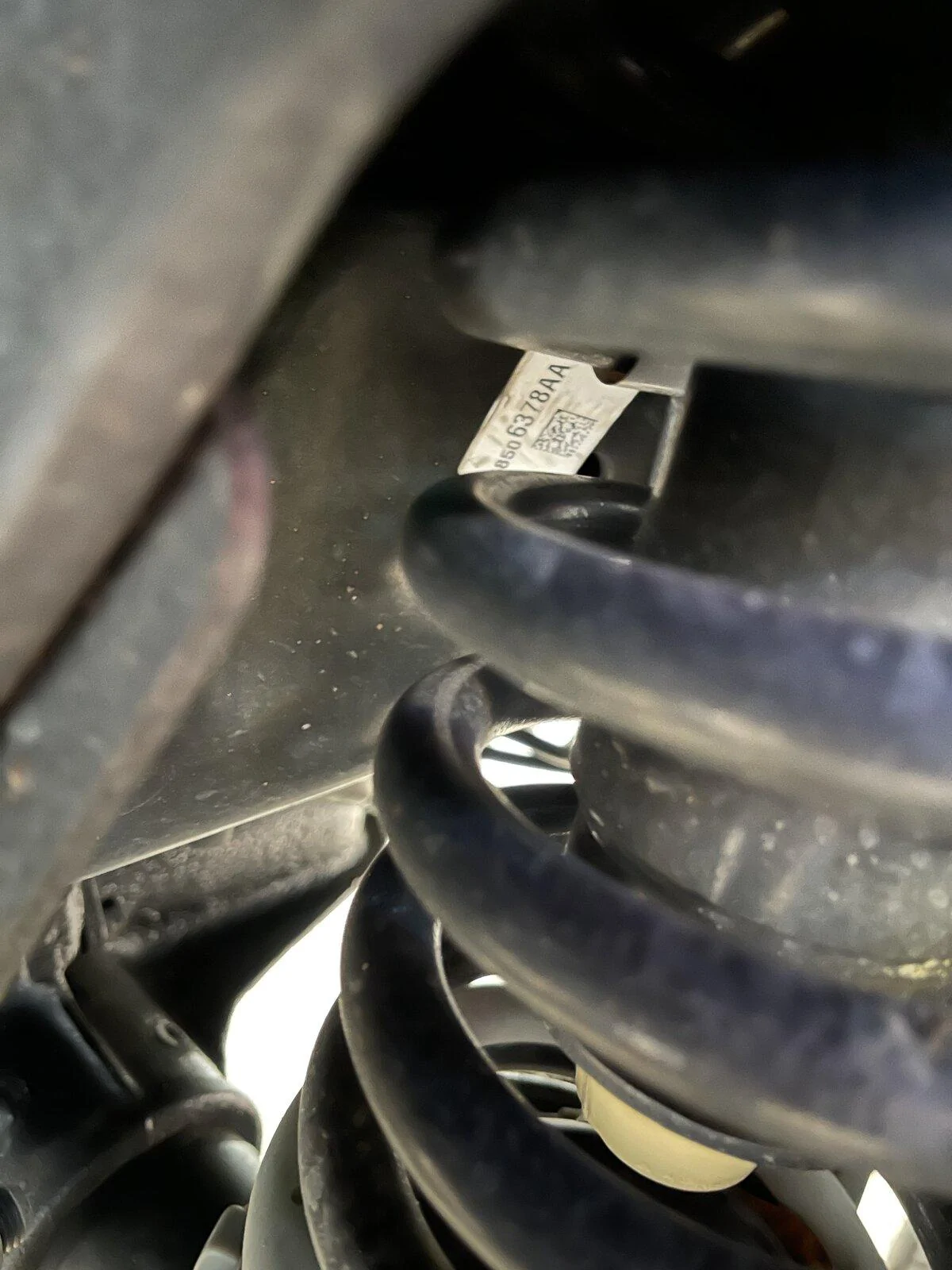

Mine (22’ JTRD) bottoms out with the inverse of this config:
Bottoms out - RF - 6378AA / LF - 6377AA
Meaning:
Bottoms out - RF - 6377AA / LF - 6378AA
@am1978 should I cast the vote to the first config still?
I think that’s expected since the part numbers are the same. Looks like the odd/even parts are on the wrong side, but result would be the same.

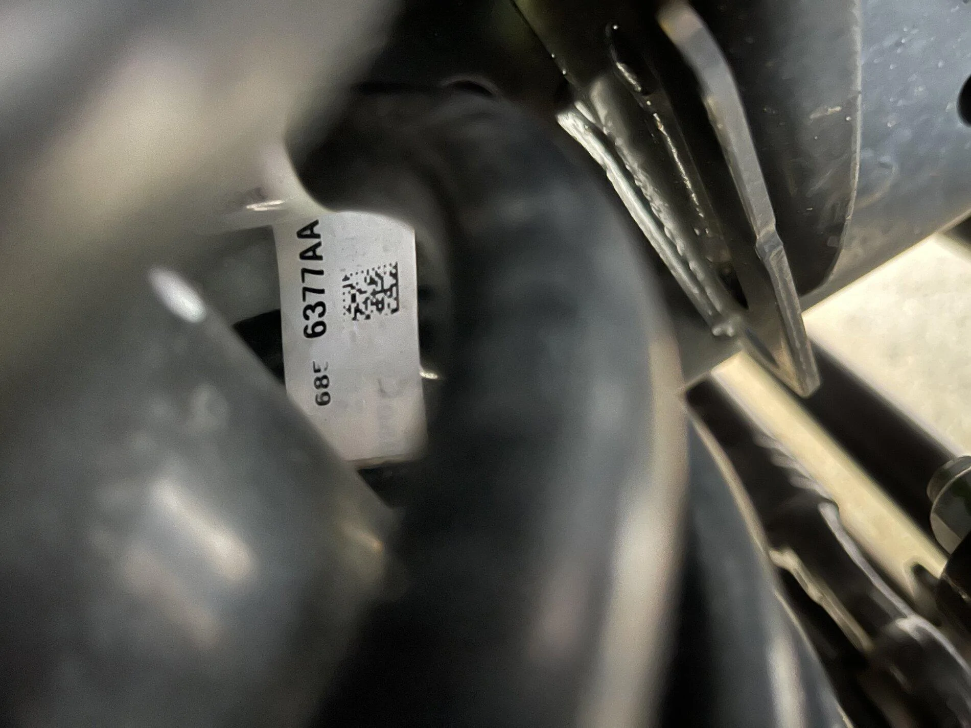

My Rubicon ecoDiesel is also swapped from the first vote option, and bottoms out very easily:
I have an appointment scheduled with the dealer on 9/7/22. I’m assuming, if I bring the TSB, it may help get them on board with the ā€˜fix’.

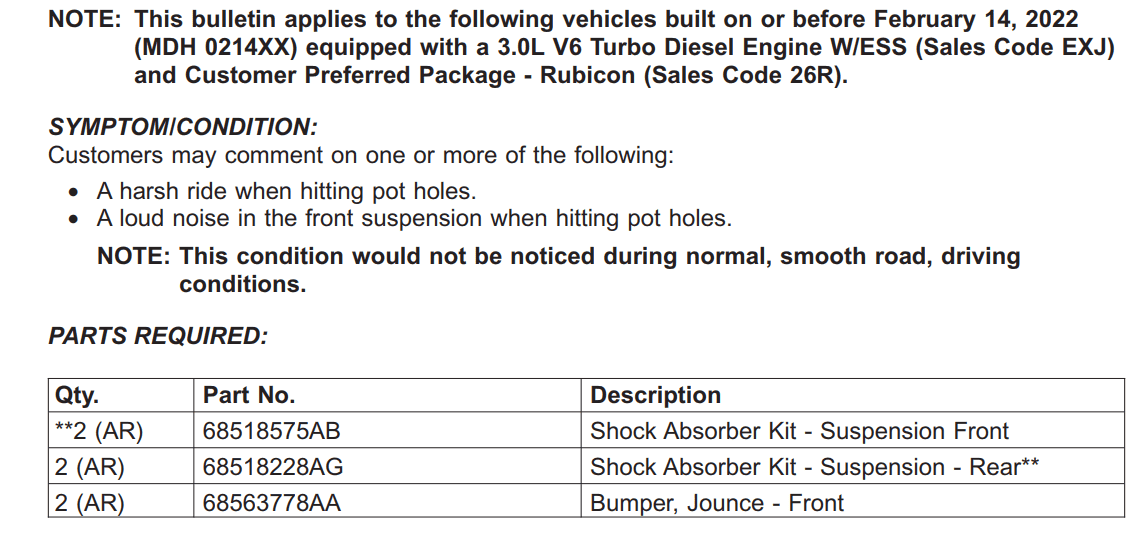

Those are stout springs compared to what's under some other Gladiators (*non-diesel)
The fix is 4 new expensive shocks and the bump stops. Won't take them long at all to replace those parts.

Had mine done a month and a half ago or so. The TSB fix did the trick.
To aid your position, look at the top of the bottom spring pad. Mine had impact marks / circular rust areas. I didn’t get any guff from the dealer.
Thanks- I was wondering about that. I took pictures that show the center, where the bump stops contact the bottom pad, is shiny / clean, while the rest of the pad is all dirty- pretty good proof that it’s making contact on a regular basis.
