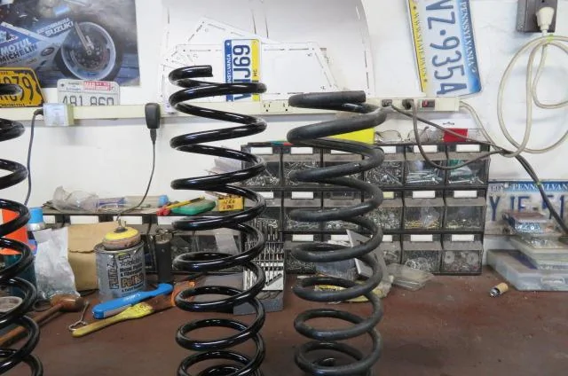

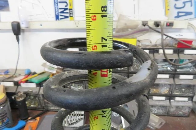

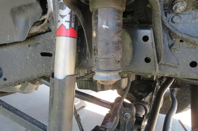

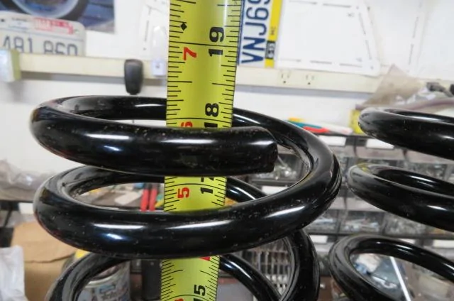

Ok, I got the proto Clayton front springs installed today. Standing side by side. The clayton springs are an inch taller. Same number of coils. Wire diameter for stock was 0.593. The Clayton's was 0.553. Last picture is what the '22 bump stops look like.
So stock was thicker coils? Interesting.
11,492
30,631
With the new coils installed. The front is up 1 inch, and the ride is a bit firmer. The wifey didn't notice the difference as a passenger.
