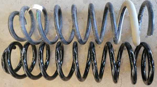

Here are the old and new springs side by side. You can see the new one is about an inch longer than stock at free length and that the bar of the spring is noticeably thinker. The old springs have 8.5 coils and the new one is about 11 coils. I will be getting numbers on this and doing some spring rate calculations based on spring geometry soon. I will report that here.

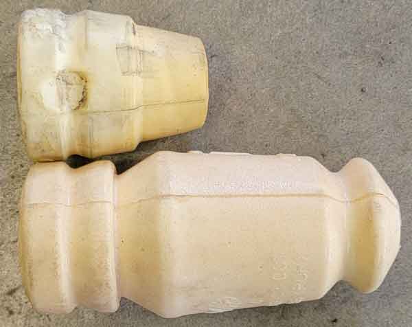

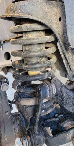

At the same time, I also added TeraFlex 1959200 Bump Stop and I think it is fairly clear why these are going to work a lot better. With the spring out it was clear that there had been significant metal-to-metal contact at the bump stop. The stock one only protruded from the tube about half an inch. I'd like to talk to the engineer (or his bean counter overload) that signed off on that.

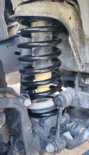

Initially, after putting the springs in and putting the truck weight on the axle, I could not even get it to come down enough to get the shocks connected and I had a moment of panic. I put the wheels back on and with it full sitting on its own weight it settled in better. I then had to push the shocks in about an inch to get them in position.
Down travel is clearly being limited by the stock shocks but I think that is how the stock setup was as well so it’s just doing it a lot sooner now. Up-travel is noticeably better. I hit a local pothole at speed and it just soaked it up. Before that would have been a crazy hard bottom event. Flex seems to be less than before. Again, I think the shocks are the problem here. The compressed spring is still partly open and the new bump stop is just kissing the pad. The uncompressed spring seems like it has a bit more to give. the bottom control arm was sloping up a bit from the frame to the axle and now it slopes down a bit. The steering was a little off the driver's side and now it is almost perfect. The ride is noticeably different with no load but I think it will be better once I get it loaded.

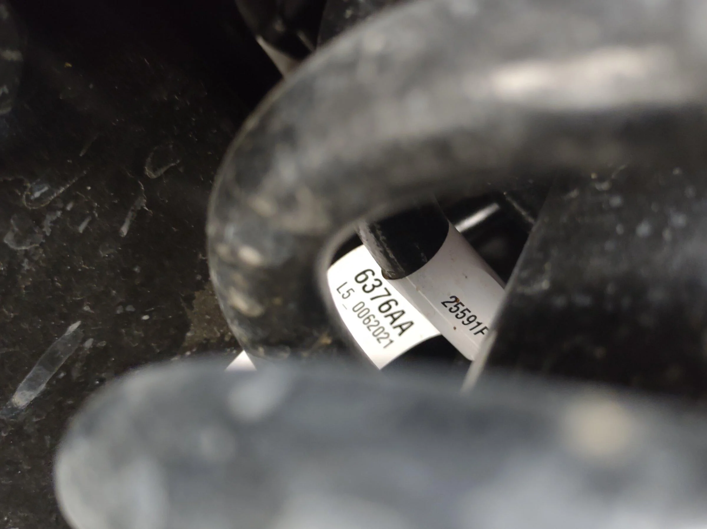

What's the part numbers on your stock springs? Curious if they are the same as mine. I have a Sport S Ecodiesel 21. Ordered in March of 21 and picked up end of April 21.
That is a fair question. I should look and see if I can read the tags. Stand by.
Looks like the one I have a picture of says 6377AA.

Both sides same numbers. When was yours built?
I did confirm that on the old springs, both sides are the same 6377AA number.

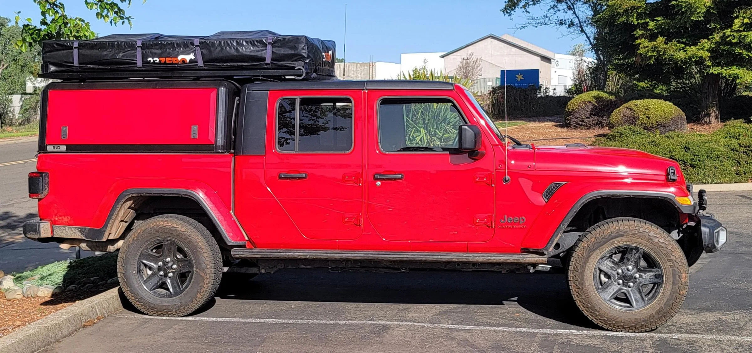

I have about 100 miles or so on the road now with the truck mostly packed for our trip including the RTT and I am still feeling like this has been the right move. Handling is way better. It does not have excessive body roll. The diving sensation under breaking is gone completely. I still need to add four people and their personal gear and then get some offroad miles under her to make a final assessment.
Jeep Gladiator Here is what I did about my diesel bottoming out. 20220406_092528
The back end seems to be sitting a bit lower than the front for now. I am at 55 in the airbags in this picture. I may add another 10 and see how she does.

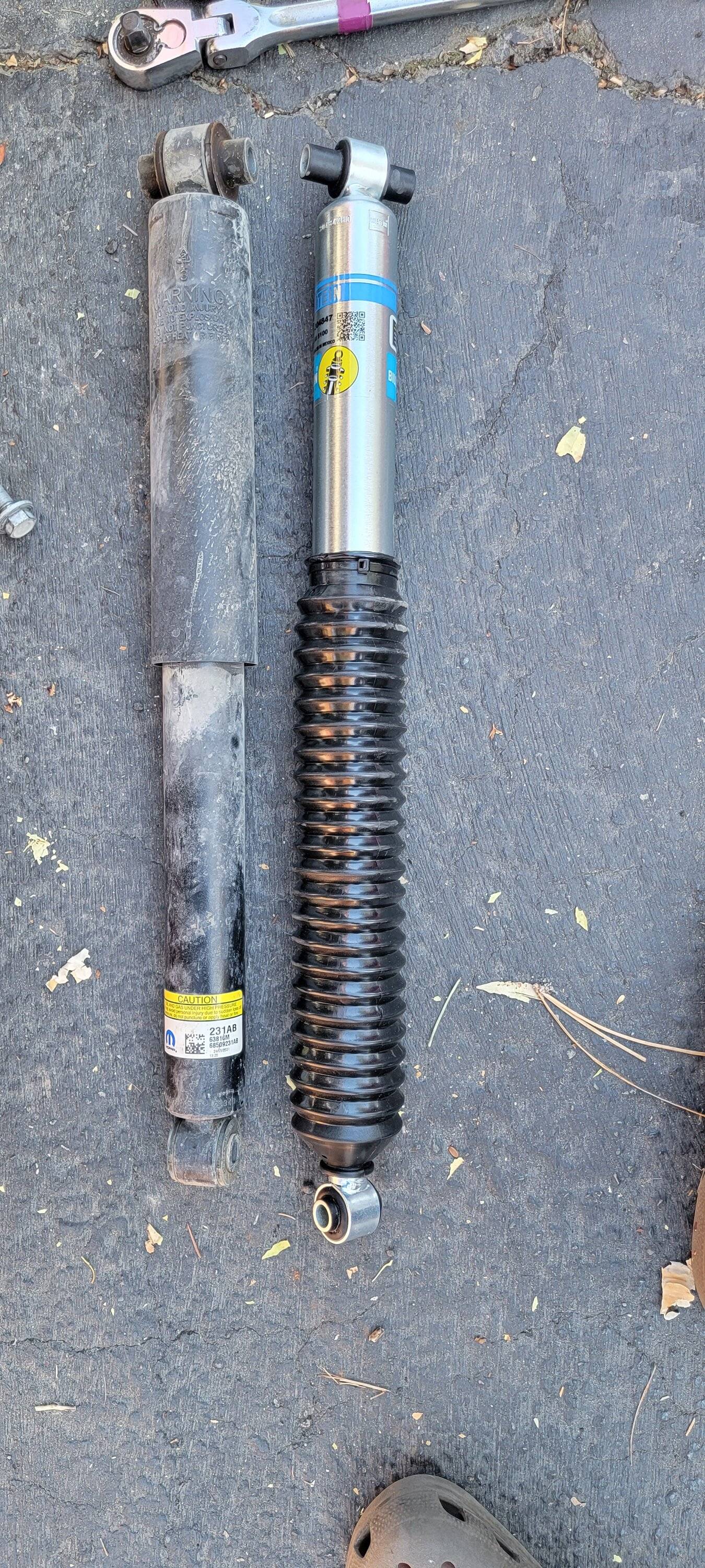

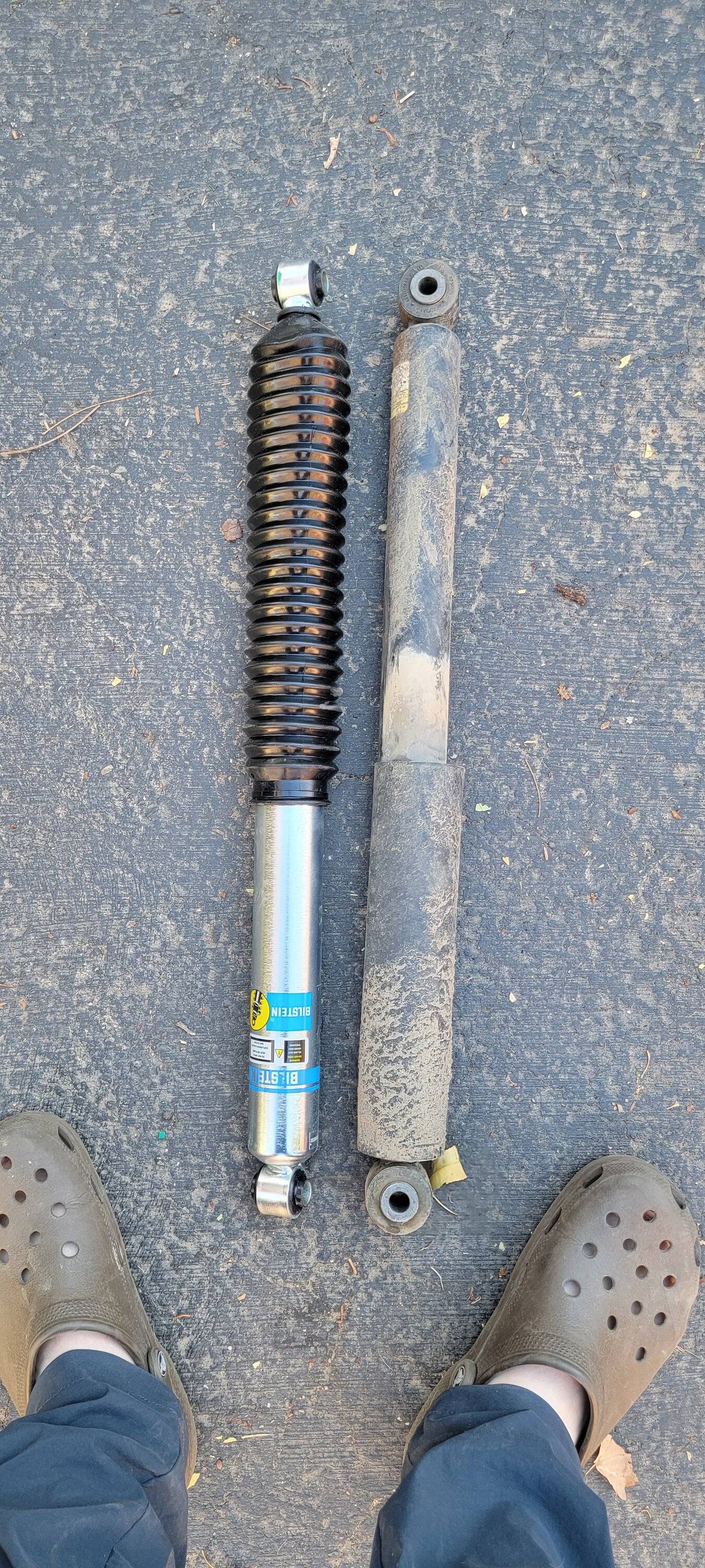

I added Bilstein B8 5100 - Shock Absorbers
Part Number:bilstein 33-304847 Position: Front -For Front Lifted Height: 0-1.5" Collapsed Length (IN)15.75 Extended Length (IN)24.73
Part Number:bilstein 33-304854 Position: Rear -For Front Lifted Height: 0-1.5" Collapsed Length (IN)17.22 Extended Length (IN)25.87
Magic! It no longer feels under-damped. The ride is more sure off-road. Maybe it's a bit on the harsh side on pavement, but the handling feels better. Body roll is markedly better as well. She is no sports car but handing no longer feels sketchy.
