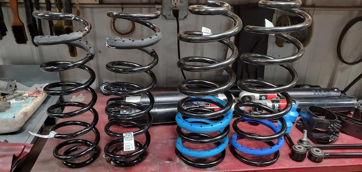

Here's my original Overland rear springs - and look at the closer coils on the end at the top of the photo -
Jeep Gladiator Coil spring part numbers 20200728_115640
Now here are Rubicon springs - note the closer spacing at one end, and the fatter wire at the other end -
Jeep Gladiator Coil spring part numbers rubicon-suspension-2
Now here are max tow rears -
Jeep Gladiator Coil spring part numbers JT-mt-springs-2
Gee, they all have a certain varied spacing between the coils - and look at the Rubicon spring wire, fat at one end less fat at the other.
Could you have told by looking if I hadn't said which was which - which springs came from what level JT?
