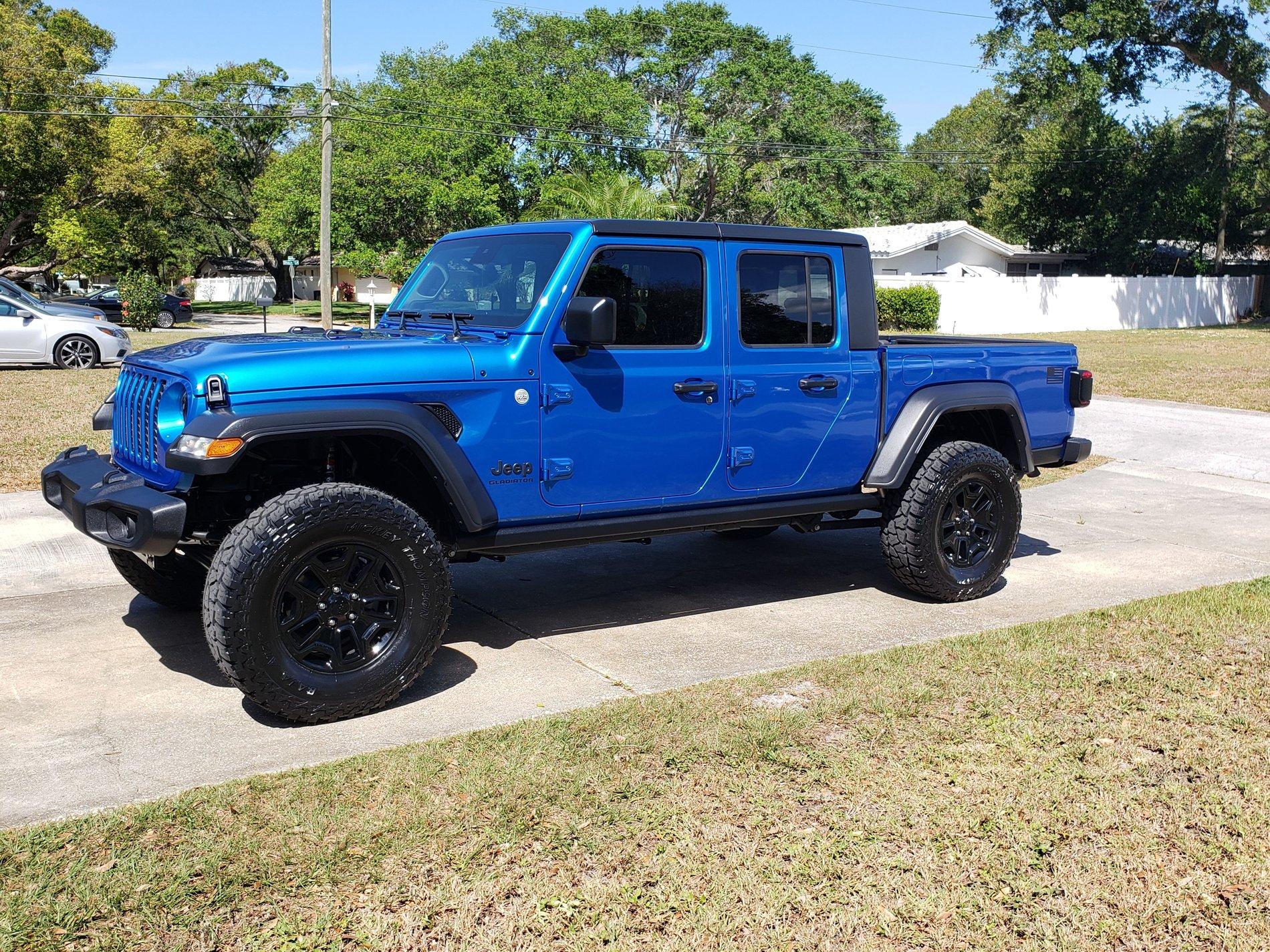

Just wanted to update with a couple of photos. I went ahead and put the Rubicon springs on all the way around. Did some lite wheeling this weekend and it did fine, but I do notice a "Squishy" feel when going over dips or general driving around town. I am thinking about swapping back in the rear max tow springs to see the difference.
FYI it looks like it's squatting in the photo, but my driveway has a crown shape and it makes things look weird in photos. I plan on a new bumper and winch so the front will drop more once those are installed.

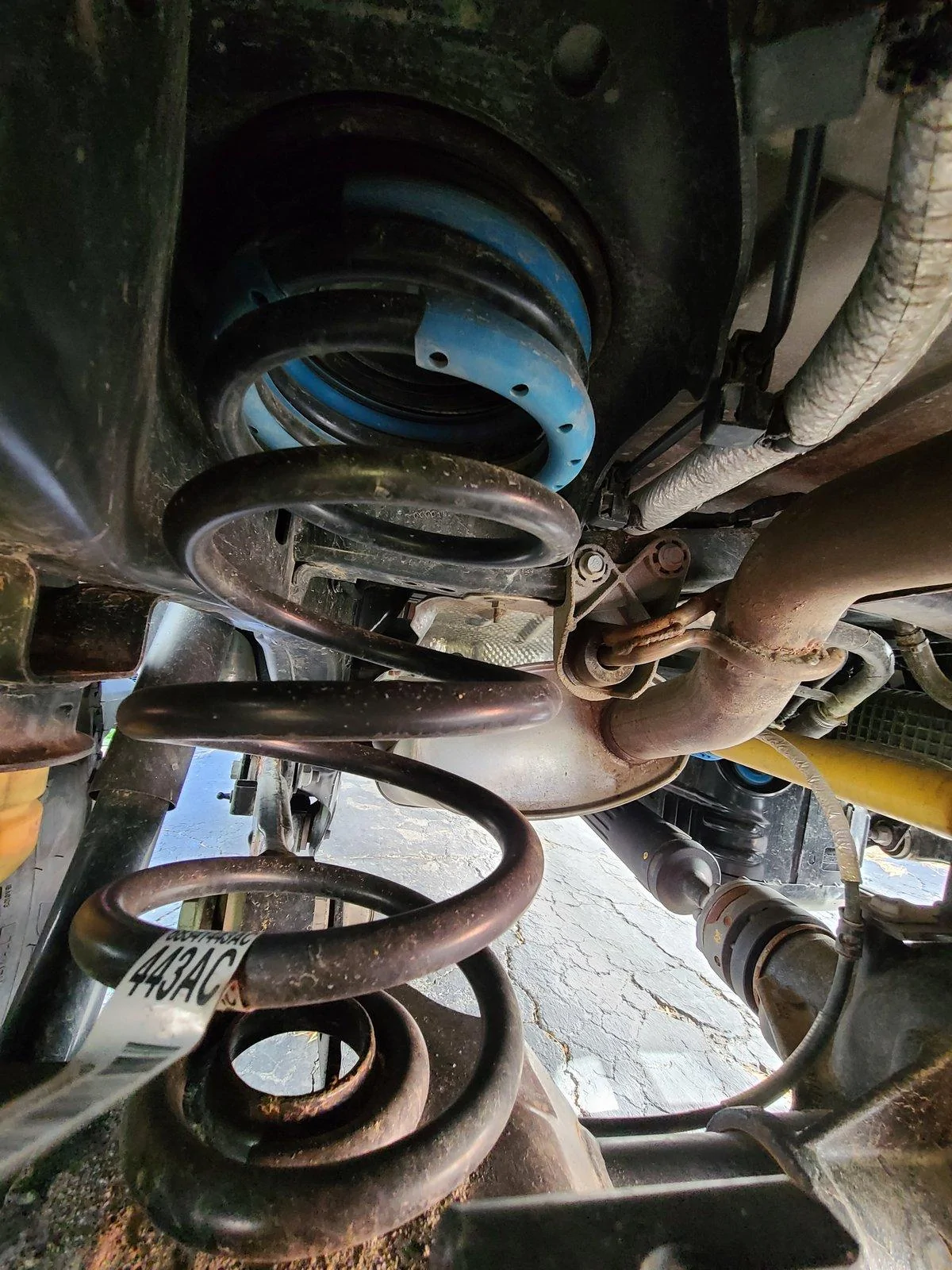

This is the tag on the passenger side rear coil spring from a Max Towing model.

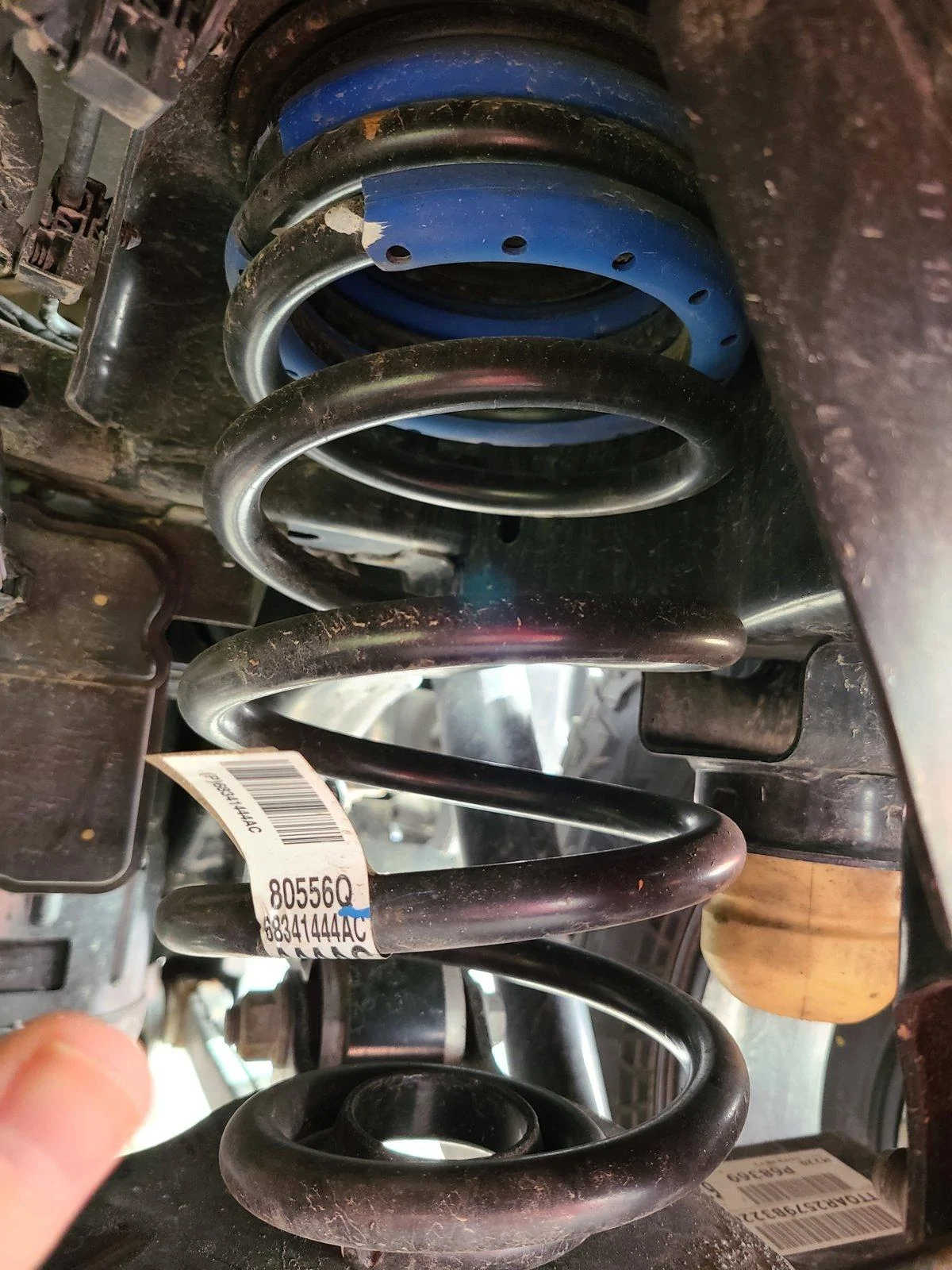

Here are my springs
68341444AC rear passenger
Jeep Gladiator Coil spring part numbers 20201008_133212
68341443AC rear driver
Jeep Gladiator Coil spring part numbers 20201008_133418

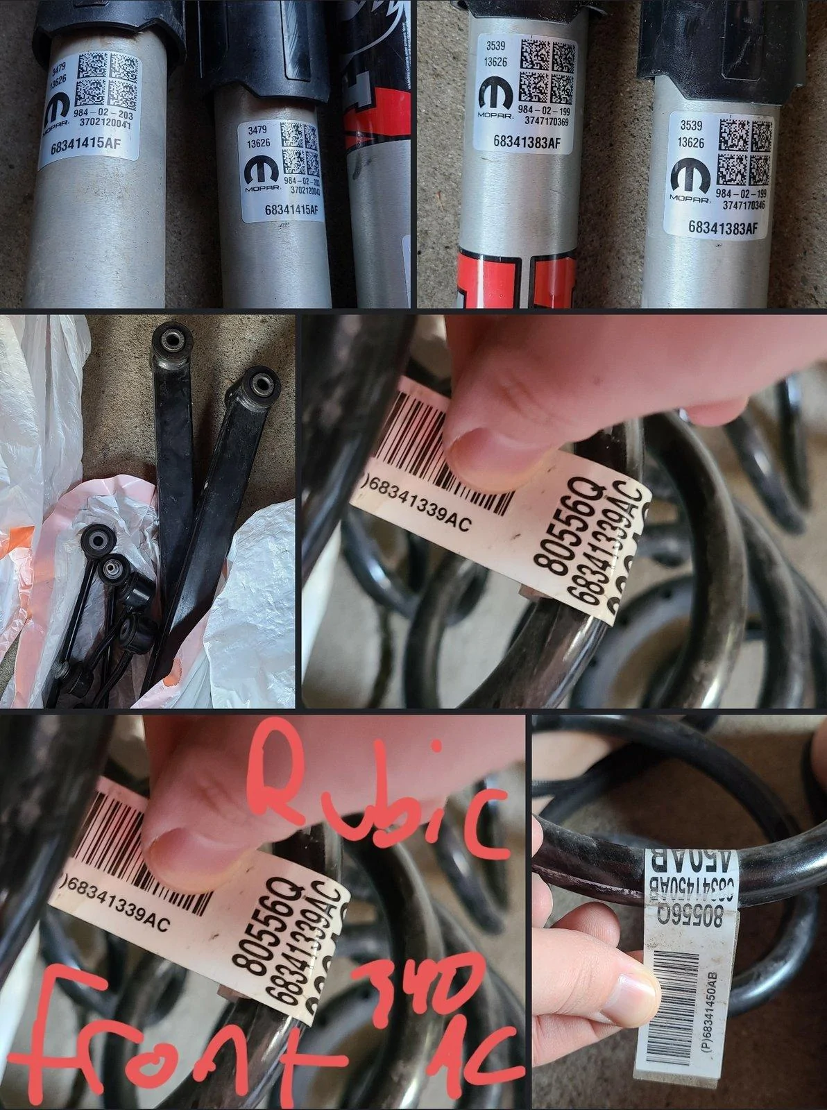

I was given a full set of Rubicon take off suspension
Jeep Gladiator Coil spring part numbers Screenshot_20201008-235450_Photos

So I have the "Max Payload" version, manual transmission, no tow package.
1700lbs of payload (747kgs specifically on the door sticker)
Here are my springs
Can anybody tell me more about these max payload springs?

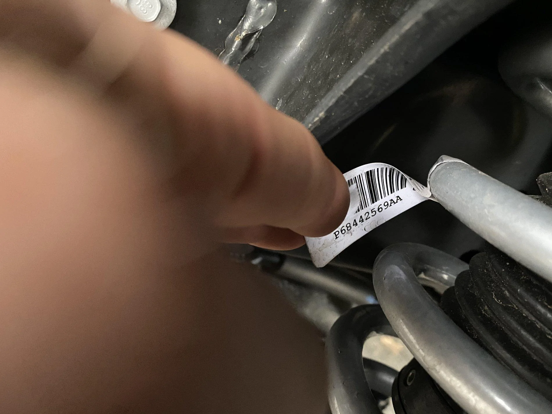

Does anyone have the part numbers for both rear springs on a max tow? Wanting to upgrade my sport S to increase stiffness in the rear. Looks like the passenger rear ends in 445AB but I can’t find the drivers side part number.

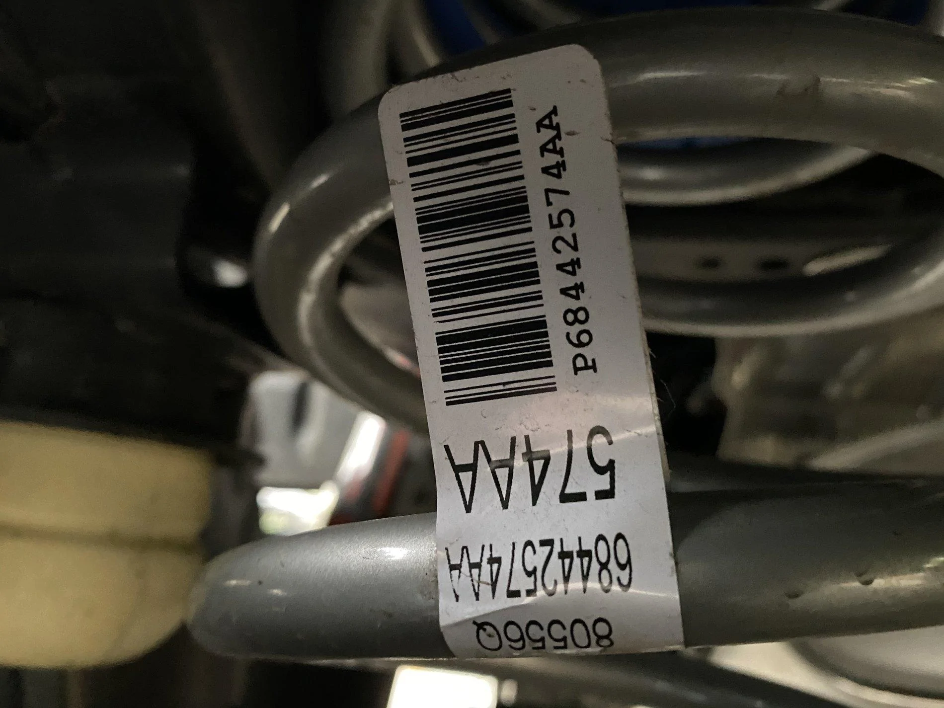

S/C Mojave
Only Fans Content Creator

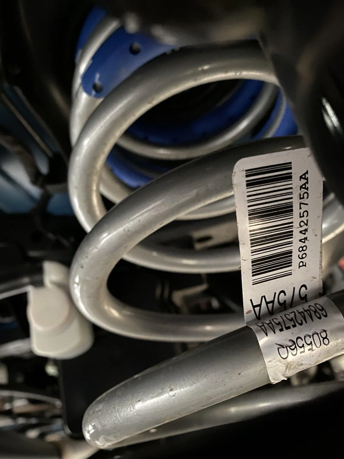

Mojave springs for any who care. Driver side front ended in 570.
Jeep Gladiator Coil spring part numbers BCA79D91-290C-46FC-A9FE-96964B09E438
Jeep Gladiator Coil spring part numbers F06C6047-987E-490A-AE62-4F4C40C7B159
Jeep Gladiator Coil spring part numbers A44F149A-095B-4402-9B82-7BA941D6E8C5
Max tow rear springs I put under mine -
444AB for driver/left side
445AB for right/passenger side
