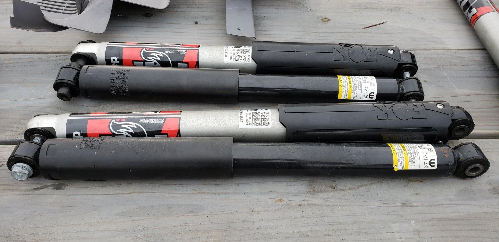

Sport S and Rubicon Shocks are the same length. However most of the up travel of the Sport S shocks is used-up/wasted because the stock springs are too soft.
You can swap Springs only if you want. But you remove the shocks as part of the swap so might as well swap shocks too.

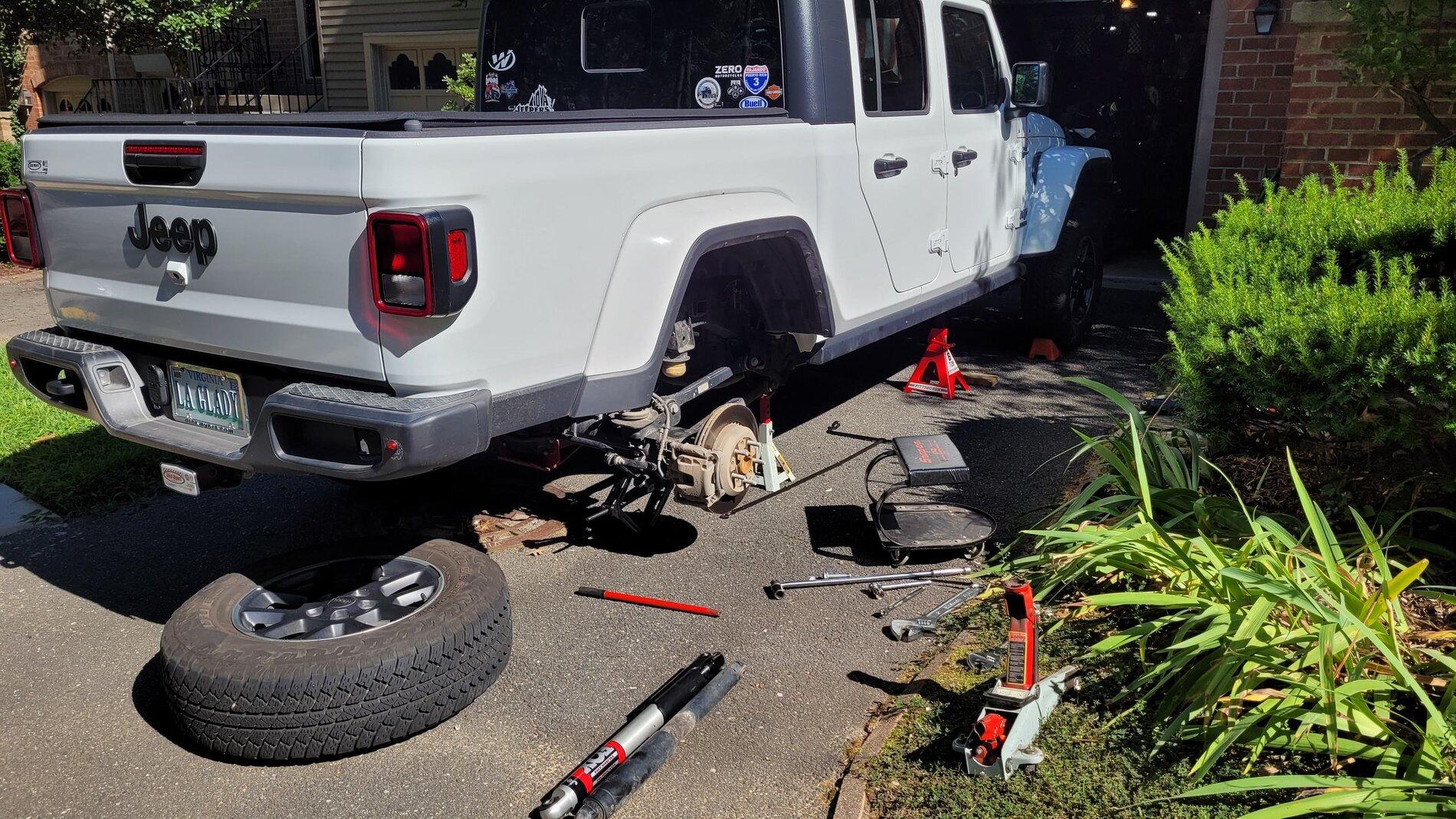

I did the swap by myself in my driveway using the stock scissor jack and lug nut wrench and some stands. Rear was shocks only, front springs and shocks. Easier with 2 or more people.
