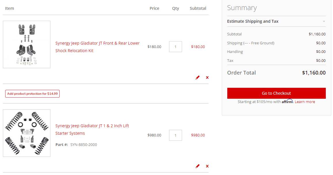

Yes, my experience is based on a rock krawler system that i was at about 3k for everything to make the system work together. (track bar, front lca, good shocks, springs, rear track relocation bracket, sway bar links, bump stop blocks). I am not a fan of spacer kits.
How is the kit? Are they dual rate springs?
rharr
May 6, 2021
29
2,151
2,945
Tucson, AZ
I have been happy with the kit, it's been problem free, drives well, installed it and haven't had to mess with anything. No death wobble, rides smooth and goes straight. Stock drive shafts, stock drag link, tie rod and stabilizer.
I got the 3" non-adjustable kit cause i didn't want 1 more thing to mess with and didn't need that extra little bit of flex.
The springs are triple rate.
If you are going to keep things in the bed, then see if you can order 4.5" rear springs instead of the 3.5" springs, the 3.5" rears will sag if you keep +200lbs in the back. (I have a topper and some tools back there)

I'm looking at having the 1.5" front springs to replace my stock ones. Comparing Rock Krawler to Synergy.
