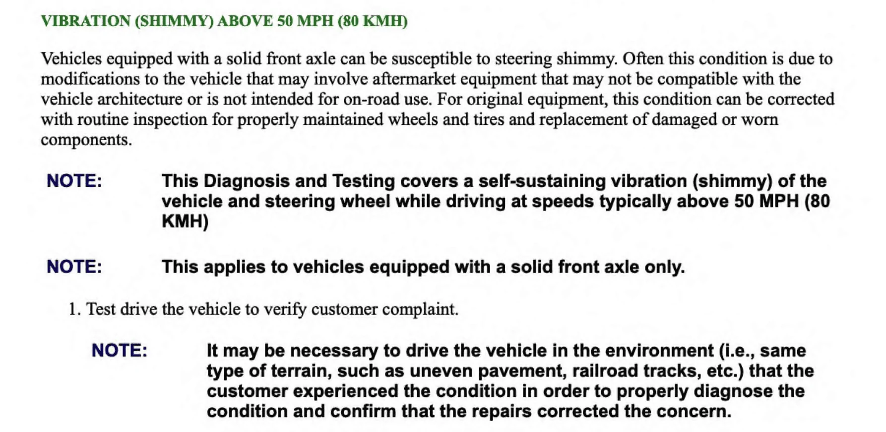

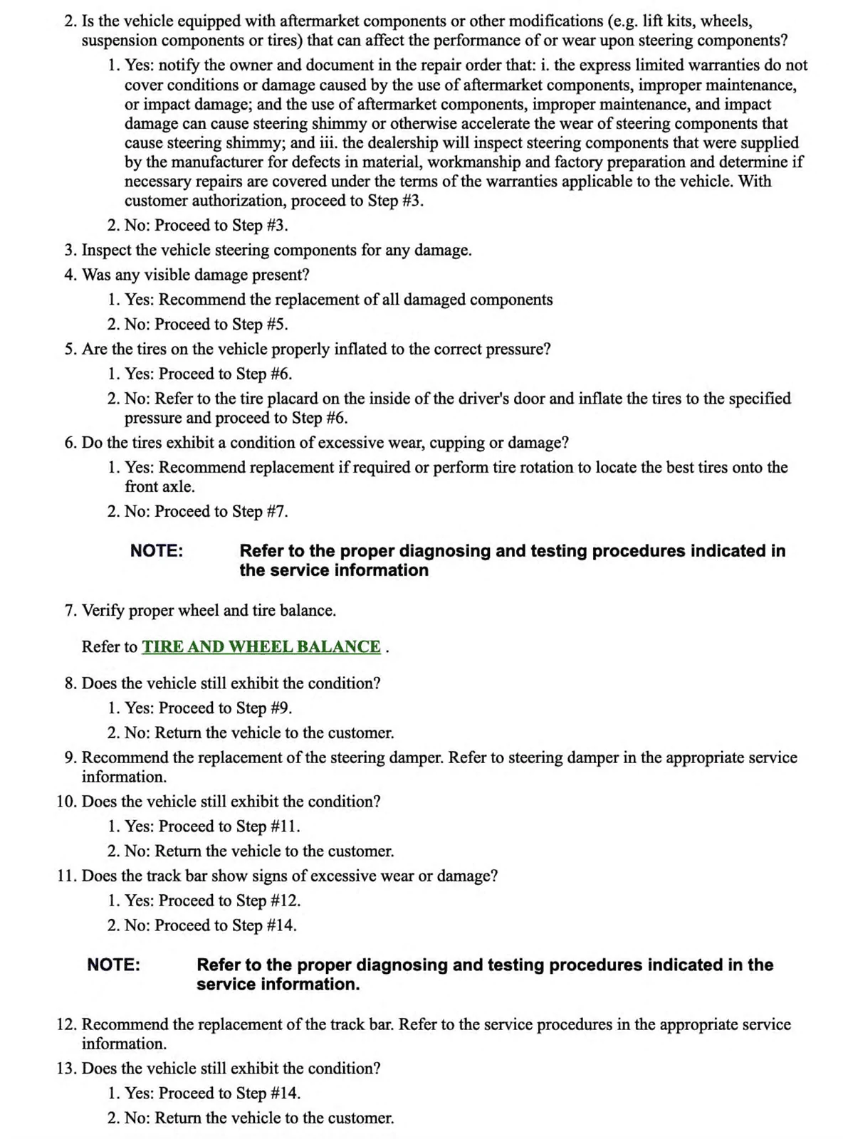

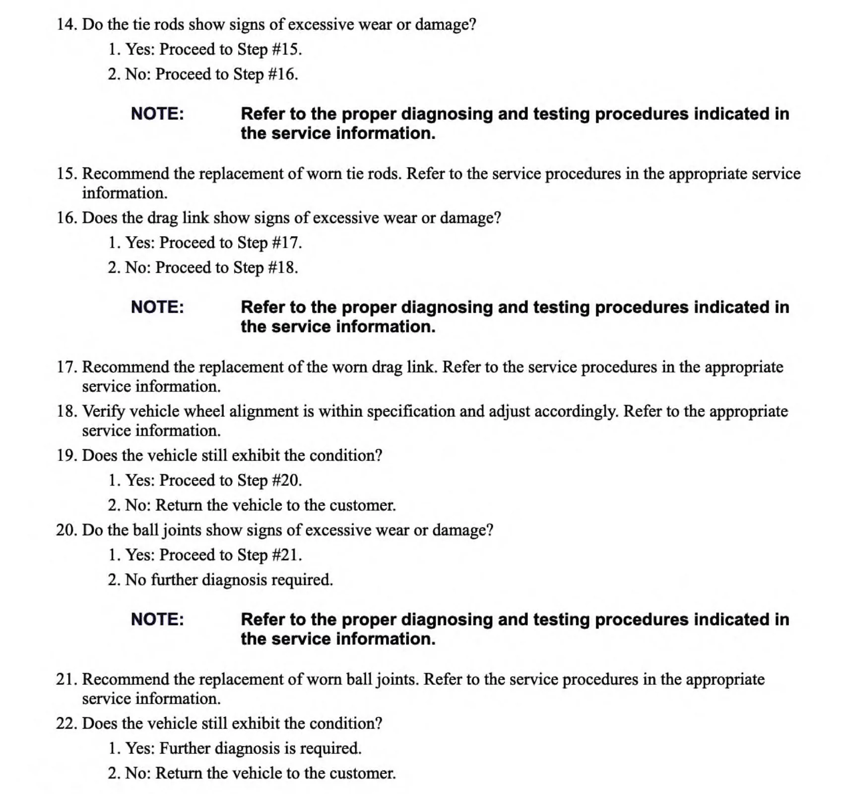

I thought this would be a good place to post this information. It is from the 2020+ Jeep Gladiator (JT) Service and Repair Manual, DIAGNOSIS AND TESTING, STEERING SYSTEM DIAGNOSIS CHARTS. What I find interesting is that it goes through the steps that the dealer is supposed to follow when diagnosing vibration/shimmy and I assume wobble issues.
