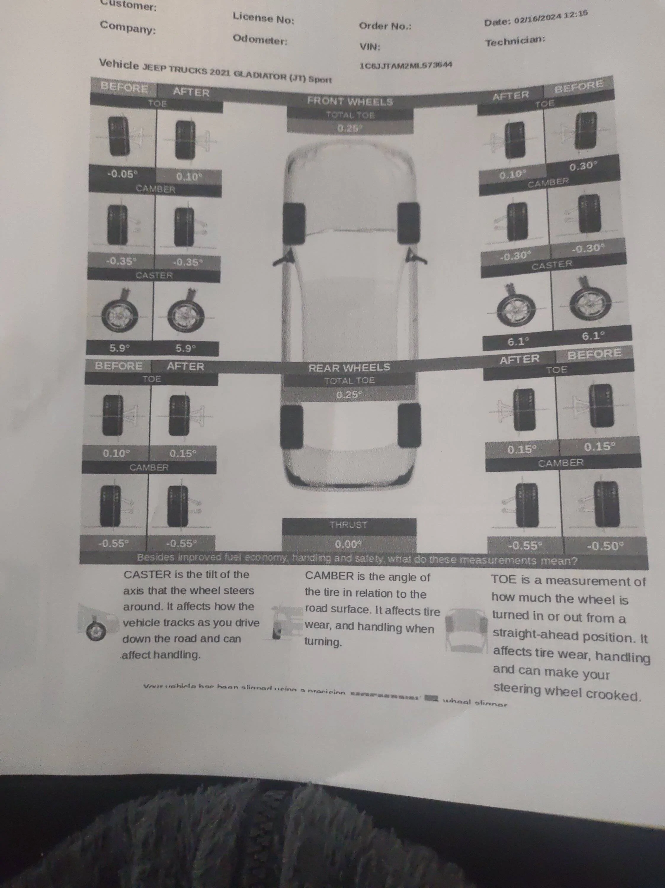

3.5" lift and it looks like you have quite a bit of negative offset. You've moved a lot around.
That said, if it was an issue before the lift and tires, then I'd be looking at components again.
Steering gearbox bolts, Pitman arm nut, ball joints, trackbar, bearings... literally everything from the steering column the where the tires meet the road.
Did they give you a printout of your final alignment?
They went through all of that complete full nuts and bolts check. Loosened retightened and marked ball joints are good. They're fairly new. I do have to print out of the alignment. I can post it later tonight

I'm still struggling with the wobble. I just had it aligned. Less that 10 miles on current alignment. Everything has been torqued. Tires balanced again. Next try is the Metalcloak sector shaft brace. Lots of good reviews on their setup. Notice anything out of the ordinary? 48k on the odometer

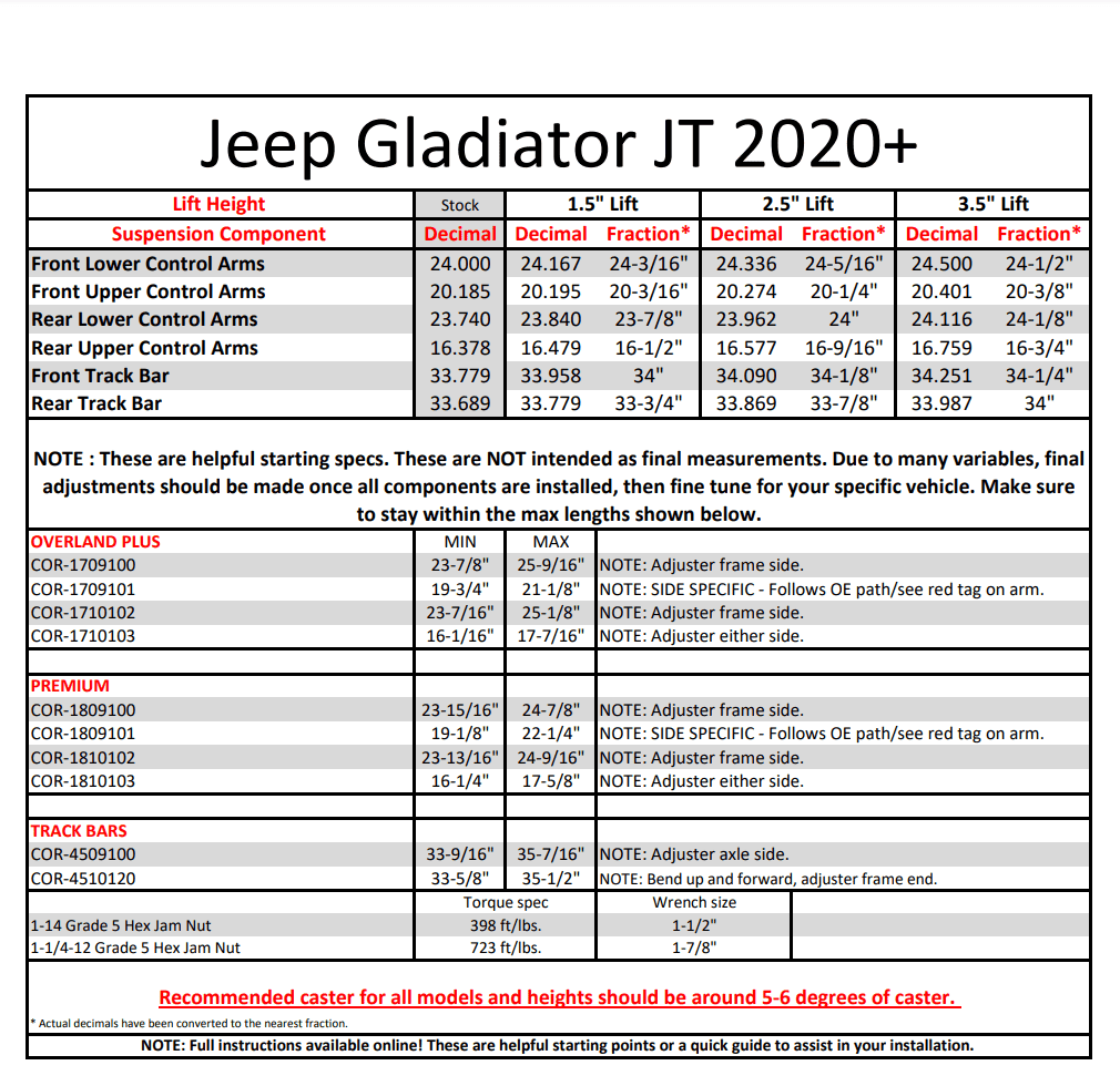

Beating a dead horse here. What caster are most people running on a 2.5 lift? Mines Clayton 2.5 overland. If I adjust the LCA out half a turn and the UPA in a half turn. Is that the same as one full turn on the LCA? I'm at 5.9 and 6.1 on caster.

And here's the chart for your lift.
I wonder how much a 1/16th inch is on degrees of caster? 24 5/16 passenger side. 24 1/4 drivers side. LCA although didn't measure the UCA. Might take into account the difference in caster some. 5.9 on DS and 6.1 PS. Could mean the difference between degrees of caster and death wobble. Being as it seems to happen almost always when I hit a bump on the DS of the truck.
