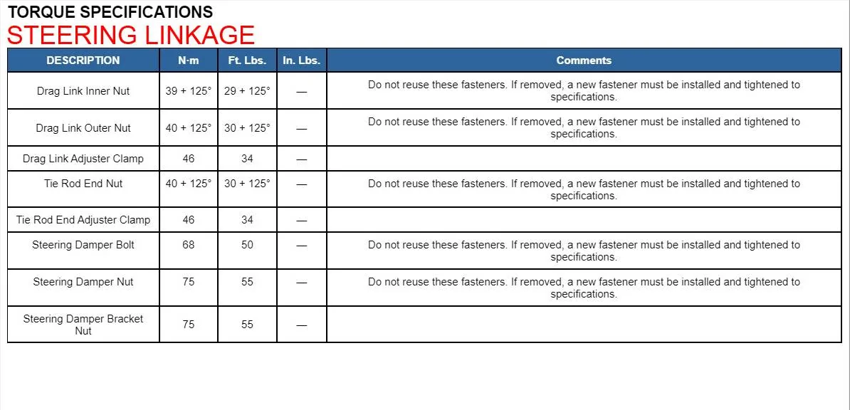

Check ball joints, tie rod ends, drag link, track bar, sway bar links, wheel bearings, steering gearbox bolts, pitman arm nut, and every other nut and bolt you can see for proper torque.
Does the tie rod end nut = the nut on the ball joint that is on the end of the tie rod that goes to the steering?
