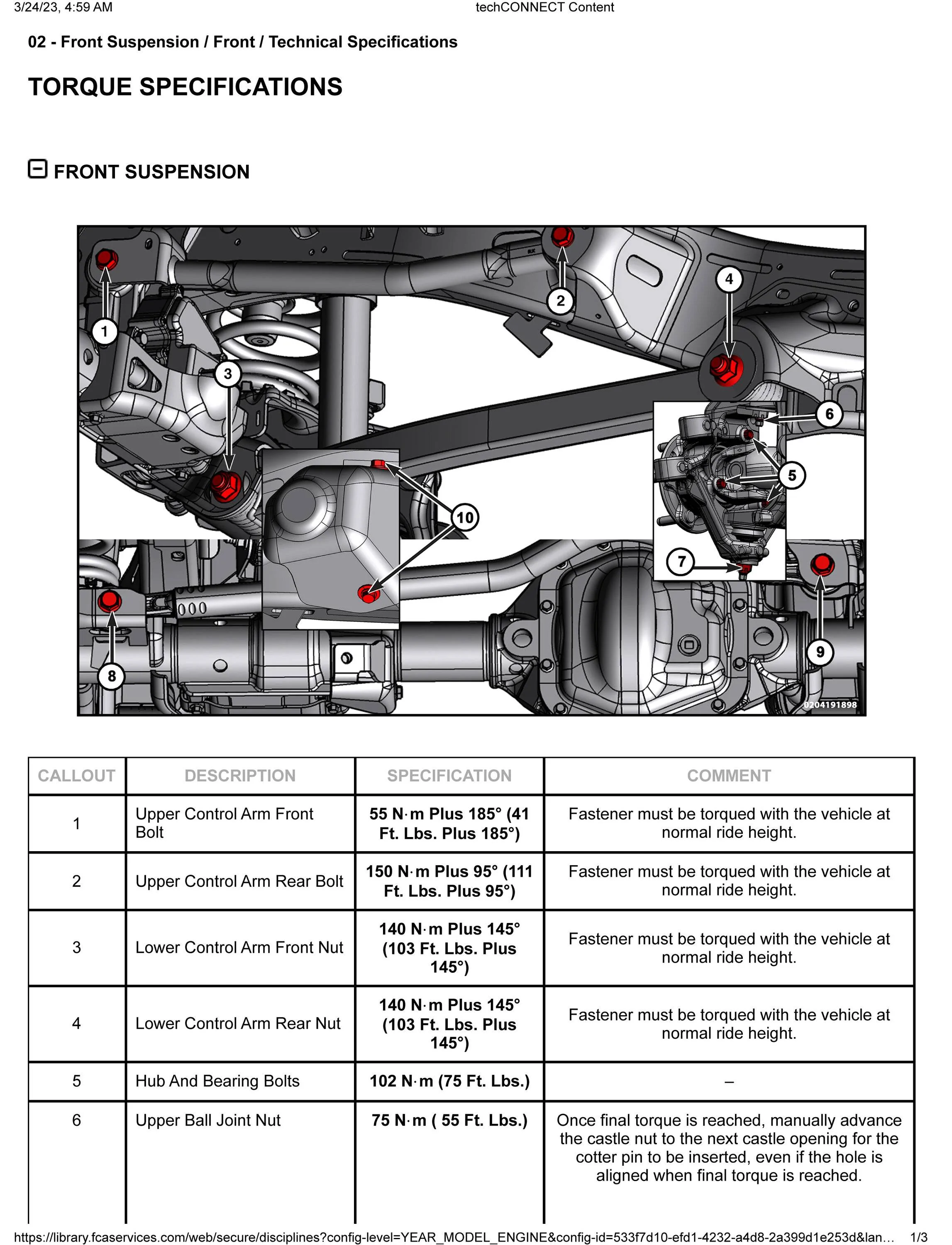

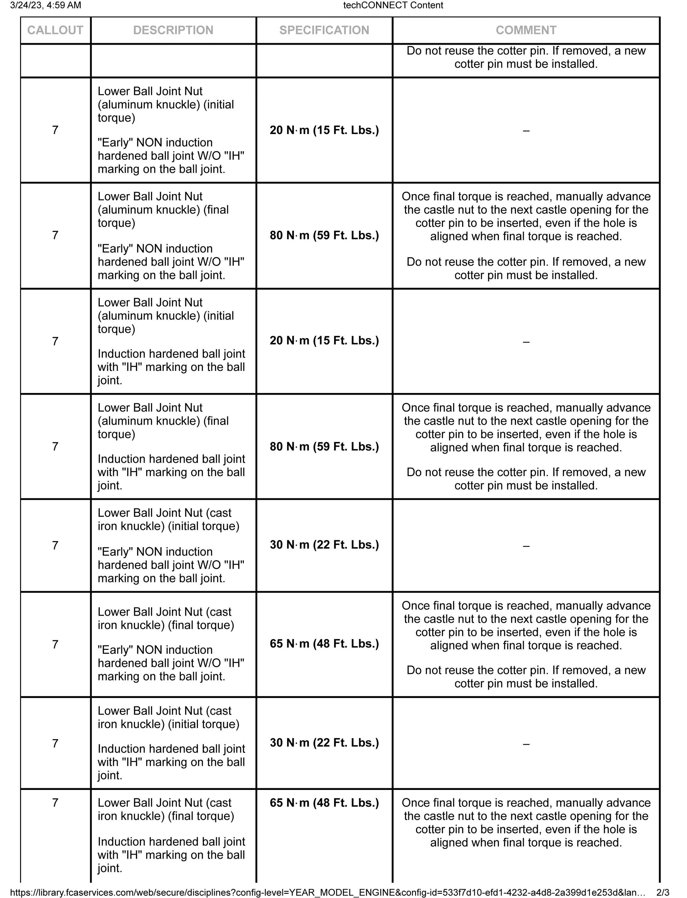

You may want to clarify that TSB 02-004-21 does not apply to the Mojave.
Confirmed - cast iron knuckles take less ugga-duggas on the ball joints.
Jeep Gladiator Death Wobble, DW, Death Wobble, DW, Death Wobble, Shimmy, Wander, Drift, Bump Steer GB
Jeep Gladiator Death Wobble, DW, Death Wobble, DW, Death Wobble, Shimmy, Wander, Drift, Bump Steer 2021 Front Suspension-1
Jeep Gladiator Death Wobble, DW, Death Wobble, DW, Death Wobble, Shimmy, Wander, Drift, Bump Steer 2021 Front Suspension-2
I had him pull up the 2023 specs to compare as well.
Jeep Gladiator Death Wobble, DW, Death Wobble, DW, Death Wobble, Shimmy, Wander, Drift, Bump Steer 2023 Front Suspension-1
Jeep Gladiator Death Wobble, DW, Death Wobble, DW, Death Wobble, Shimmy, Wander, Drift, Bump Steer 2023 Front Suspension-2
40,514
54,044

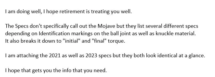

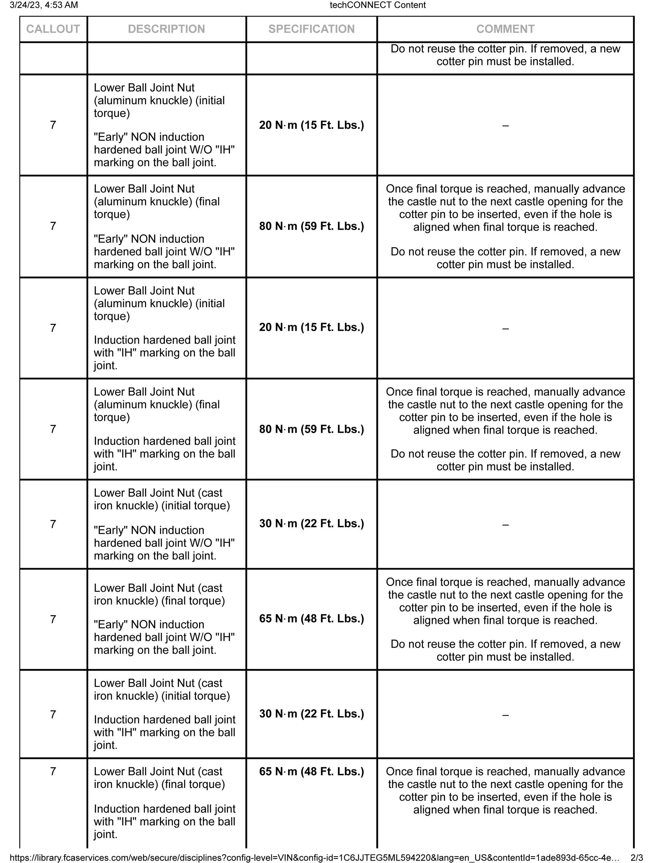

Yup - nailed it!
There's not only steel and aluminum knuckles, there were two different ball joints used over time.
Mine were screen shots the service advisor at the dealership gave me and unfortunately he didn't know how to really do a screen shot, so took pictures with his phone and we know how well that works sometimes. It was mostly usable, but really fuzzy.
Hey, it was free, so I didn't complain. He was doing me a favor he maybe wasn't supposed to do technically speaking.

Thanks for getting this info.
This is an interesting note:
"Once final torque is reached, manually advance the castle nut to the next castle opening for the cotter pin to be inserted, even if the hole is aligned when final torque is reached. "
I don't ever recall seeing a taper-fit castle nut torque stating to advance to the next castle slot even if it is aligned at the specified torque.
@ShadowsPapa , have you ever seen that?
40,514
54,044
I don't recall ever seeing that but now you have me curious so I'm going to hit my books and see if I see that anywhere in the resources on my shelves.........
