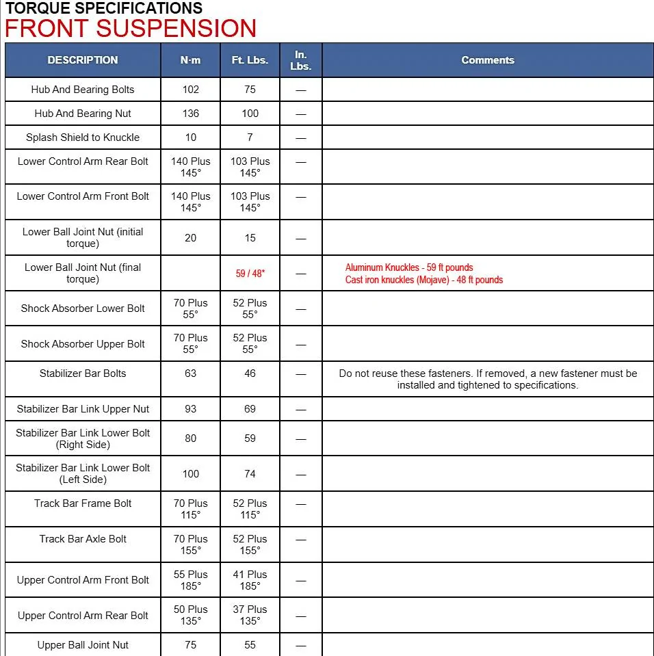

Took it in for alignment and found out the toe in was off and had couple of loose nuts on the front lower control arm including the jam nut. He tighten that up but couldn't get to the 190ftlb. Got home and retighten all nuts and bolts for the steering and suspension. There's no way I can get the 190ftlb torque either.
THAT is why they also publish Ft. Lbs plus degrees in the specs.
It not only allows for the use of a lower range torque wrench, but it could also save a trip to the ER.
https://www.jeepgladiatorforum.com/...torque-values-all-of-them-in-one-place.67915/
