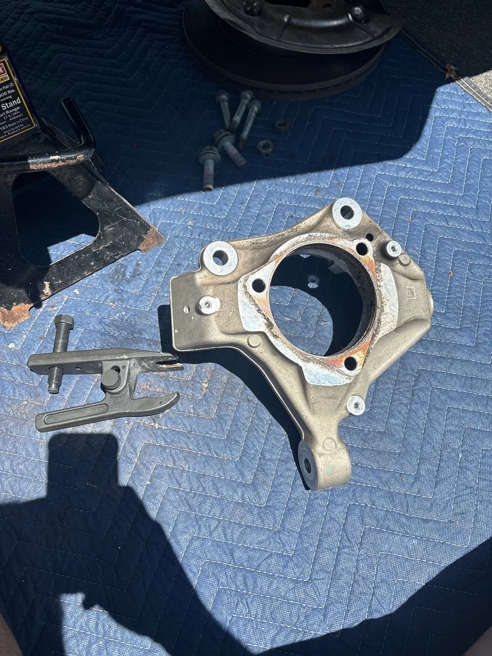

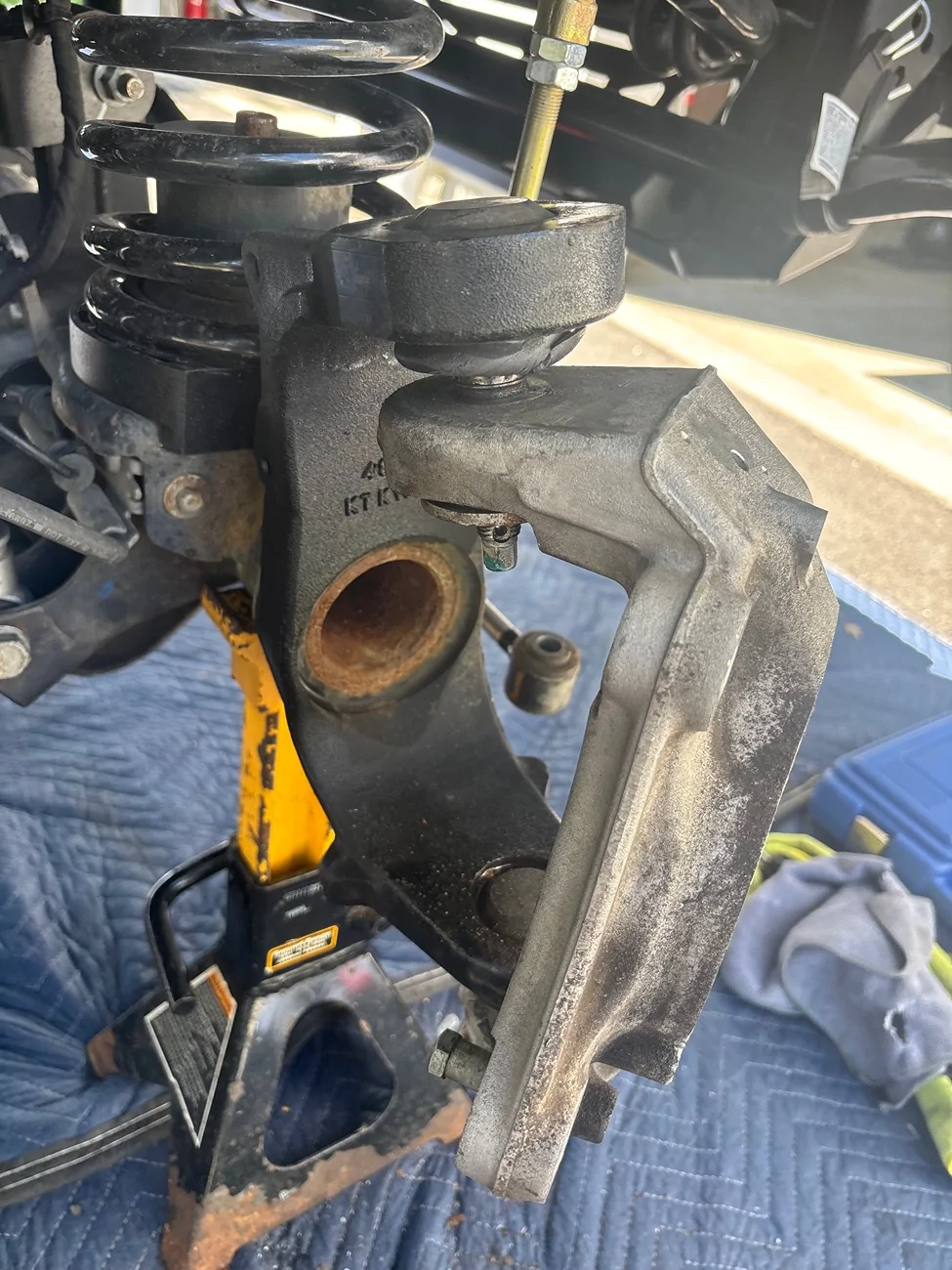

Decided to replace the ball joints instead of the road force balancing since ball joints seem to be a common issue.
Local shop likes Teraflex but charge $1700 installed. I saw dynatracs being popular as well. I went Teraflex. Install sucked. Knuckles would not loosen and the new ball joints didn’t want to go in nice and evenly. Single person in a driveway took all day and I broke the zerts fittings. Oops but I saved $1200 at least.
I’ve noticed less bump steer but alittle bit of wander or drift. So far so good. We’ll see how they break in and go from there. I forgot to take good picture buts here a couple during a desperate need for help text lol

Good liberal amount of penetrating oil helps get em out. A lot of people like using heat but I’m not a fan of it. When installing anything with zerks that aren’t recessed I remove them. As long as your work area and tools are clean it doesn’t hurt. Too little too late now but there’s always next time. :like:

That little harbor freight ball joint claw tool was perfect. I ended up with that instead of a small torch since the knuckle is aluminum. I had to grind the inner part of the claw tool to fit around the shaft and hammer it in so the “thumb” portion wouldn’t slip off the ball joint end. Quick impact and it popped right off.
Because the install of the ball joints would not go in even, there was a lot of in and out with them. My dumb self had the zerks on too soon and broke them. Mini tap and die with new fittings already ordered though 🤙🏼
