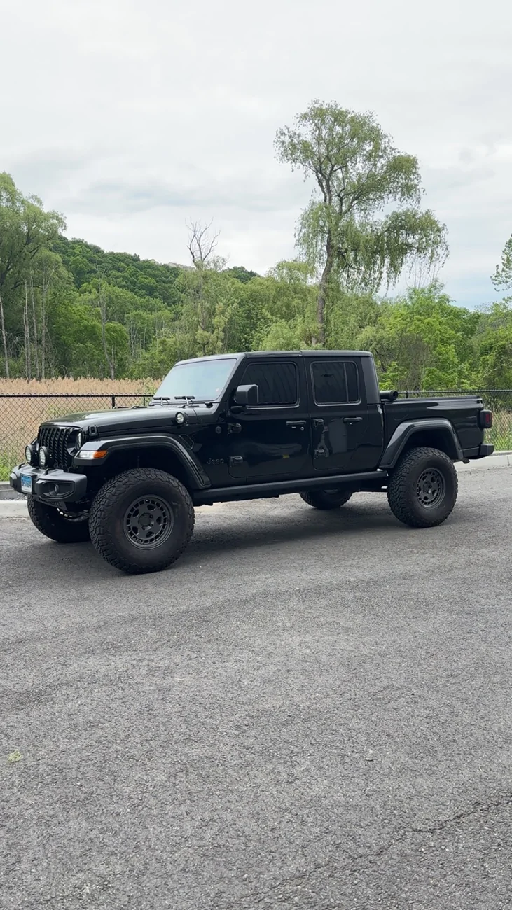

heres a picture of it for funsies
Jeep Gladiator Another Death wobble conflicting info Clayton lift IMG_5040

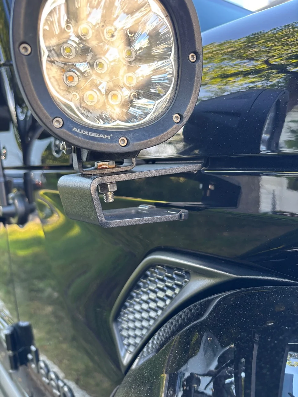

Off Topic: Nice looking Truck!!!! Can you take a closer picture of that spotlight and the mount for it? I haven’t seen that position for lighting before.

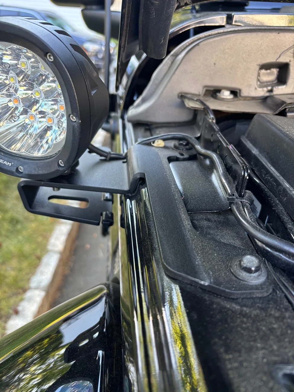

Thank you! Sure thing! The mounts are called side shooters by Maximus-3. Originally I could only find them on Tyri’s website but I see extreme terrain sells them, same price.
highly recommend them, very stout, no vibrations. Perfect spot to aim to the side and not be too buggy or “same” looking as others.
https://tyrioffroad.com/collections/brackets/products/side-shooter-brackets-jeep-jl-jt
