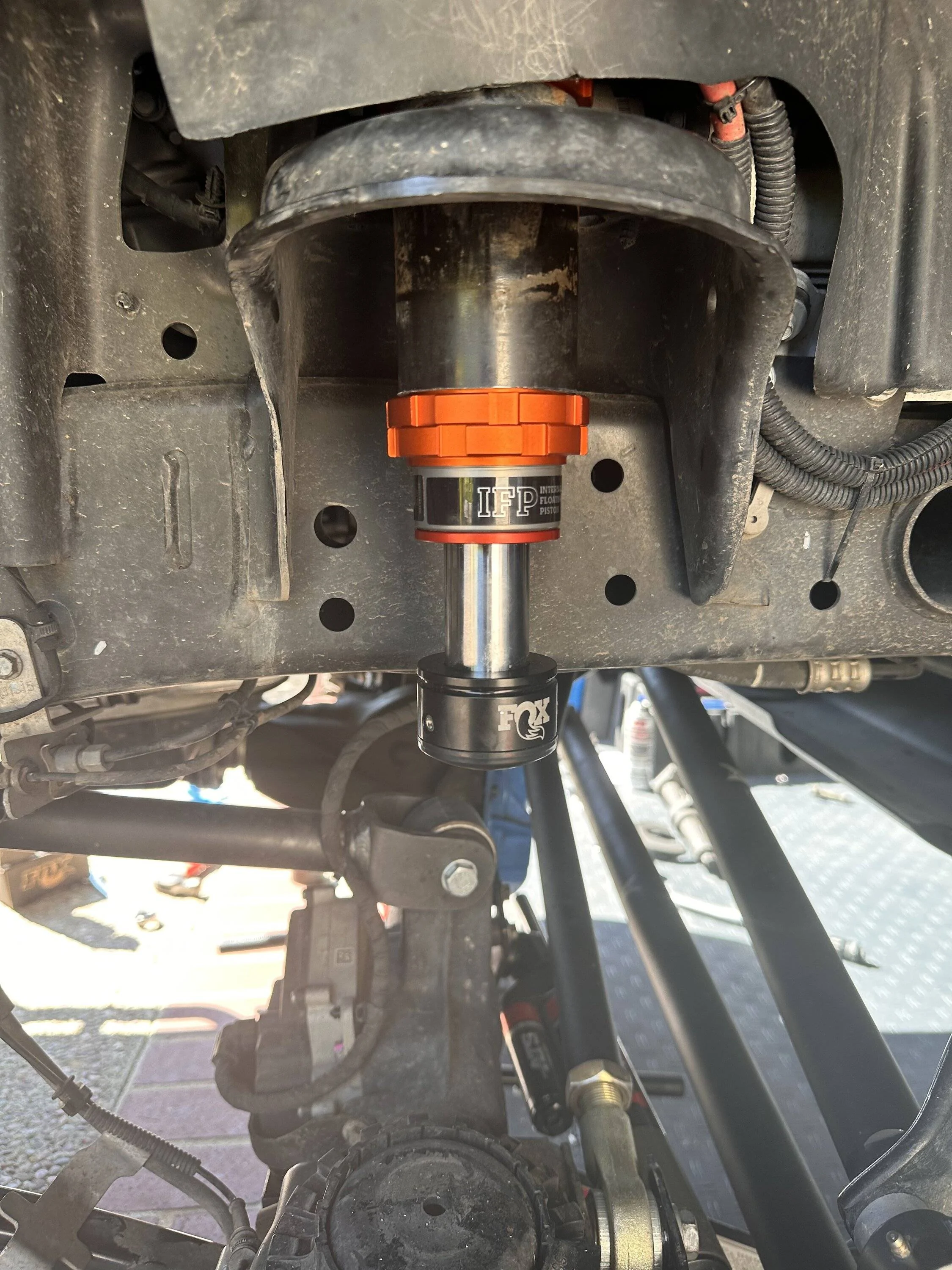

I’ve been digging around but cannot find a definitive answer. I have a rubicon and want to swap my bump stops to the Mojave hydraulic ones. Is it a simple bolt on or is welding/fab work involved??

I can’t be certain, but the front bump stops on the Mojave seem to have three bolts that go through the cup. IMO, the Fox Race Series bump stops will be easier to install - I just did them on my Overland. You just chop off part of existing bump stop mount/cylinder and they lock in with a triple nut setup.
The rears require welding (along with measure 3 times, cut once).
