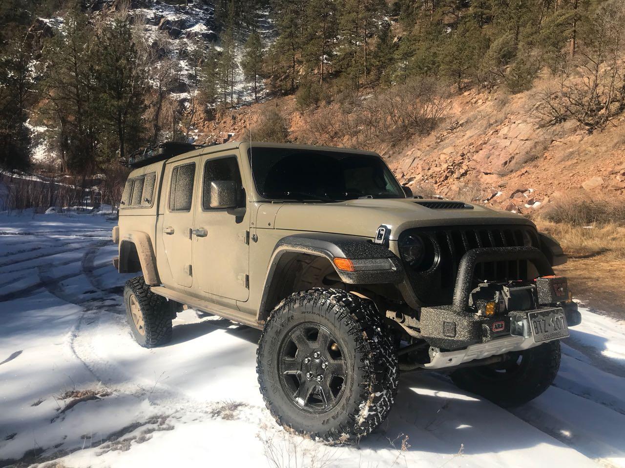

I really thought I was cutting no corners on this build. Anyway, thought I'd trow in a few pics of the build

Wow! Very nice build. I especially like that color matched bed topper.
Both of your ideas would work.

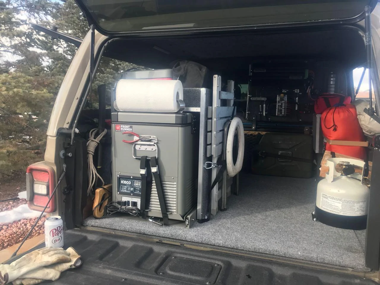

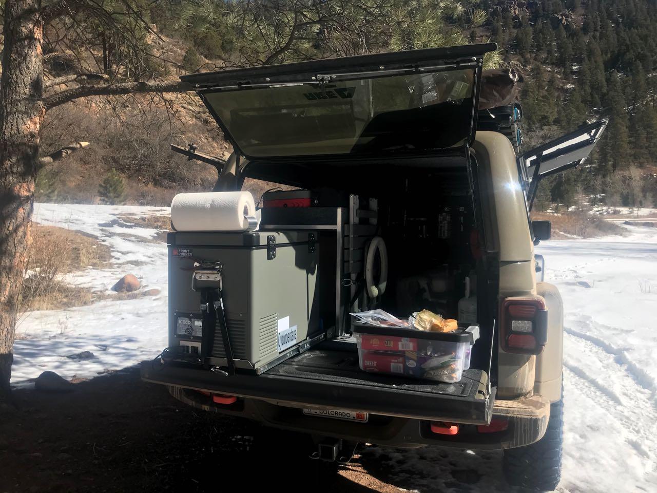

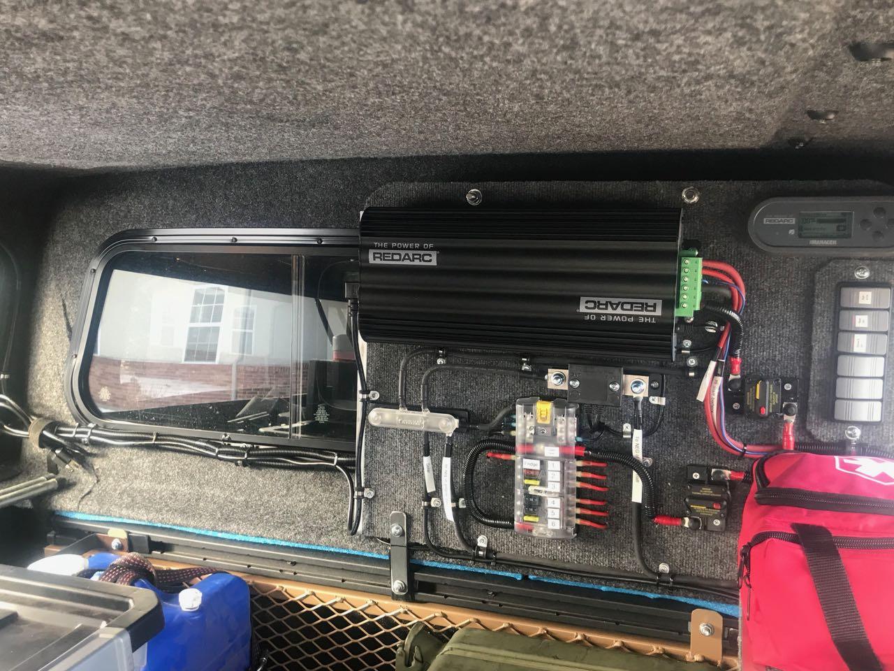

Thanks. The Canopy and REDARC 30 w/Solar is amazing. I can park indefinitely and always come back to the truck and grab a cold beverage or snack of choice from the fridge.
