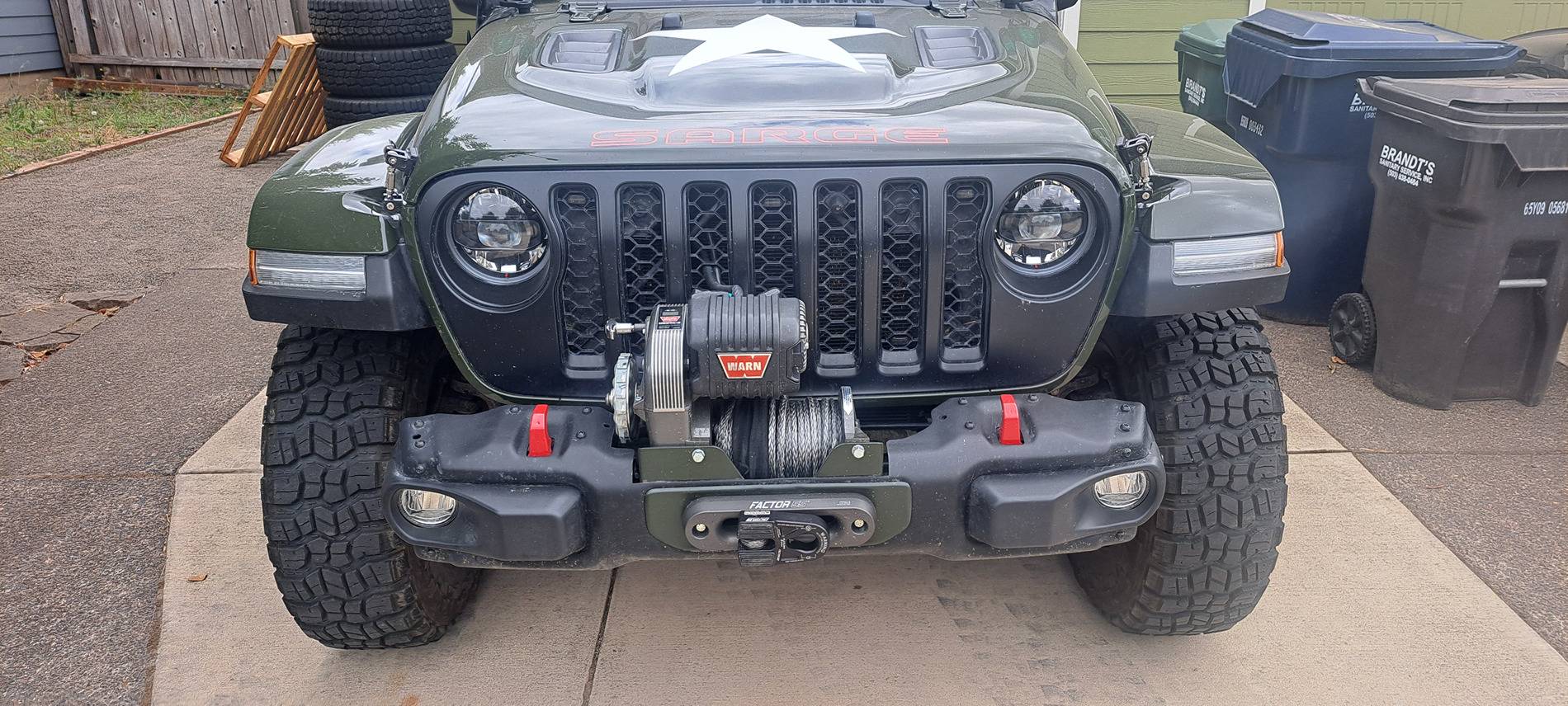

Have Clayton 2.5 Overland with Falcon piggyback shocks inbound. The kit comes with new front/rear bump stops. I know some folks upgrade to other options, Sumo springs, hydro, etc. Is that something I need to do as well? Running stock steel Rubicon bumper with Apex 12k winch. Will go with 37’s. No plans on changing out my front bumper. Clayton website says…
“The front bump stops are 3 ¼” tall made from UHMW and can be cut to customize up travel. Rear bump stops are 3” tall steel spacers, and come pre-drilled for optional bolt-on spacers for those of you looking to customize your rear up travel.” I truly don’t know what to do with that information!LOL. Help a brother out.

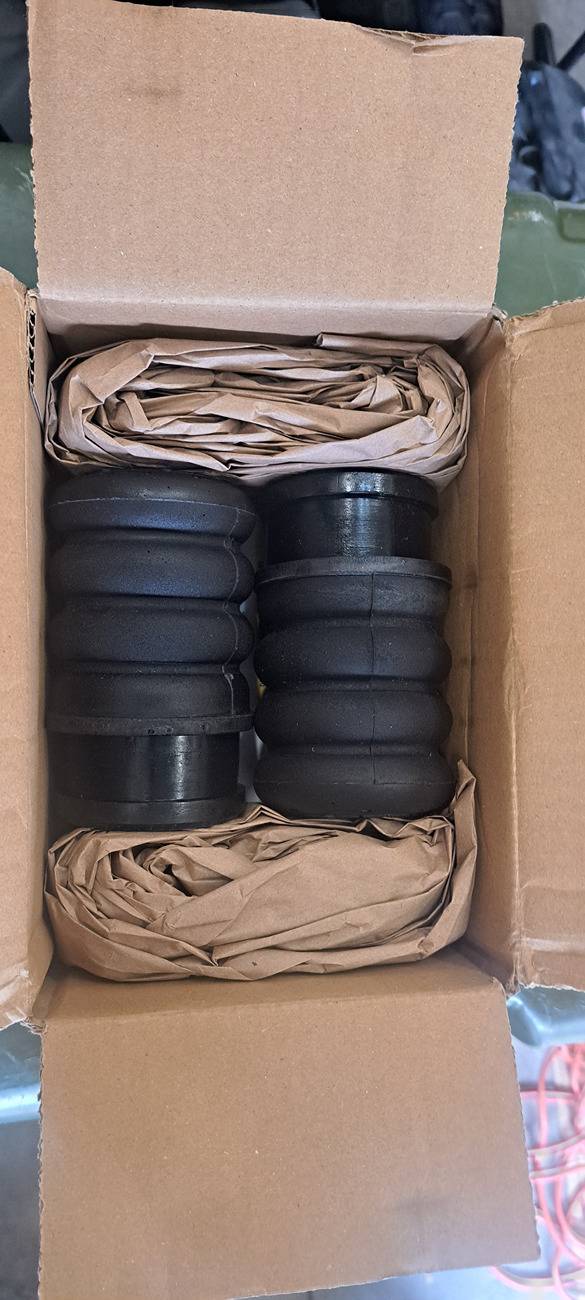

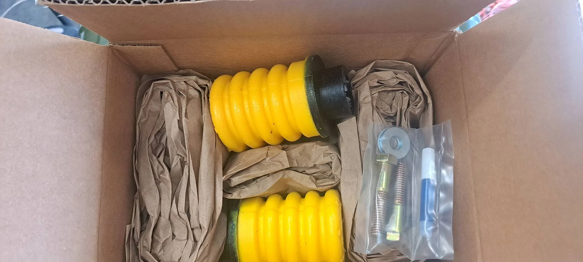

Because the gladiators are front end heavy, and I'm old school with the 8274 winch,
I went with the sumo springs front and rear, love them.
